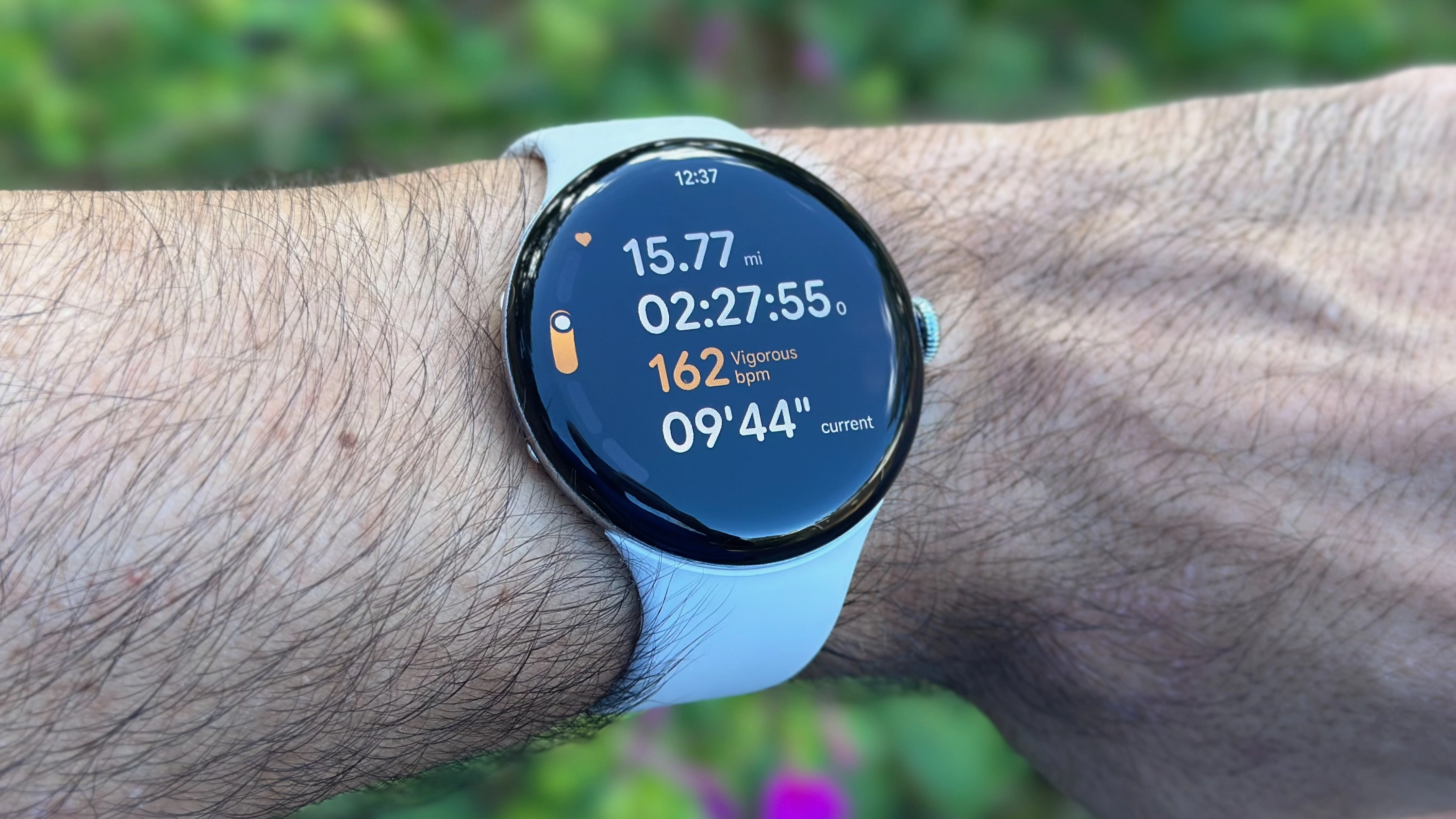

The Pixel Watch 4 is Google's sportiest smartwatch yet. As someone who's tested nearly every smartwatch and fitness watch brand, I put the Watch 4 through its paces to see how well its accuracy holds up against a premium Garmin watch, judging when Fitbit beats the competition and when it falls short.
I took the Pixel Watch 4 out for a half-marathon and a second 19-mile run — along with shorter runs and a hike — comparing its HR accuracy against a chest strap and its GPS accuracy against the dual-band Garmin Forerunner 970.
I also compared stats like step count, elevation, and running form, tested how Google's new activity detection works, and decided whether the Watch 4's new 3,000-nit display and improved battery life make a real difference.
I can't fully judge the Watch 4 fitness experience until the Gemini-backed Fitbit coach arrives later this month. But it's fair to say the Watch 4 is a surprisingly strong fitness watch option — even if it's still missing some essentials that serious athletes need.

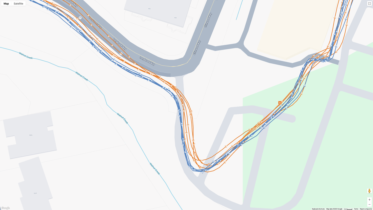

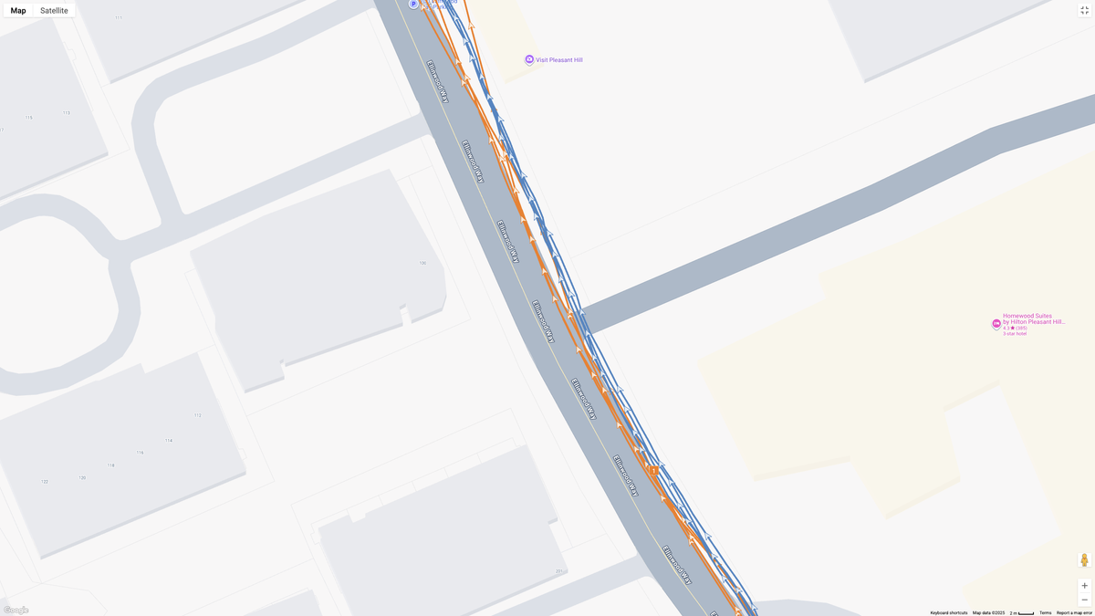

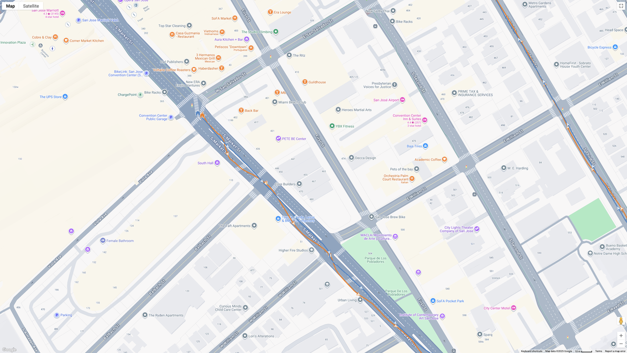

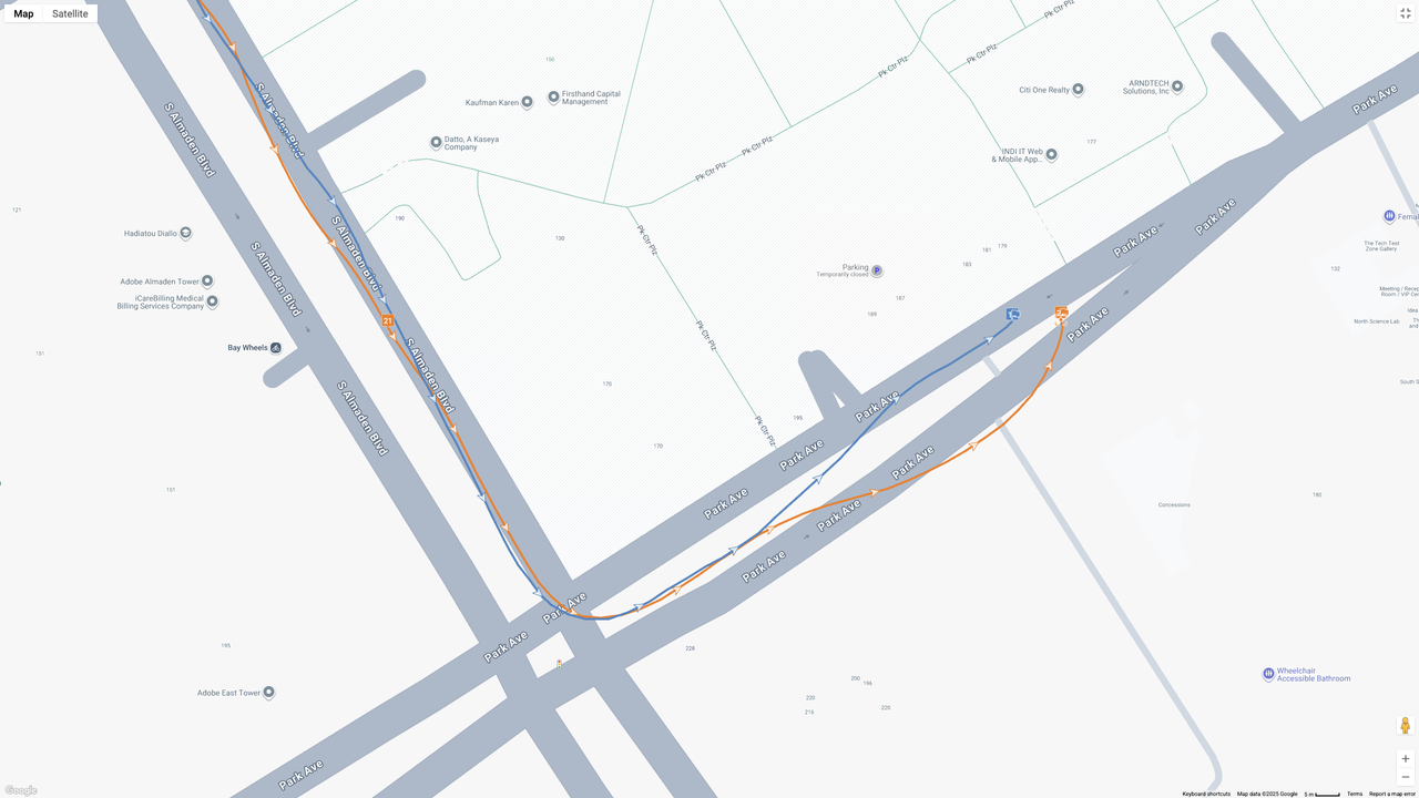

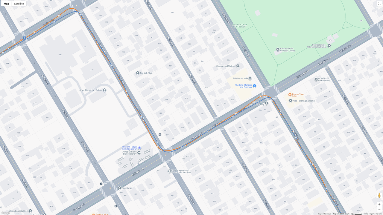

Anyone who read my Pixel Watch 4 hands-on impressions saw my initial GPS and HR accuracy results, but I'll go into more depth here. The Pixel Watch 4 defaults to dual-frequency GPS, but also manages to be incredibly efficient at it. Google hasn't shared its methods, but I'd guess it's similar to Garmin's SatIQ mode, pinpointing with L5 signals when the L1 signal is disrupted.

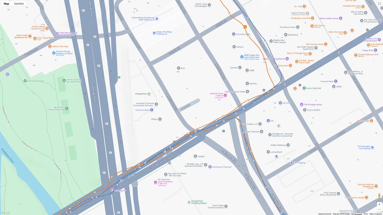

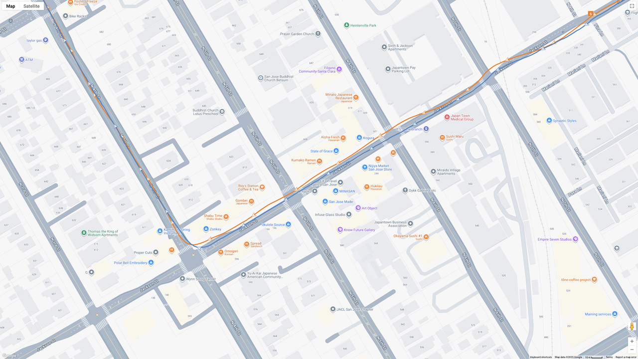

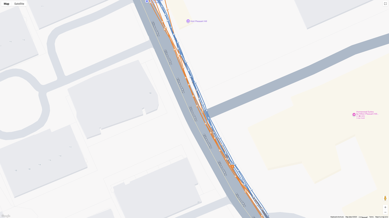

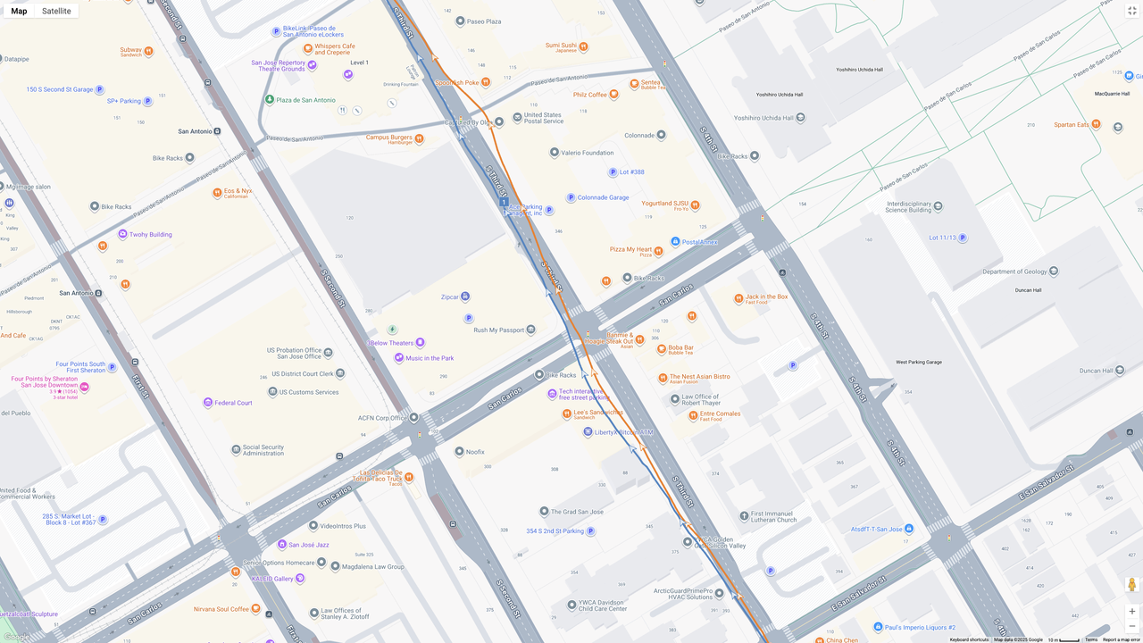

During a half-marathon race in downtown San Jose, the Pixel Watch 4 showed mile-long stretches with very accurate tracking, with the two watches' results closely overlapping. But it wasn't perfect, as some of the slides below show (click the box for a closer view):

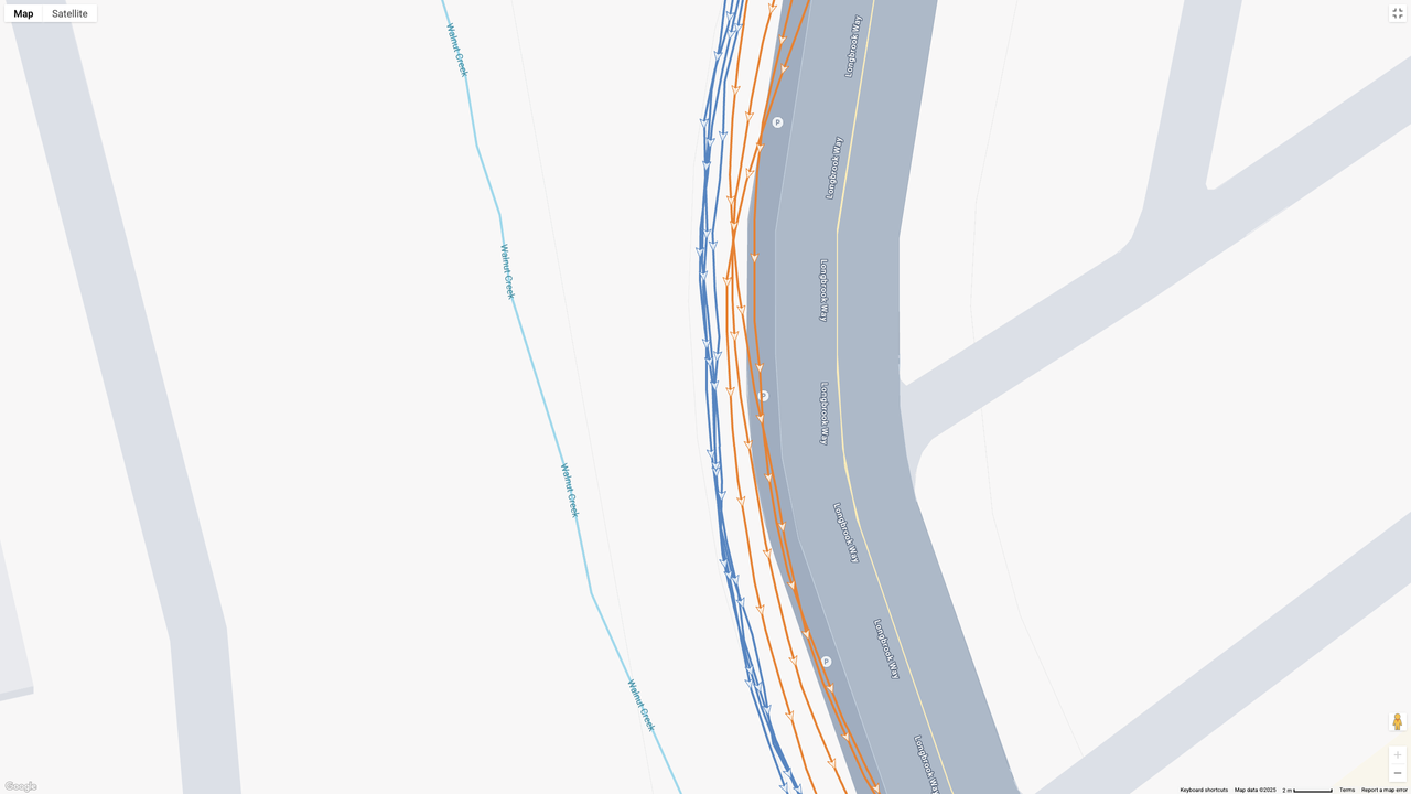

I also noted plenty of moments where the Watch 4's GPS line curved significantly off of my route before returning, possibly due to reflected signals from tall buildings. More subtly, the Watch 4 is slower to react to any 90-degree turn, with a much wider loop than I actually took. And it didn't do the best at staying straight under underpasses.
Despite its struggles, the end result wasn't far from Garmin's, which had its own occasional struggles with tall buildings but was more faithfully on track.

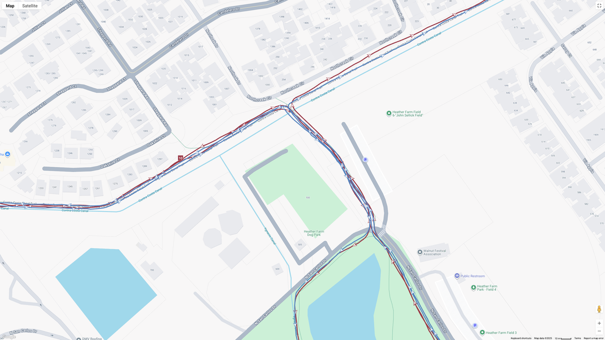

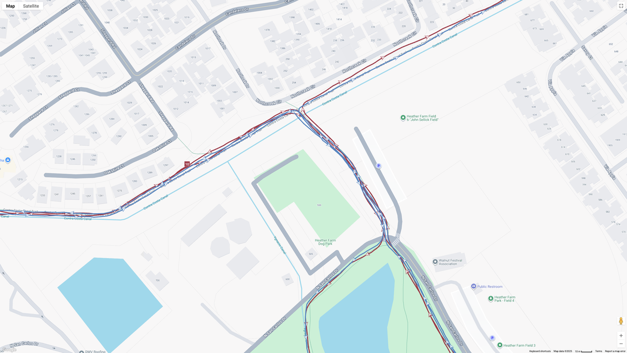

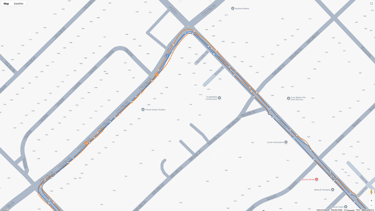

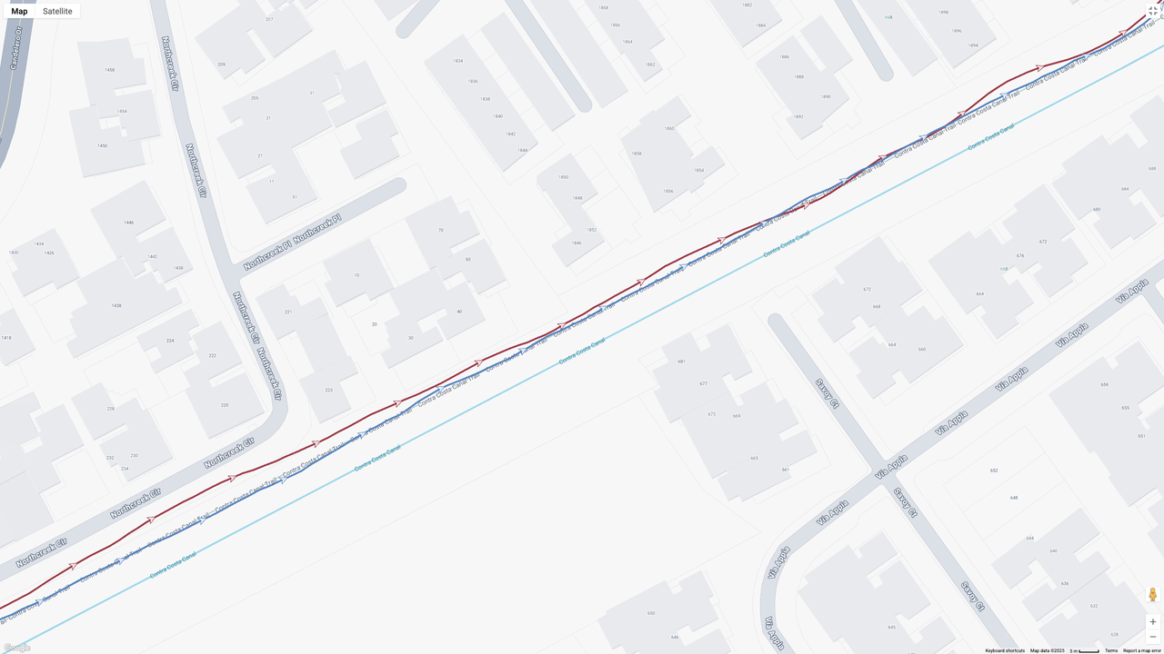

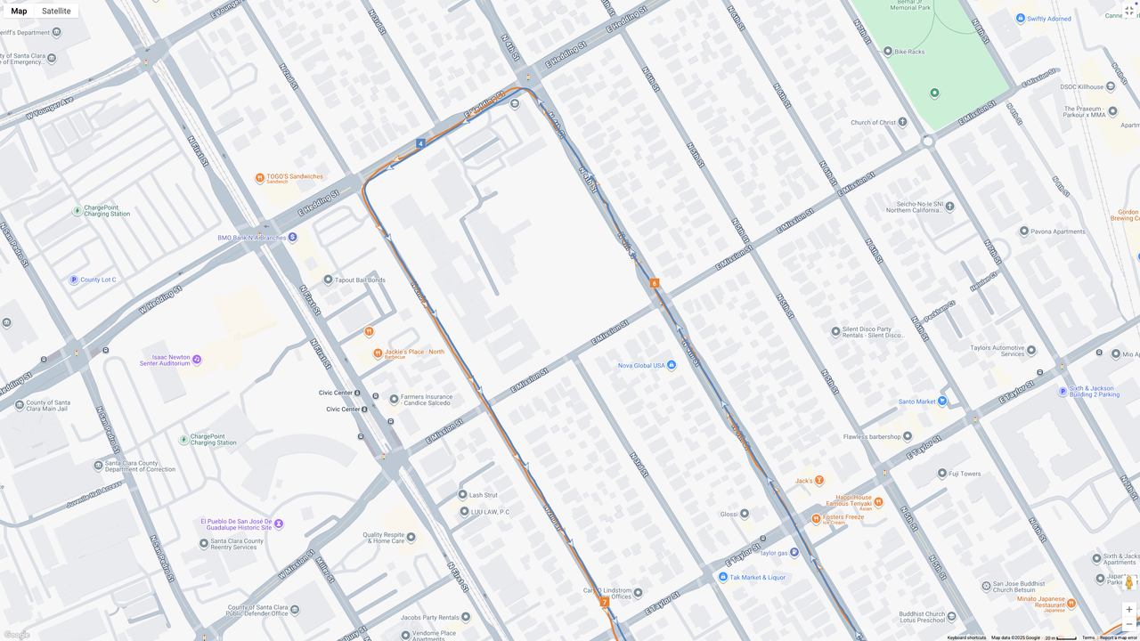

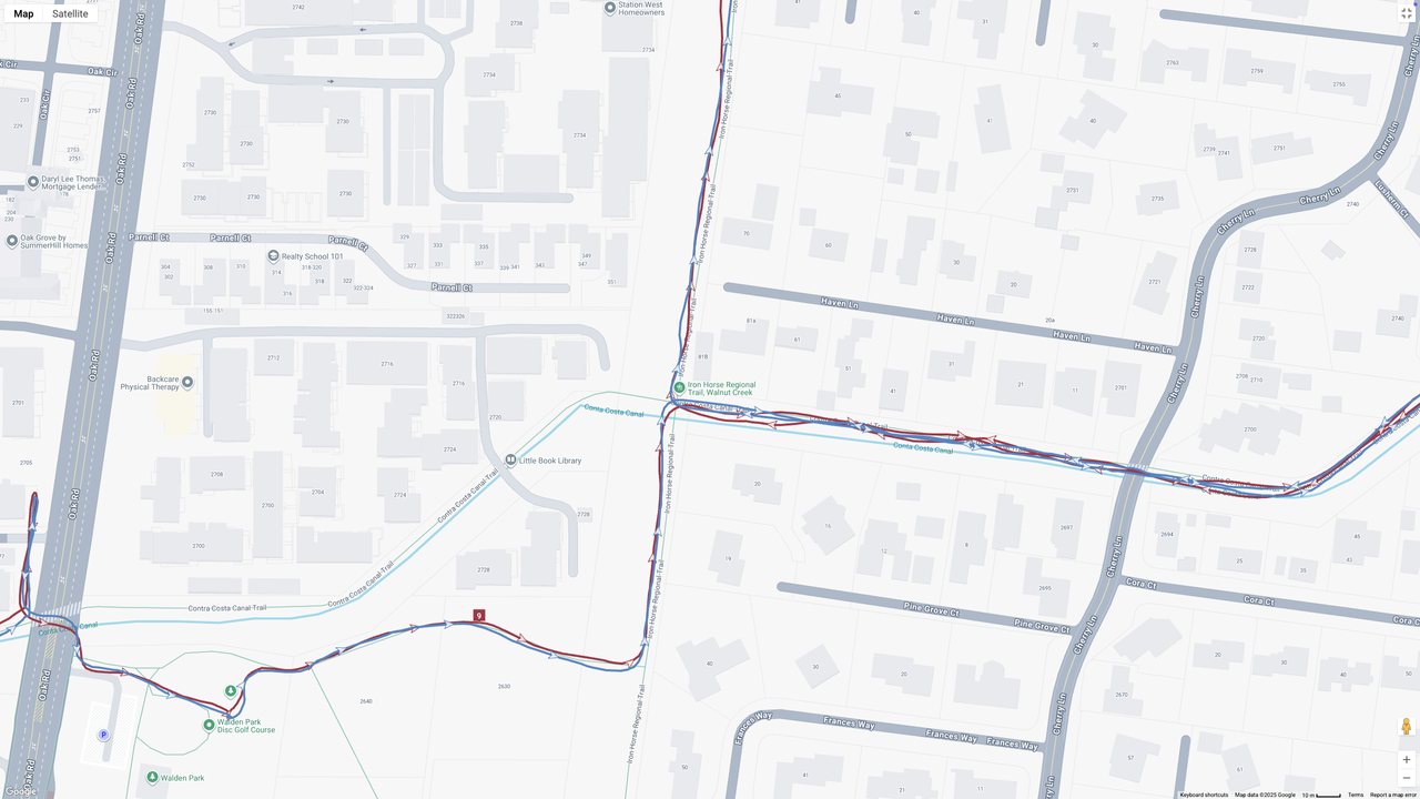

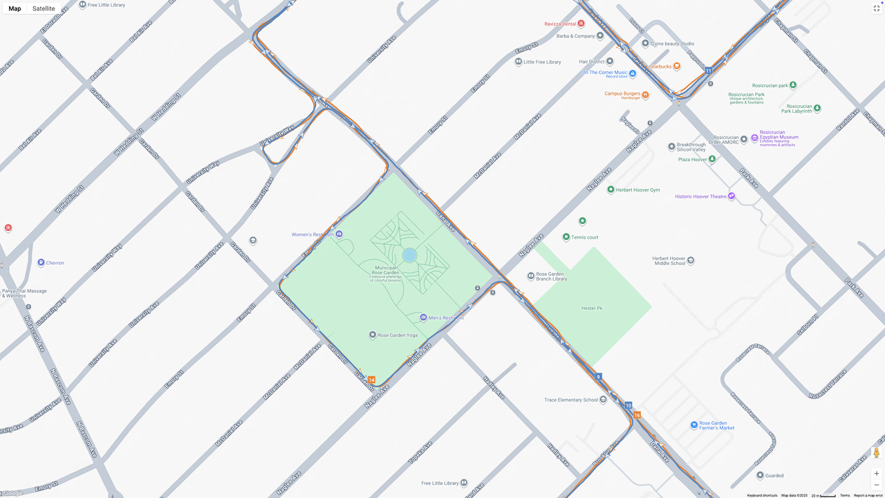

For my next test, I ran several miles on the same neighborhood loop. Google and Garmin stay parallel — likely because they're on my left and right wrists — but it's fair to say that Garmin's results stay more consistently on the same line, while Google's line strays much more, despite there being few signal blockers nearby aside from some trees.
Again, though, the final result was 5.00 vs. 5.01 miles (16m), and you'd be surprised how many dual-band GPS watches stray slightly off track. The Pixel Watch 3 tended to be significantly worse, particularly for hikes.

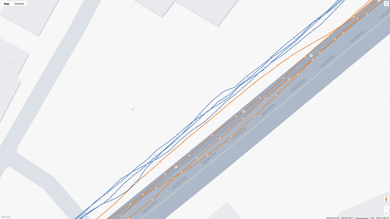

I recently ran 19 miles with the same two watches, plus a third dual-band COROS watch. The final result: Garmin measured 0.02mi more and COROS 0.01mi more than Google, all with the same 9:23/mile average. I'll spare you 19 miles' worth of screenshots, but this was the Watch 4's best tracking result, with only the occasional sections where it strayed off-path.
On a related note, the Pixel Watch 4's elevation tracking was only 0.8 feet off of Garmin's for the 19-mile run, though the gap was 3m for my half-marathon. I didn't get a chance to climb a mountain or anything, but I generally trust its results.
Overall, the Pixel Watch 4's GPS accuracy is as dependable as I hoped. It's also more efficient than I expected, only using about 7.5% of my battery per hour of tracking for a couple of runs. It guzzled more battery during my 19-mile run, hitting closer to 12% battery used per hour, but still had more than enough juice for a long activity.
