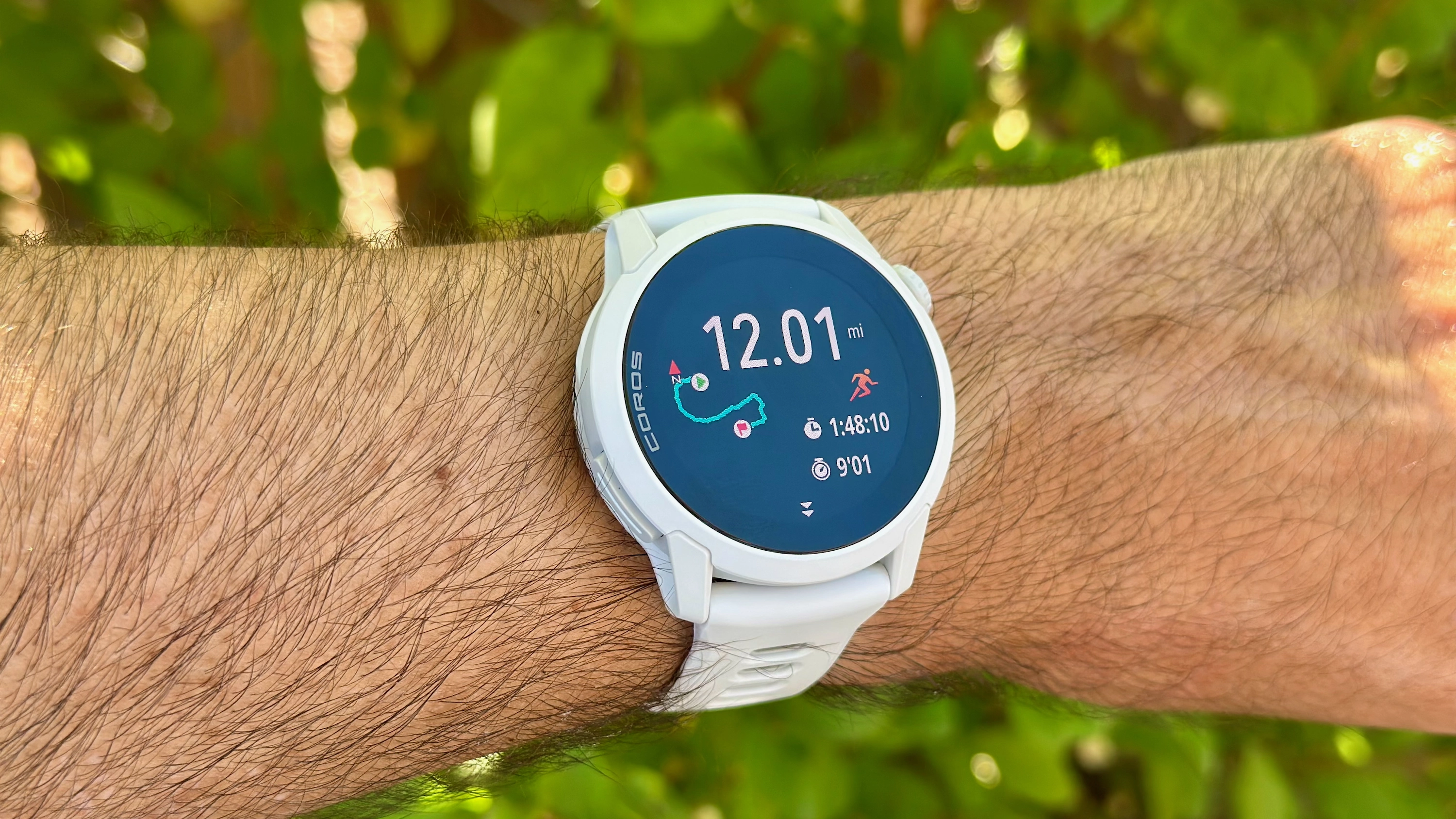

A photo of the COROS PACE 4 on a wrist showing the lap data screen, with current lap pace, elevation gain, HR, total distance, and duration visible.

As for current PACE 2 or 3 owners, you'll appreciate that the PACE 4 feels just as feathery-light as ever; I wore it on 12- and 8-mile runs, and its presence faded from my mind once I got into the zone. Plus, the price has only inflated by $50 across three generations and four years, and COROS's dependable post-launch support means the PACE 4 should receive feature updates for years.

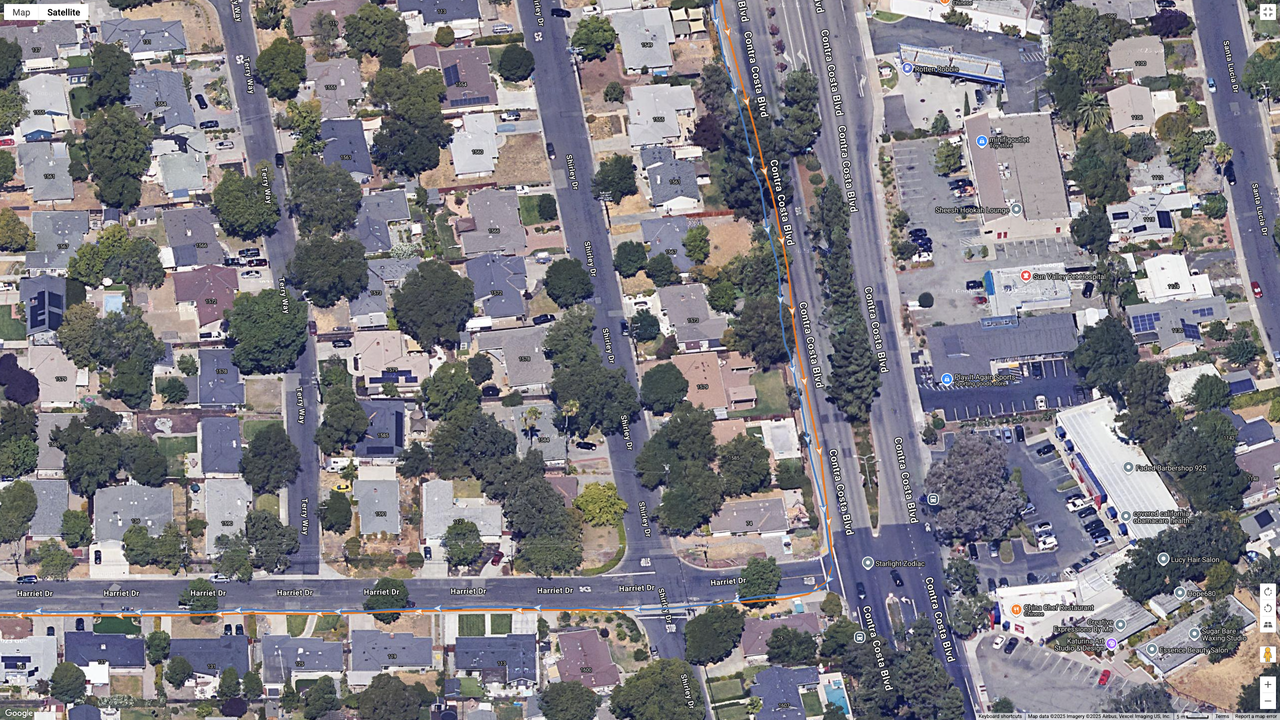

As for dual-frequency GPS tracking, the PACE 4 measured 24m and 60m less, respectively, than my Forerunner 970 after 8 and 12 miles. Again, that's close enough to satisfy any runner buying a $250 watch, especially compared to a $750 flagship. But let's look at the actual map to see if the PACE 4 earns that total or lucks into it.

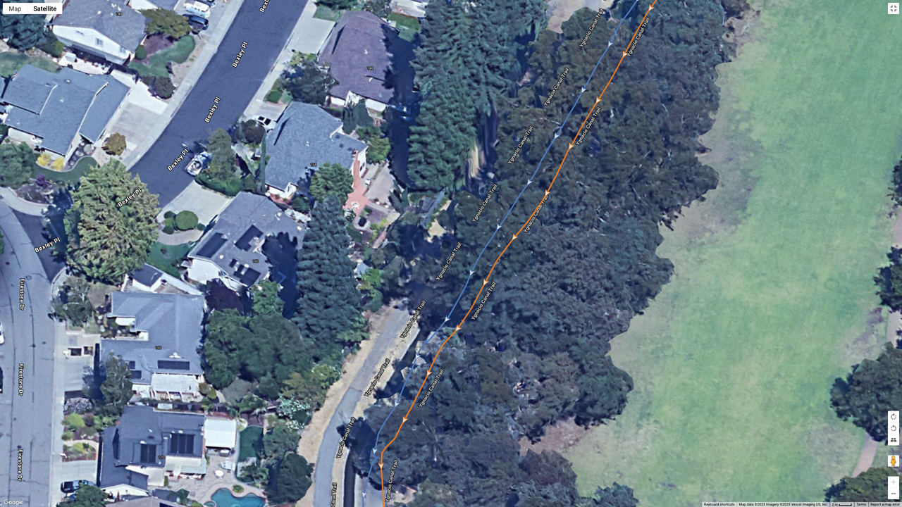

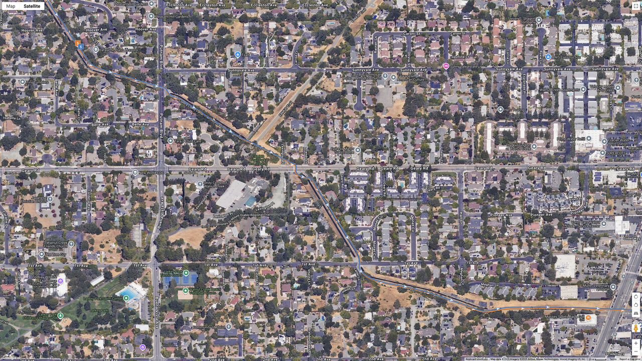

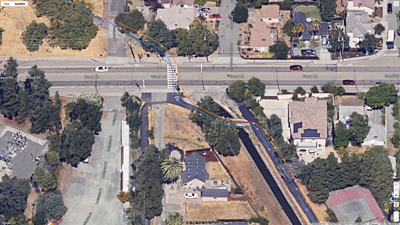

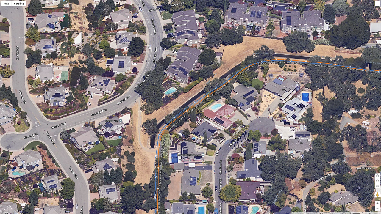

Generally, the PACE 4 (orange) stays in parallel to the Forerunner 970 (blue), with more of a tendency to drift a meter or two off of my real path, either into the street or on the opposite side of the path. These tend to balance out on a normal winding path, however, and the PACE 4's dual-frequency pinpointing means it isn't badly affected by foliage.

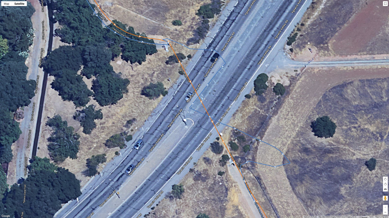

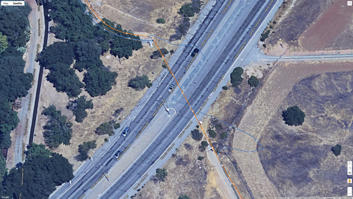

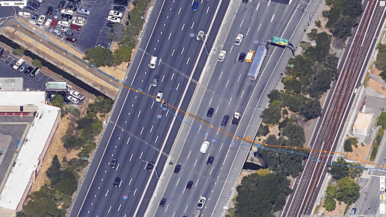

In fact, COROS and Garmin measured their mile markers in near-unison for the first nine miles. The discrepancy came from Garmin's signal freaking out while I ran through an underpass tunnel, sending me flying in various directions. The PACE 4 gave me a signal-reacquired notification when I exited the tunnel and (correctly) estimated that I'd run in a straight line.

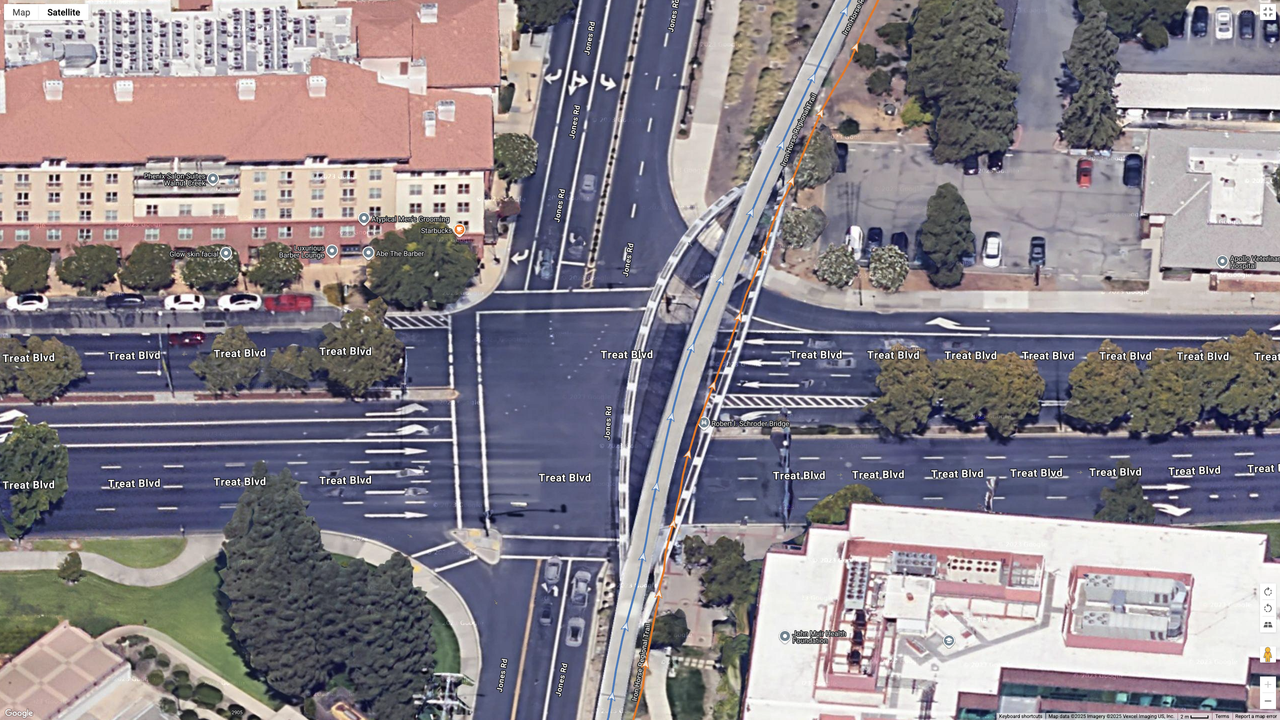

The second run — another relatively easy suburban route — was more of the same, with the PACE 4 (blue line this time) always measuring me in the ballpark of where it should. It had a little more trouble with underpasses on this run but kept the signal reflection to a minimum, and it did better than Garmin at tracking my path on a narrow bridge.
I'll put the PACE 4 through stricter conditions when I have time, but COROS gave it the same quality of GPS tracking as the pricier NOMAD and APEX 4, and both of those watches did well in tougher conditions.
