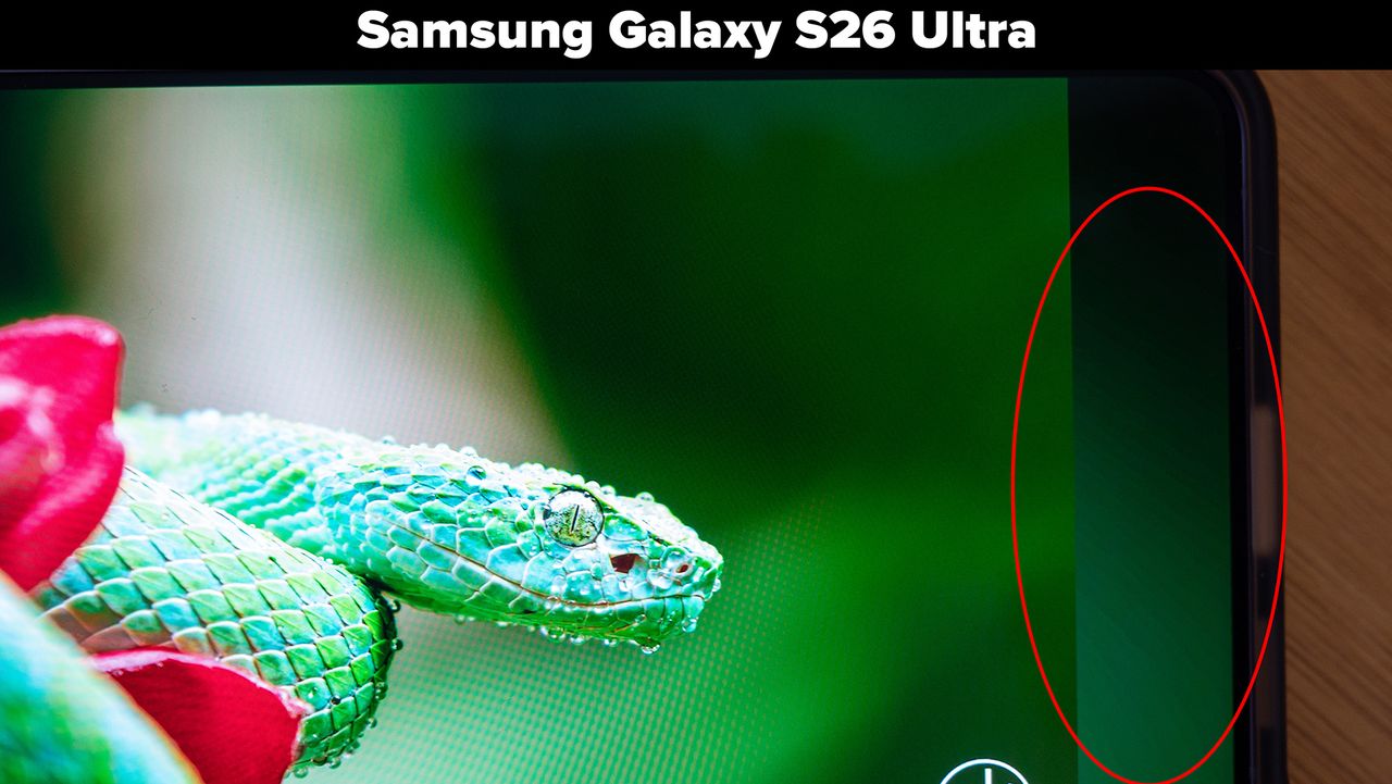

One of my most common tests involves watching this 4K HDR YouTube video about wildlife in Costa Rica. The green snake scene at the 8-second mark is the perfect showcase of whether a phone is capable of 10-bit color reproduction. In the image above, you'll see clear color banding on the Galaxy S25 Ultra's display, while it's not visible at all on the Galaxy S26 Ultra. Color banding is a stark separation of colors that appears when a display isn't capable of showing all the colors in a gradient.
Since Galaxy S26 Ultra's display is still an 8-bit display, as the Galaxy S25 Ultra's is, this means that Samsung adopted some sort of dithering to make the color shift appear smoother. Typically, this means using FRC, which looks like this excellent quick explainer video from Wikipedia. However, that's not what's happening on the Galaxy S26 Ultra's display.

While viewing the video above, you can see the pixels "dancing" during the two examples, showing what dithering typically looks like on an LCD and an OLED. When looking at the gradients under a microscope on the Galaxy 26 Ultra's screen, I don't see any pixel flashing or movement, which is exactly how it should be.
