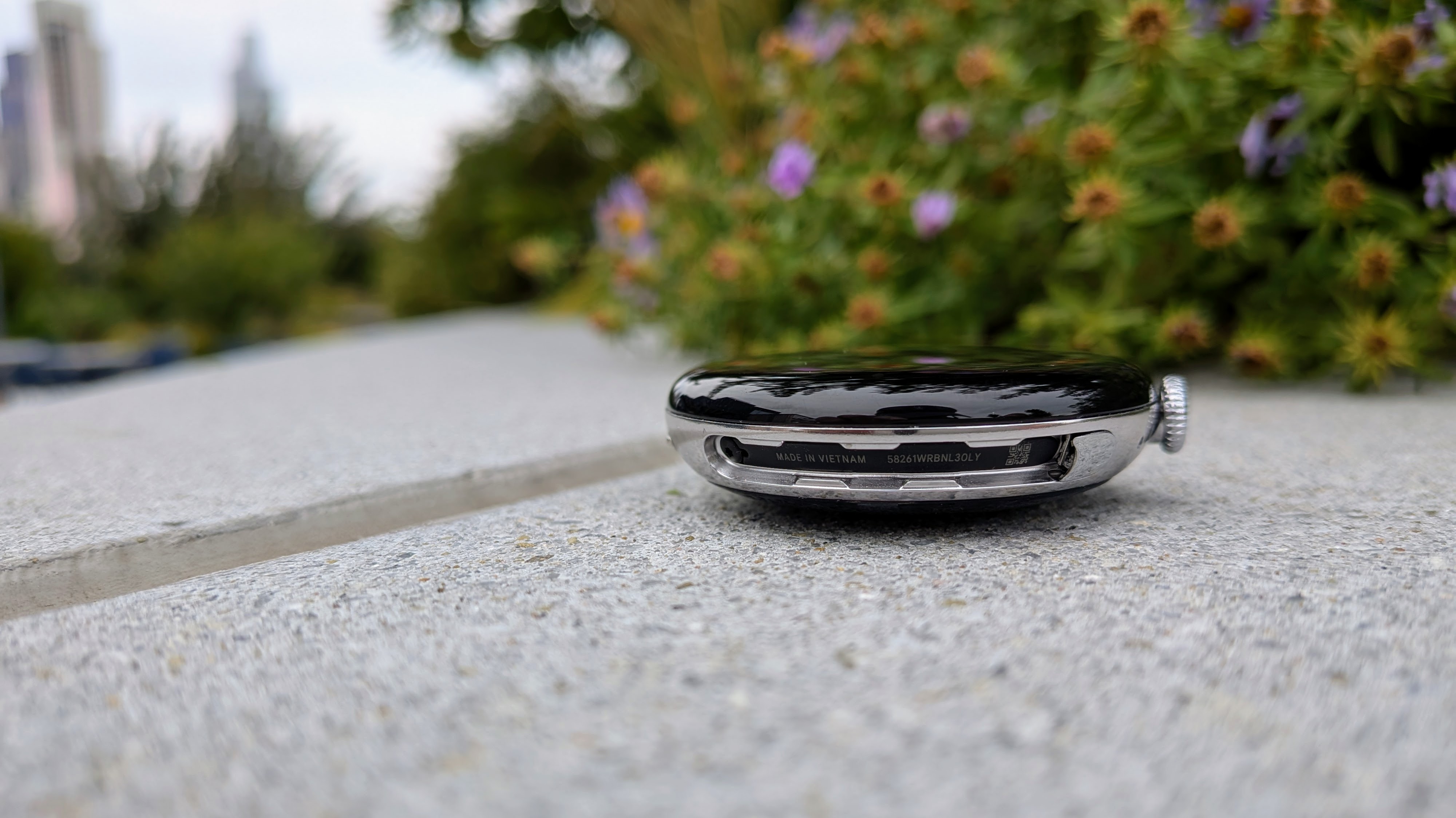

The teardown reveals design decisions that prioritize access over obfuscation: two Torx T2 screws under the band let you pop open the case without ripping through adhesives. The battery and display themselves are secured with screws (T2 and some T5s) instead of glue.
Reassembly still retains the watch’s IP68 / 5ATM water resistance thanks to a silicone O-ring seal. Of course, this more open approach comes with some caveats. The repairability offered applies primarily to the battery and display.
Also, to facilitate easier opening, Google appears to have changed the charging method. The Pixel Watch 4 comes with a side-charging cradle rather than the old magnetic or pogo-pin style used in prior models.
That means older chargers won’t work, and there’s concern this is just another proprietary twist. Still, the side-charging layout might help by giving repair technicians unobstructed rear access.
