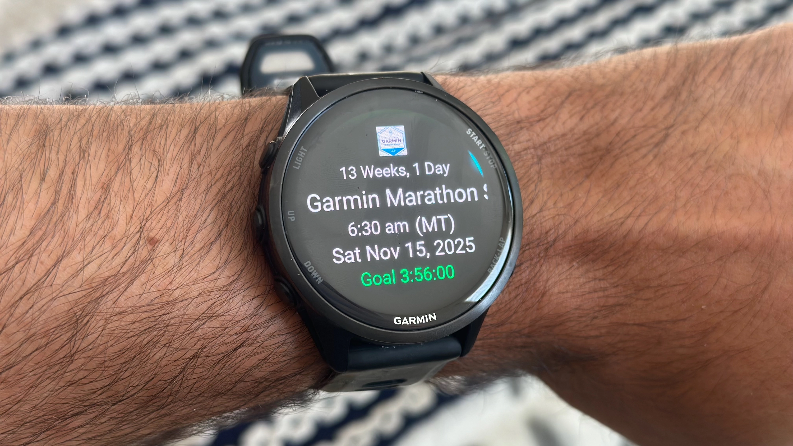

The Garmin Forerunner 970 on the author's wrist, showing the Primary Race widget with the Garmin Tucson Marathon time, date, weeks until the event, and goal time.

Many running watches offer marathon training plans. Now that I'm signed up for the Garmin Tucson marathon in November, just three months out, I have to decide quickly which plan to try. Should I trust a smartwatch algorithm to give me a personalized marathon training plan, or use a running coach plan from TrainingPeaks?
It's been a few years since I last ran a marathon. When Garmin offered a media invite to run in its first Garmin Marathon series, I knew I'd have to ramp up my mileage quickly, but intelligently, so I don't overtrain and crash out.
I've reviewed pretty much every running watch under the sun, but whether I use my Garmin Forerunner 970 or another device, my success or failure will depend on the workout plan, more than the hardware.
