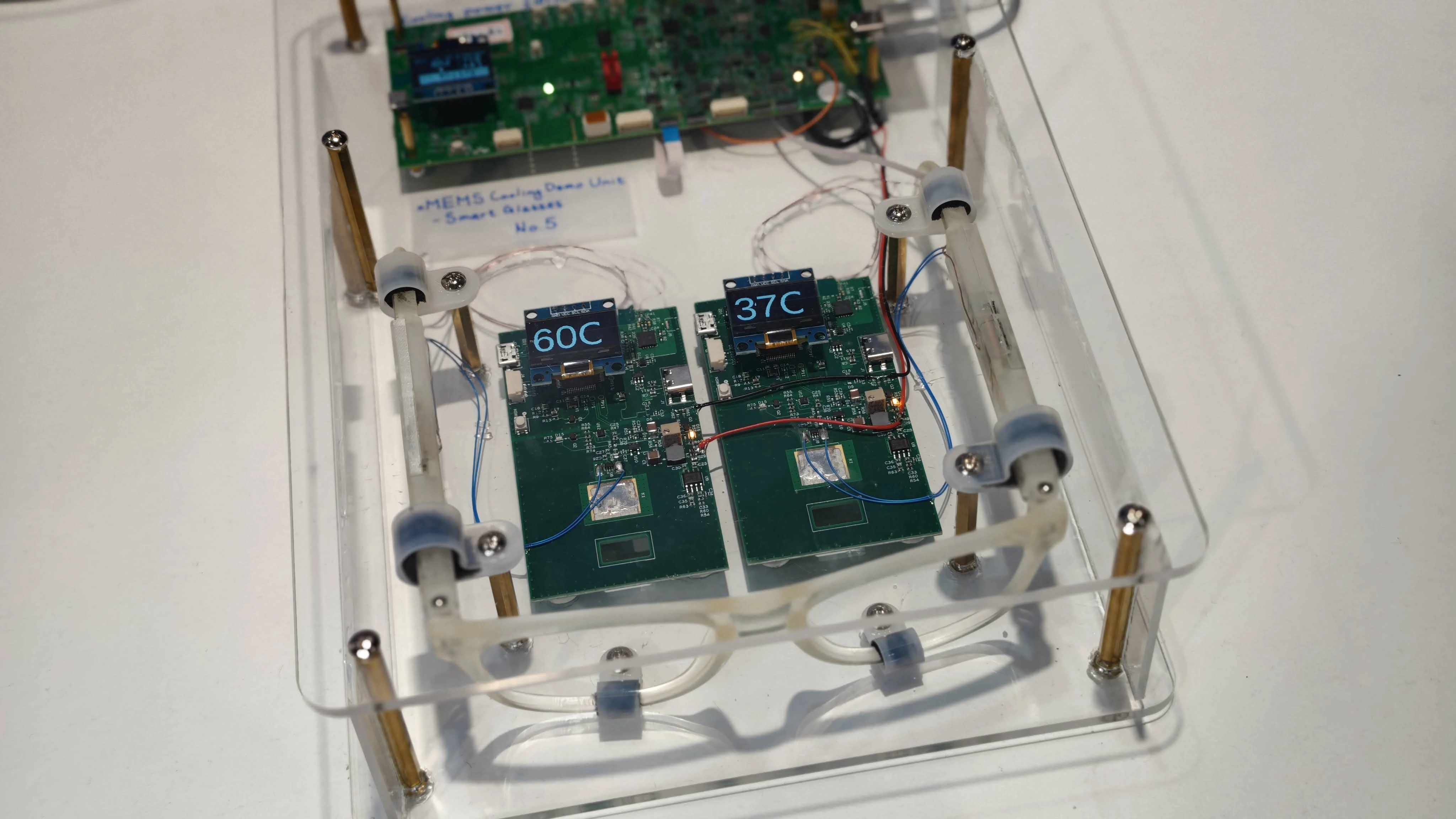

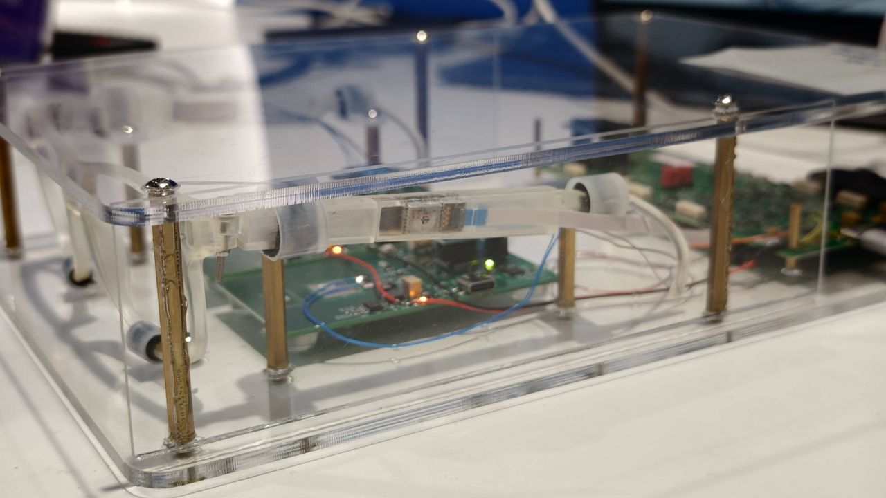

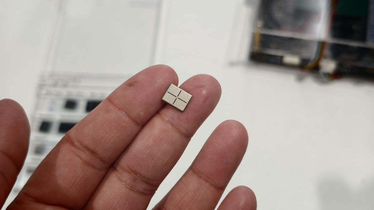

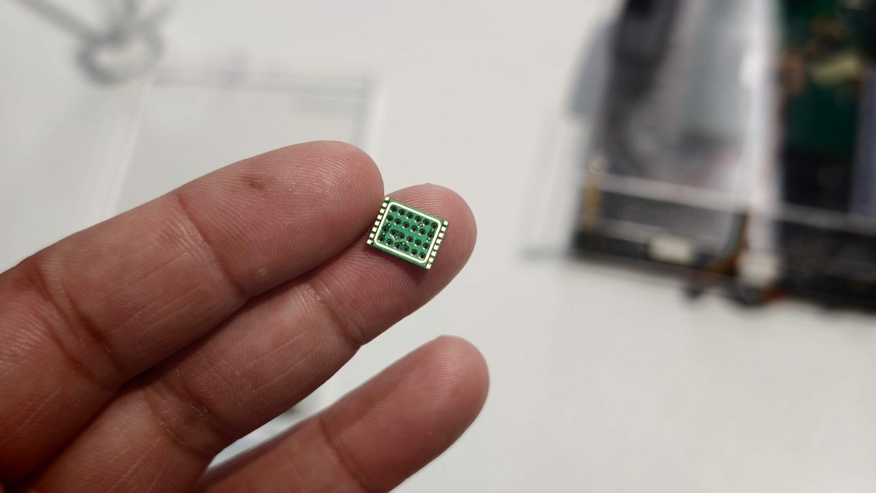

The brand showed off the XMC-2400, an active cooling solution that puts out enough airflow to move a traditional fan at 35 cubic centimeters per second. The product is designed to be used in wearables, and it has inherent advantages over traditional cooling systems: as it's made entirely out of silicon, it is significantly thinner at just 1mm, and it's highly efficient — it just needs 30mW of power.
The best part is that it's IP58 dust and water resistant, so wearable makers can easily integrate in their products without any issues; if anything, this is one of the biggest reasons why we don't see any actively cooled products in this category. In the demo, xMEMS fitted the XMC-2400 to one side of a pair of 3D-printed smart glasses drawing 1W of power, and activating the cooling solution showed how it was easily able to bring down the thermals by over 20 degrees Celsius in just a minute.
