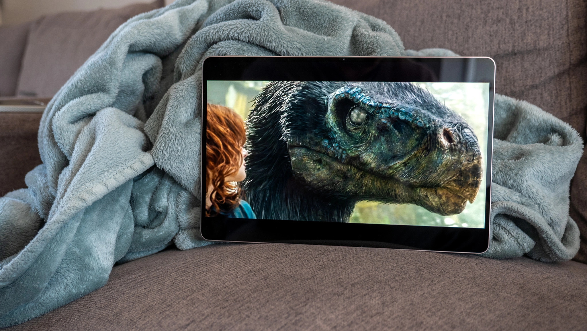

Jurassic World Rebirth running on the Honor MagicPad 4
