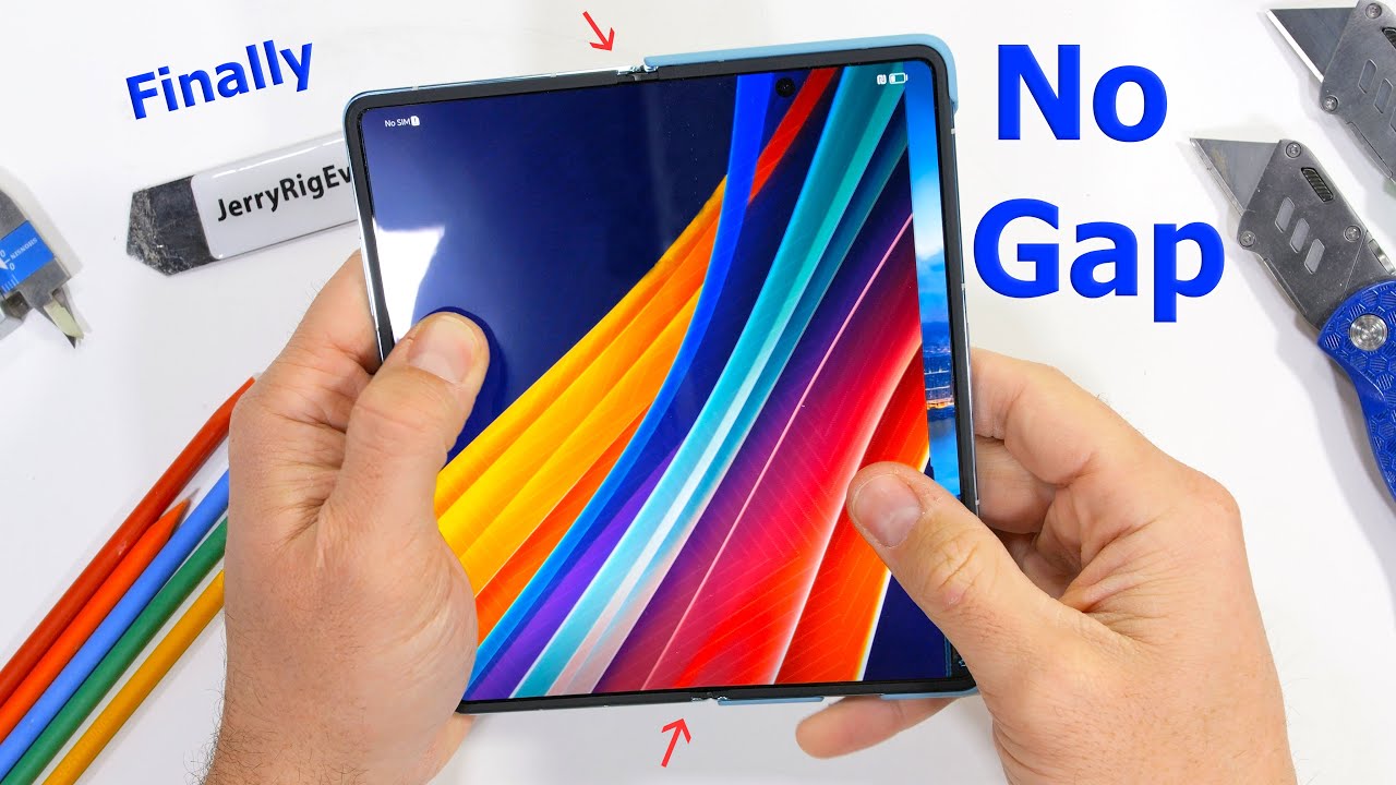

  • YouTuber JerryRigEverything showcases the new hinge mechanism in the latest teardown video.
  • The new mechanism uses very few components and is 62% lighter.

One of the primary takeaways of the Magic Vs is its hinge design, which Honor proudly claims to be groundbreaking. According to Honor, it translates to a lightweight, gearless hinge design made through a single-piece casting process technology. It also claims to reduce the number of components to four from 92 while maintaining durability and sturdiness. This is unlike Samsung's Galaxy Fold 4 or Fold 3's hinge design, which involves a lot of tiny gears to move the hinge effortlessly.
The new hinge design reduces the number of components used. It allows the foldable screen to fold entirely flat, which its competitors, like Galaxy foldables, have yet to be able to accomplish.
In his latest teardown video, Jerry opens up the Honor Magic Vs, a pre-production unit he received from Honor ahead of the international debut. He further shows and explains how Honor has been able to achieve the gearless design with the new hinge.
The foldable device is believed to fold easily since the hinge joined the metal components with black aerospace-grade plastic rather than using gears equipped with 92 separate structural components. This makes the hinge 62% lighter than the predecessor model. This casting has apparently reduced the small pieces that help in folding the device to four main components, which the casting structure holds through springs, like a suspension system seen in vehicles.
