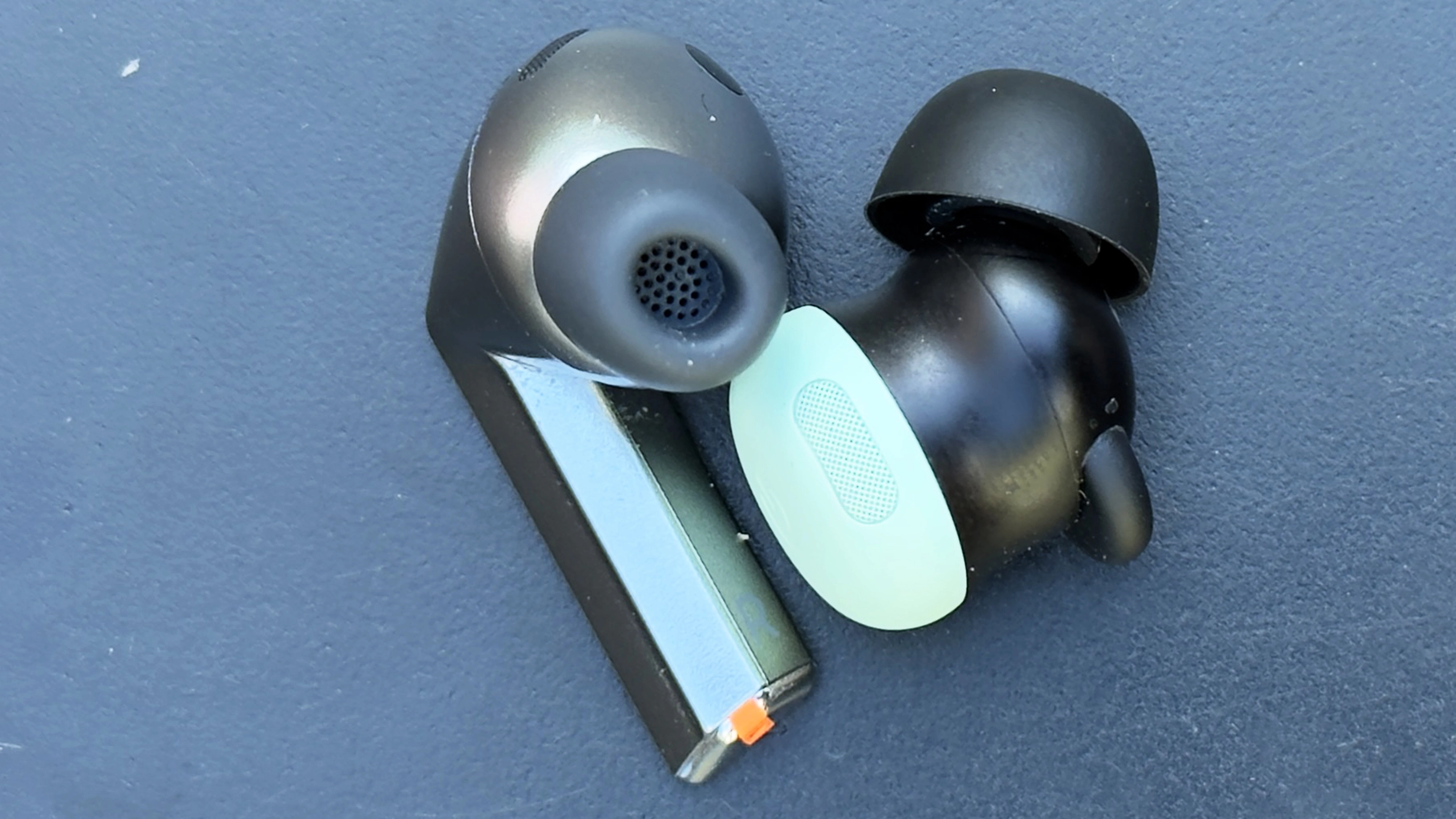

Pixel Buds Pro 2 vs Galaxy Buds 3 Pro
(Image credit: Tshaka Armstrong)
