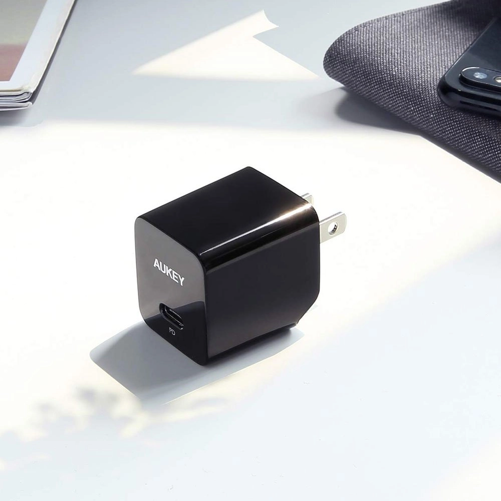

Aukey USB-C Charger with 18W Power Delivery 3.0
This is a truly portable Power Delivery charger. It's not as not as powerful as the Anker, but it's more than adequate to quickly charge a phone during a lunch date or an afternoon nap.
Perfect for phones

I'm going to be as blunt here as I can: these chargers are almost the same dimensions with the same sturdy plastic construction and a single USB-C port on the front. The Anker is a tiny bit bigger and the Aukey has folding AC prongs on the back, but otherwise they're pretty similar apart from the fact that the Anker is fast enough to charge laptops and the Aukey isn't.

Total output isn't the end-all be-all of chargers, but I plugged the Aukey charger into three different Chromebooks and it wouldn't register as charging any of them, so the 12V ⎓ 1.5A output option still wasn't high enough for them. If you need one charger for all your gear, then the Anker is going to be your winner, but keep in mind that plugging most phones into a 30W charger will still only charge them at 15–18W.
Since normally I just need to top off my phone on the go and the folding prongs are easier to fit in my pockets — jeans or gear bag pockets — the more affordable Aukey has been enough for my needs on all but the most unending of marathon days, with a larger multiport charger charging my Chromebook once I return home in the evening. If I didn't already have the Aukey, I'd buy the Anker PowerPort Atom PD 1 just so I had all my bases covered.

If you just need to charge a phone
It's not powerful enough for laptops, but this charger is more than enough to get your phone charged up and get you on your way. And with its compact, foldable footprint, this is a quick charger that's pocket-ready.
