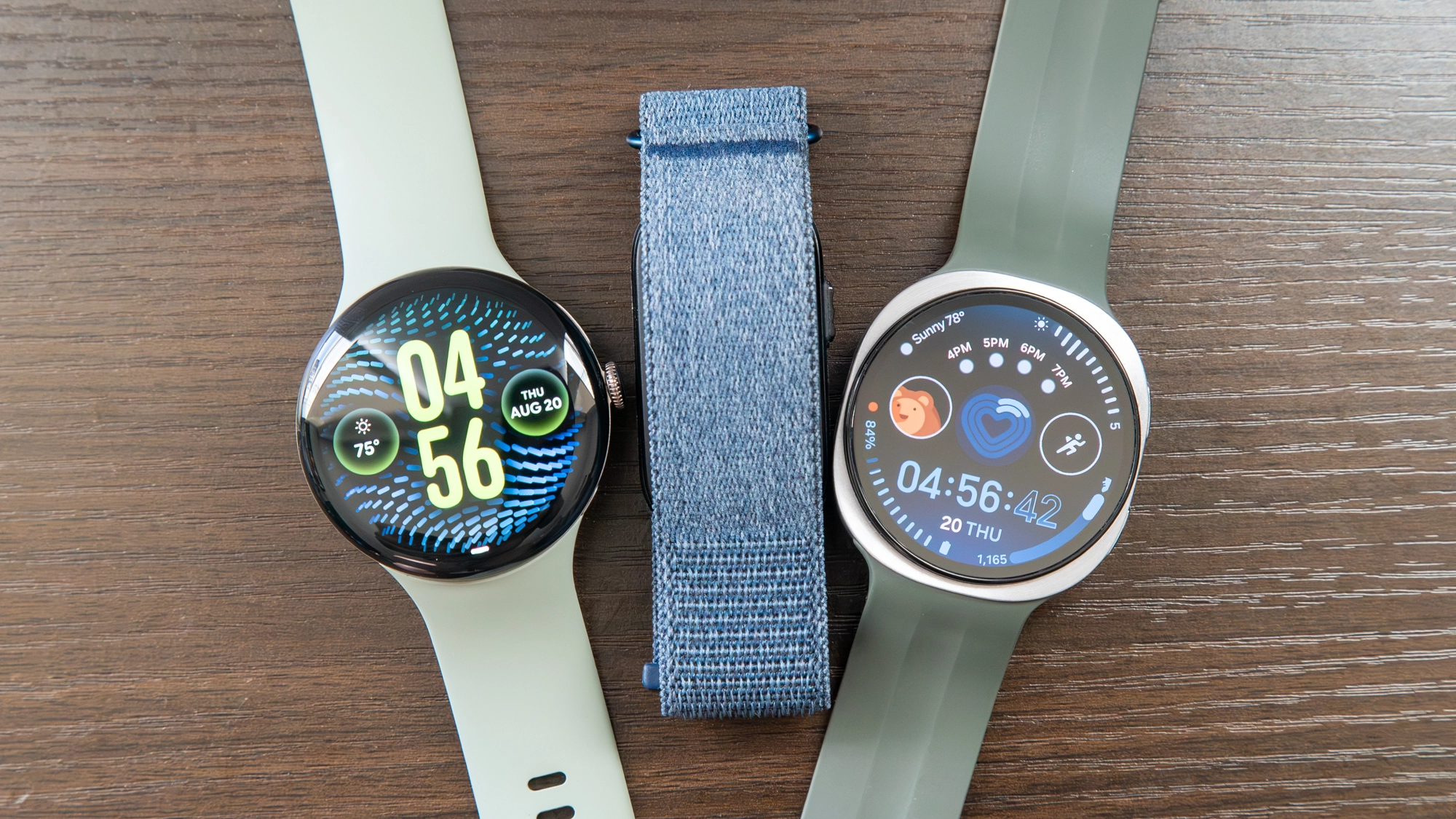

The Pixel Watch 5, Garmin Cirqa, and Galaxy Watch 9
(Image credit: Derrek Lee / Android Central)

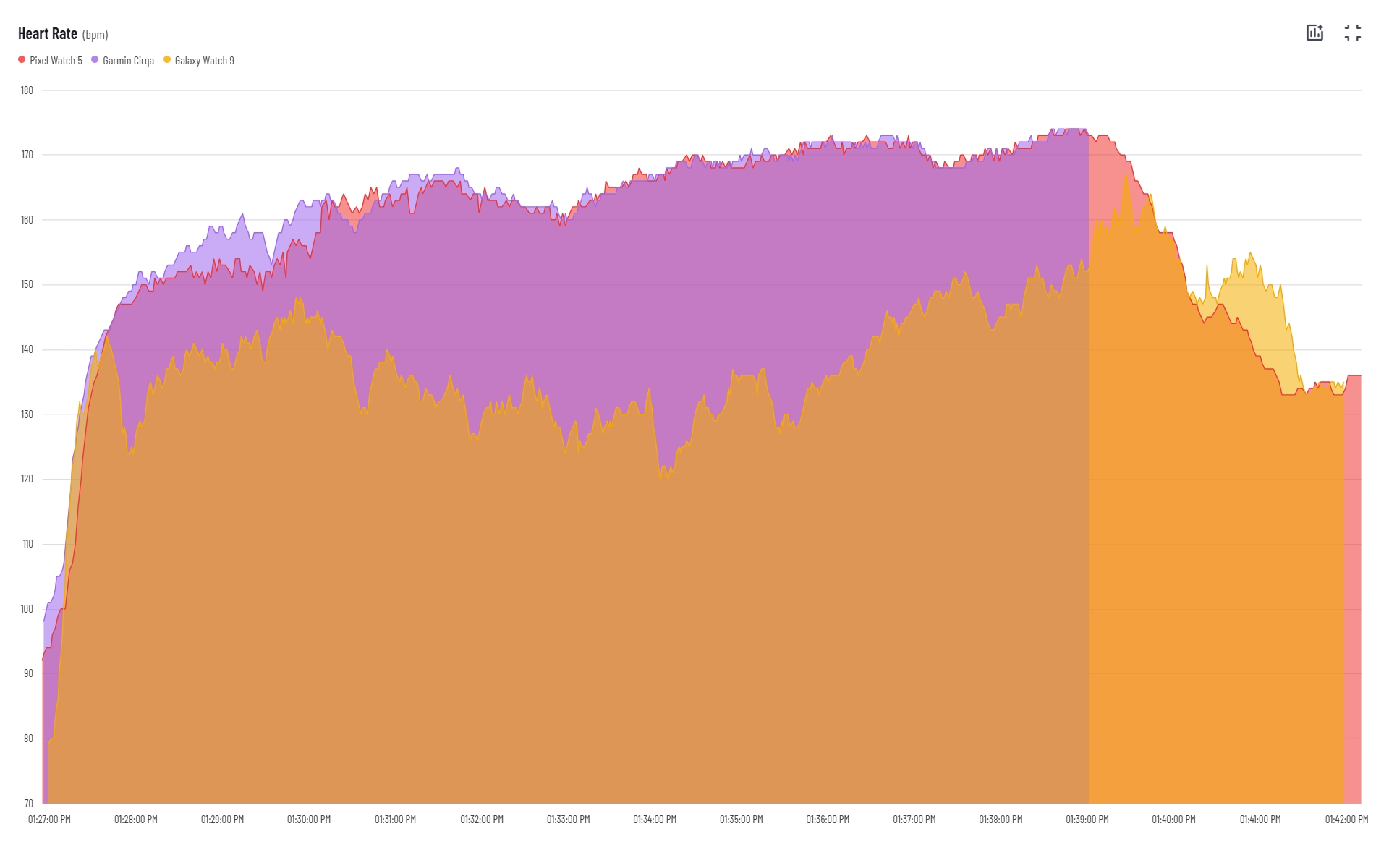

Last weekend, I ran the Emerald City 5K, which was just over 5 kilometers (3.1 miles). Each device measured my heart rate, but you can see from the chart below that there were some interesting deviations from the Galaxy Watch 9.
The Samsung watch took nearly four minutes to catch up to the Cirqa and Pixel Watch, only to continue rising well above the other two wearables for more than 10 minutes. The race had just started, and I know my heart rate wasn't so elevated right off the bat.
After about four minutes, the Cirqa and Pixel Watch 5 also diverged, with the latter dropping to about 135 bpm while the former remained relatively steady. The Pixel Watch eventually catches up, and they remain pretty much in sync for much of the run. That is, until the end, when it fell just below the Galaxy Watch 9 and Garmin Cirqa. At this point, I was "sprinting" (and I use that term loosely) to the finish line, so I know my heart rate was elevated.

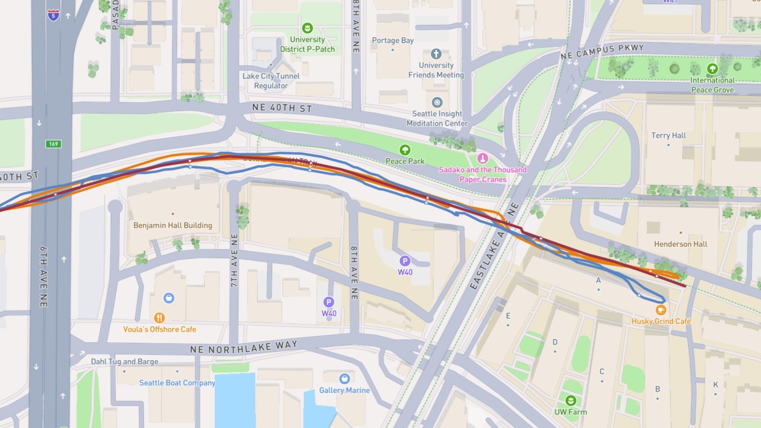

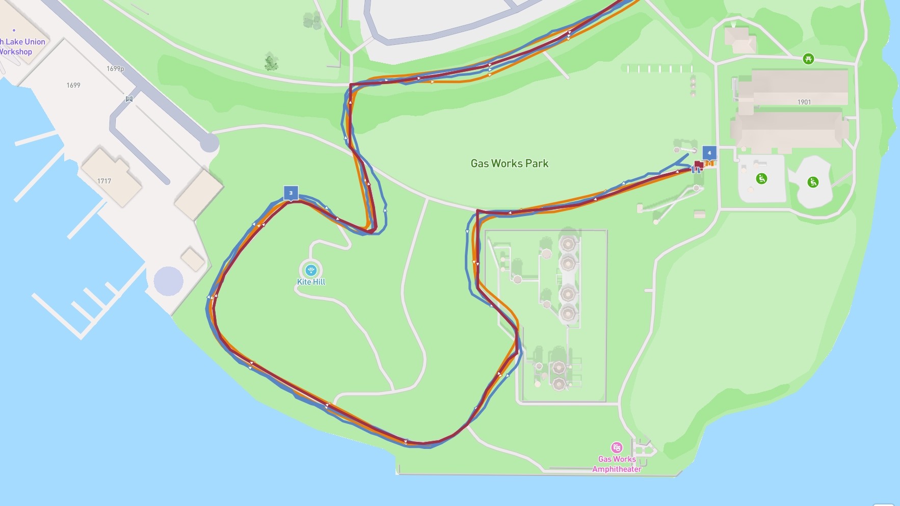

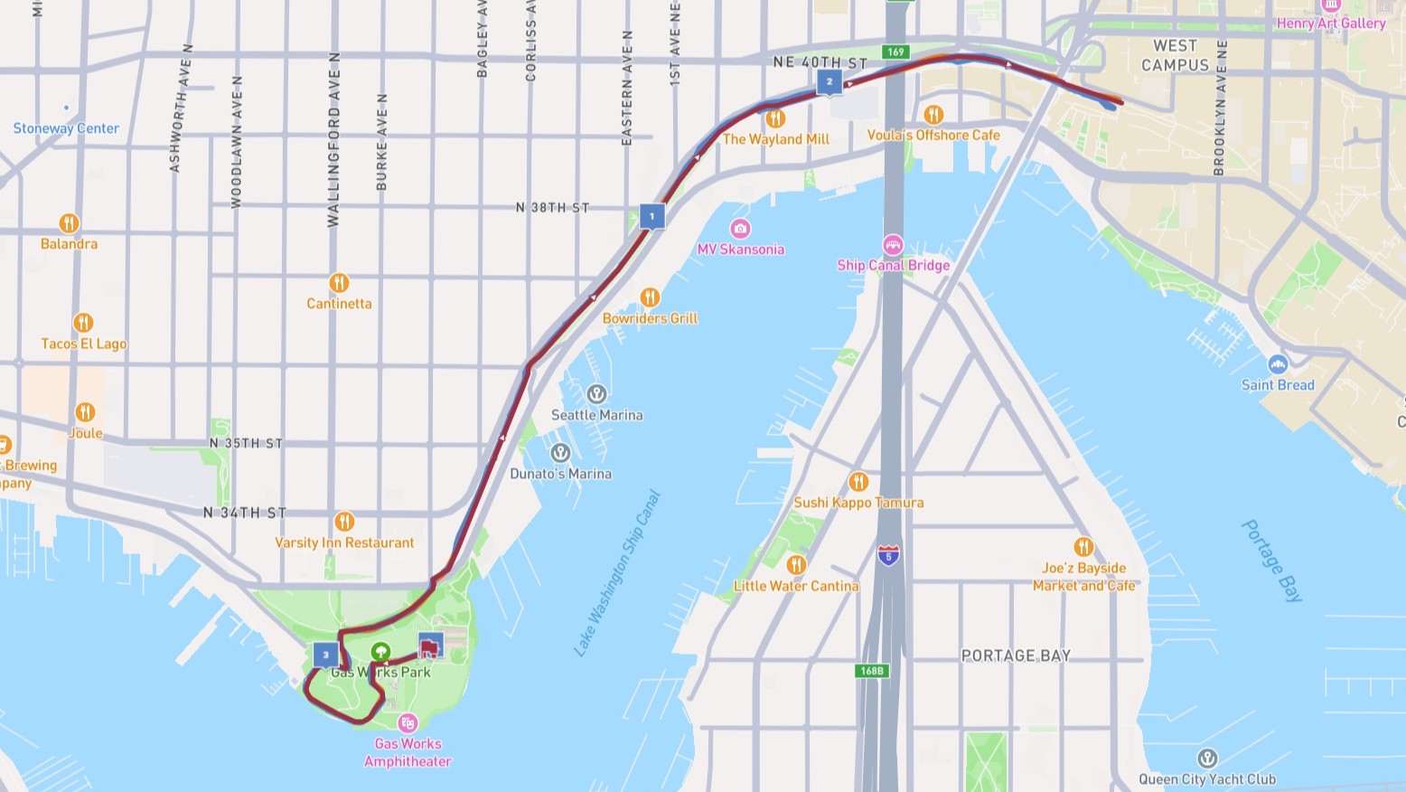

I intended to record GPS data during the run, but for some odd reason, the Pixel Watch 5 did not track the route while the Galaxy Watch 9 and Garmin Cirqa (via my phone) did. I can only chalk it up to the Pixel Watch not properly connecting to GPS before the run started.
Still, you can see how the Galaxy Watch and Garmin Cirqa compare with the actual 5K route, marked in brown in the images below. Even though the Cirqa (blue) was connected to my phone for GPS data, it deviated quite a bit from the actual route, showing that I ran on the grass toward the beginning even though I remained on the pathway. It was also quite a bit off at the midpoint when I made a U-turn to head back to run the second half of the race.
Meanwhile, the Galaxy Watch 9 (orange) did surprisingly well throughout the run, pinpointing my position more accurately.
The Galaxy Watch 9 was also the closest to measuring the actual route distance, which was 3.146 miles, according to the official website. The Watch 9 logged 3.15 miles, the Pixel Watch 3.19 miles, and the Garmin Cirqa (via my phone) 3.29 miles. This tells me that, at least, there should be nothing wrong with the Pixel Watch 5's positioning, despite the lack of actual map data.
Also, perhaps the Galaxy Flip 8 isn't the best for connected GPS data, given the Garmin Cirqa's numbers and map data.

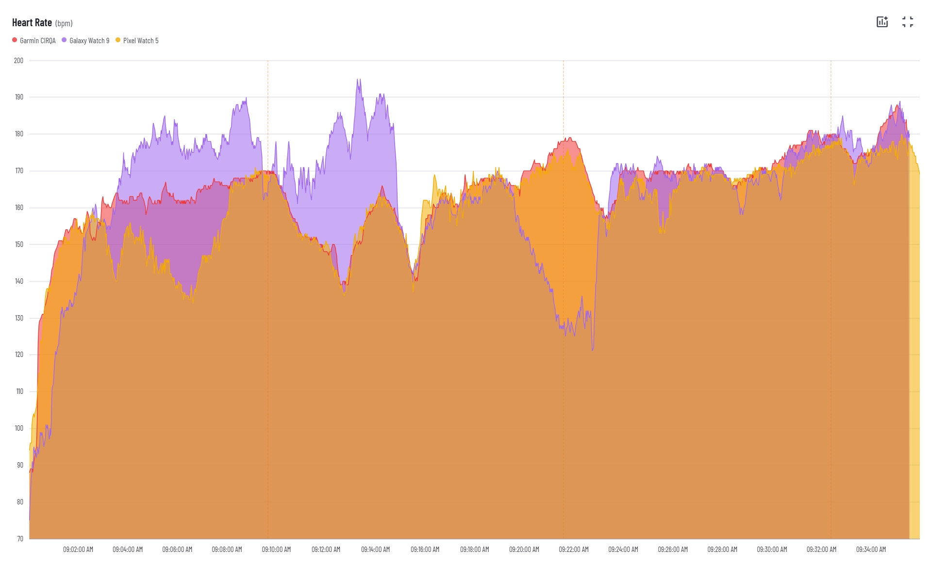

In addition to running the 5K, I tracked a second, shorter run. I also monitored my heart rate during that 5,000-step walk.
During the run, the Pixel Watch 5 and Garmin Cirqa were largely in sync. However, the Galaxy Watch 9 started off strong for about one minute before logging much lower heart rate data throughout the 12-minute run.
Note: I ended the run on the Garmin Cirqa prematurely once I began my cooldown, which is why the data suddenly stops.

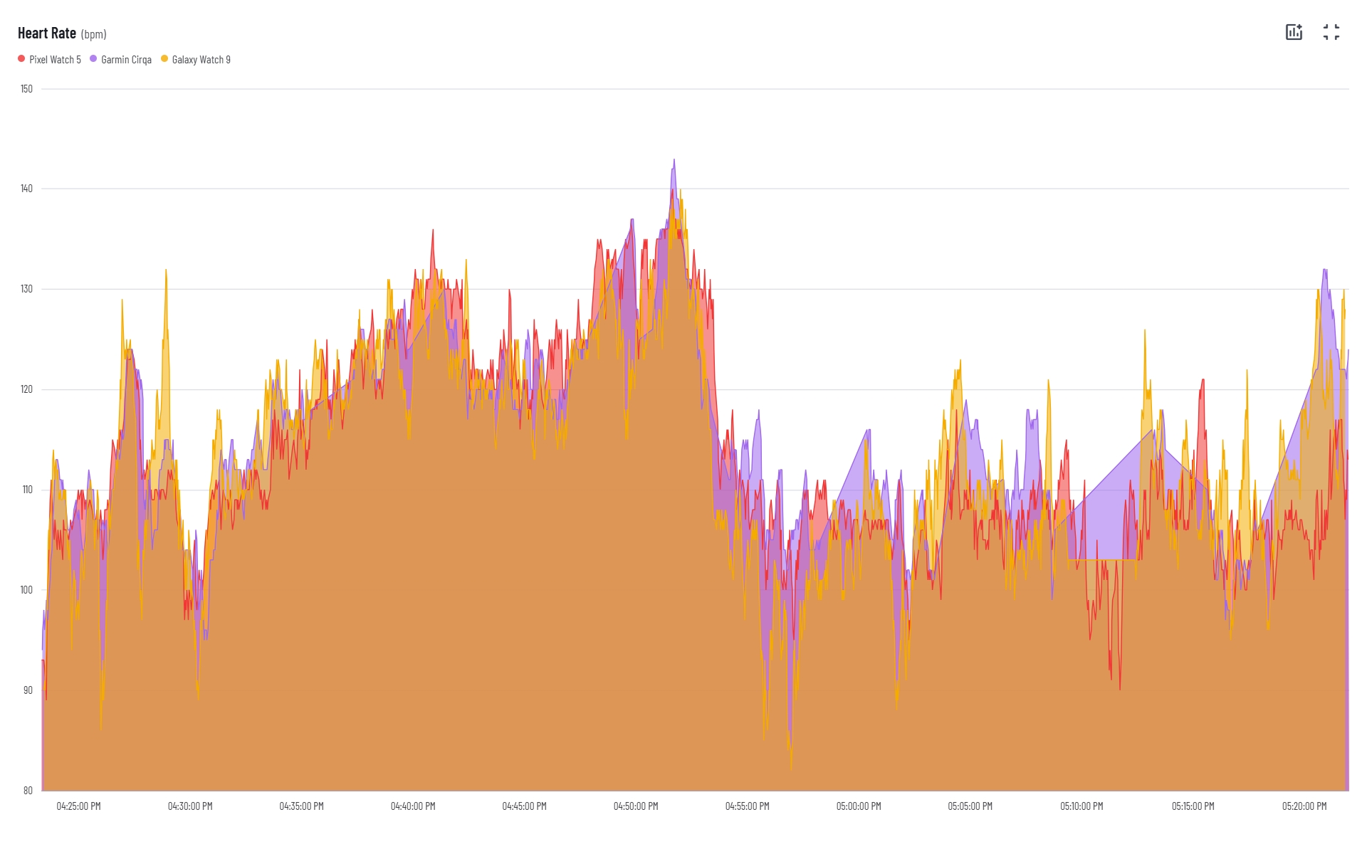

As for the walk, all three devices were within the same ballpark, which wasn't much of a surprise as it was a much lower intensity activity with less dynamic movement and fewer reasons for sudden jumps or dips in heart rate.
That said, the Galaxy Watch 9 was more consistently slightly lower than the other two devices. Toward the end, it was the Pixel Watch 5 that dropped below the other devices.
The data shows some interesting-looking straight-line jumps from the Garmin and later in the Galaxy Watch, although I think this was just an error in how the data is bring presented.
