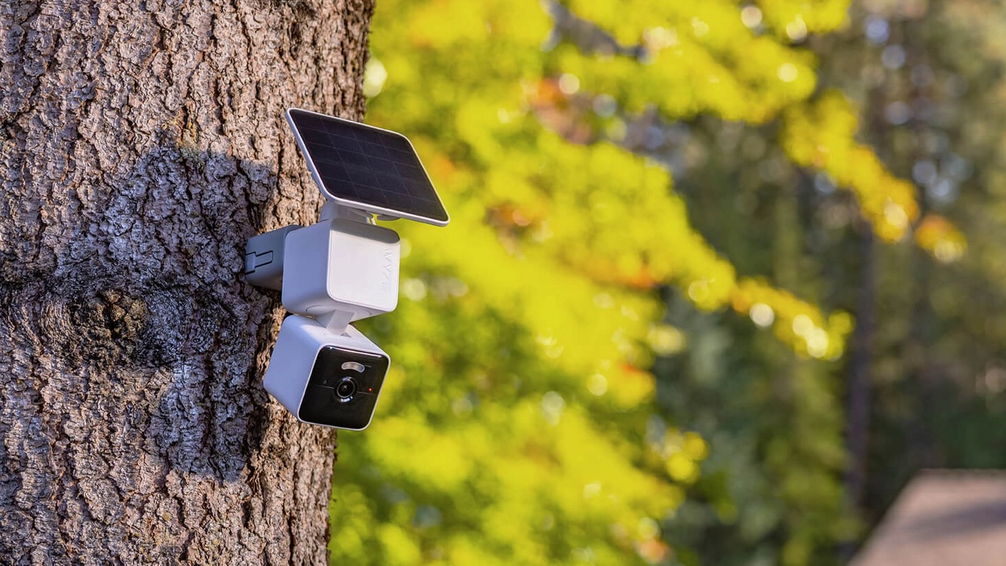

The smart home company announced that it is recalling about 321,360 Solar Cam Pan security cameras in the U.S. following reports that some units overheated, caught fire, and caused minor burn injuries. The recall follows an investigation that found the problem is in the installation instructions for the camera, not the core hardware design, which could cause the user to inadvertently damage the device’s lithium-ion battery.
The issue is how the Solar Cam Pan is mounted. Some customers may have used a long flat-head screw to secure the solar panel to the camera instead of the shorter pan-head screw that was meant to be used in that step, the U.S. Consumer Product Safety Commission (CPSC) notes. If installed improperly, the longer screw may pierce the metal casing of the battery and may cause rapid overheating, fire, burns, or even an explosion.

The recall involves the Wyze Solar Cam Pan wire-free, model number WYZESCPWH. The white outdoor camera, released in late 2025, was Wyze’s first battery-powered pan-and-tilt camera with an integrated solar panel, providing 2K video recording, AI-powered person tracking, and maintenance-free solar charging.
