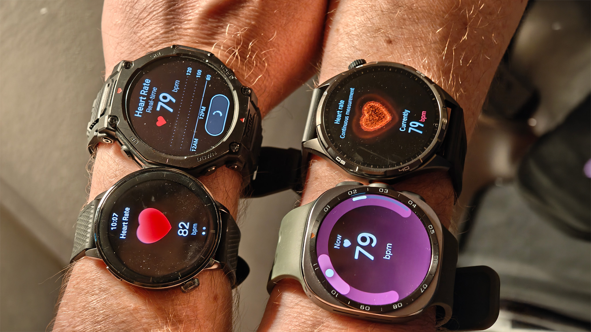

Wearing an Amazfit T-Rex 3 Pro, Honor Watch 6, OnePlus Watch 3 43mm, and Samsung Galaxy Watch Ultra 2 to bed
I would never recommend sleeping with four smartwatches on, but I will say that it wasn't nearly as uncomfortable as I had been dreading. Most smartwatches collect the same sleep data, but every so often you'll find a watch that does something different. The Galaxy Watch Ultra 2, for example, included a skin temperature measurement, measured against a baseline it had determined in the past 2 weeks since I started wearing it.

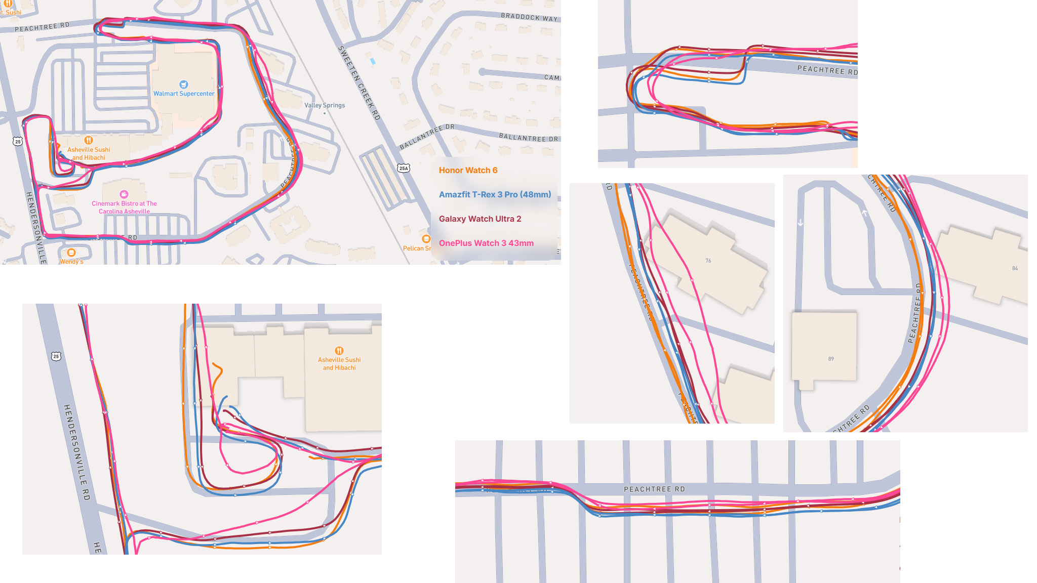

My intuition wasn't wrong. Looking at the map data above, where I ran 2.5 miles over two loops around this Walmart and the surrounding business park, things look pretty even until you zoom in. I broke off sections of the track so you can see the GPS tracking discrepancies between the watches.
Overall, the OnePlus Watch 3 43mm was the least accurate (genuinely a surprise to me), while the Galaxy Watch Ultra 2 and Amazfit T-Rex 3 Pro tied for first. The Honor Watch 6 also did an excellent job, but there were two points on the map with notable tree cover that showed me running in the road instead of on the sidewalk, while the other two kept me on the side of the road.

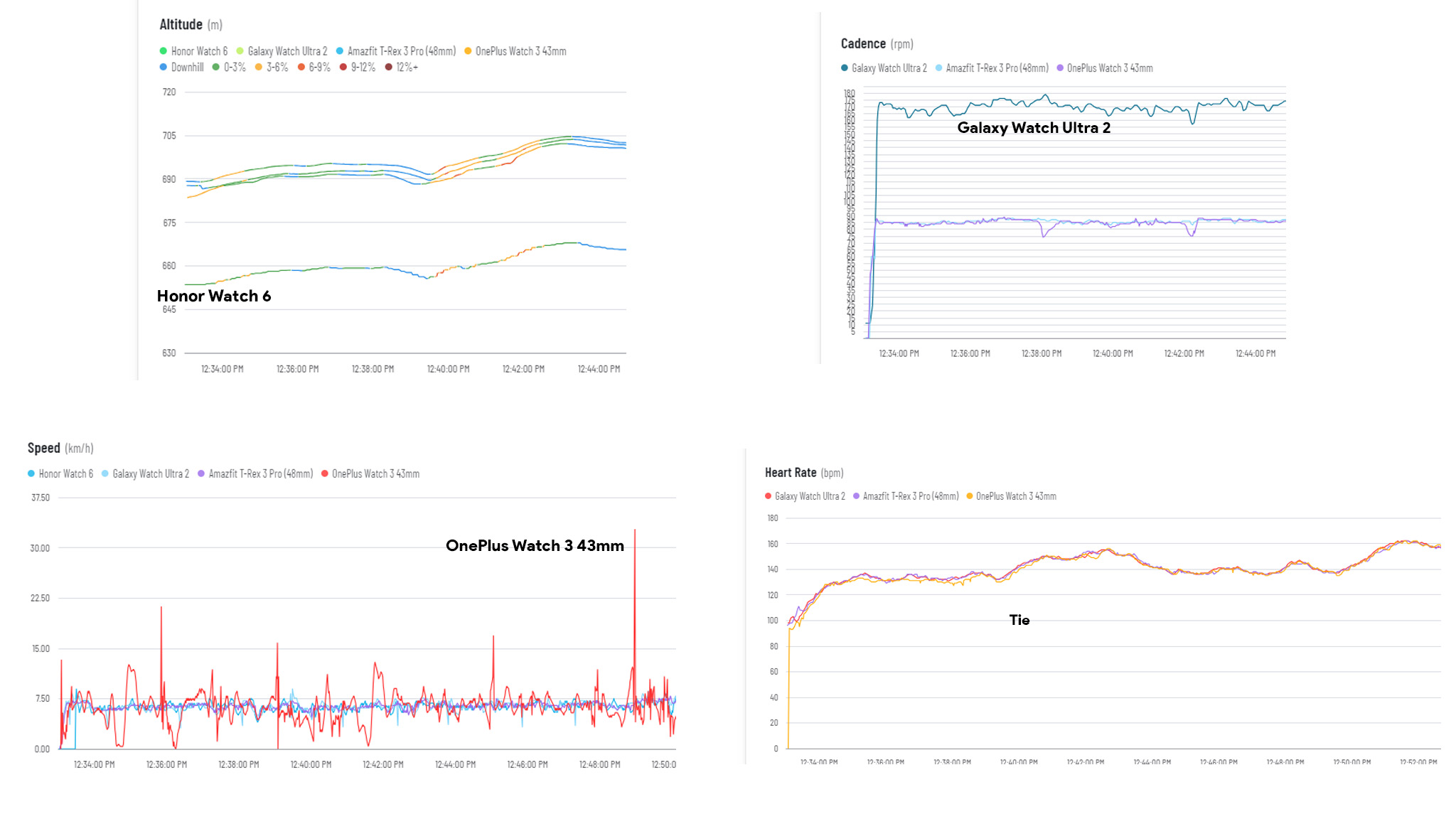

As I dove deeper into the rest of the data, I found a consistent pattern among all four watches. In each data point, there was a clear outlier. The Honor Watch 6, for example, got the altitude all wrong, while the Galaxy Watch Ultra 2 completely fumbled the cadence measurement.
The OnePlus Watch 3 43mm had some very strange spikes and dips in speed, almost assuredly owing to the GPS tracking issues I mentioned earlier, while all four watches tied for heart rate accuracy. Notably, the Amazfit T-Rex 3 Pro didn't show up as an outlier on any of the data points, owing to its excellent overall accuracy.

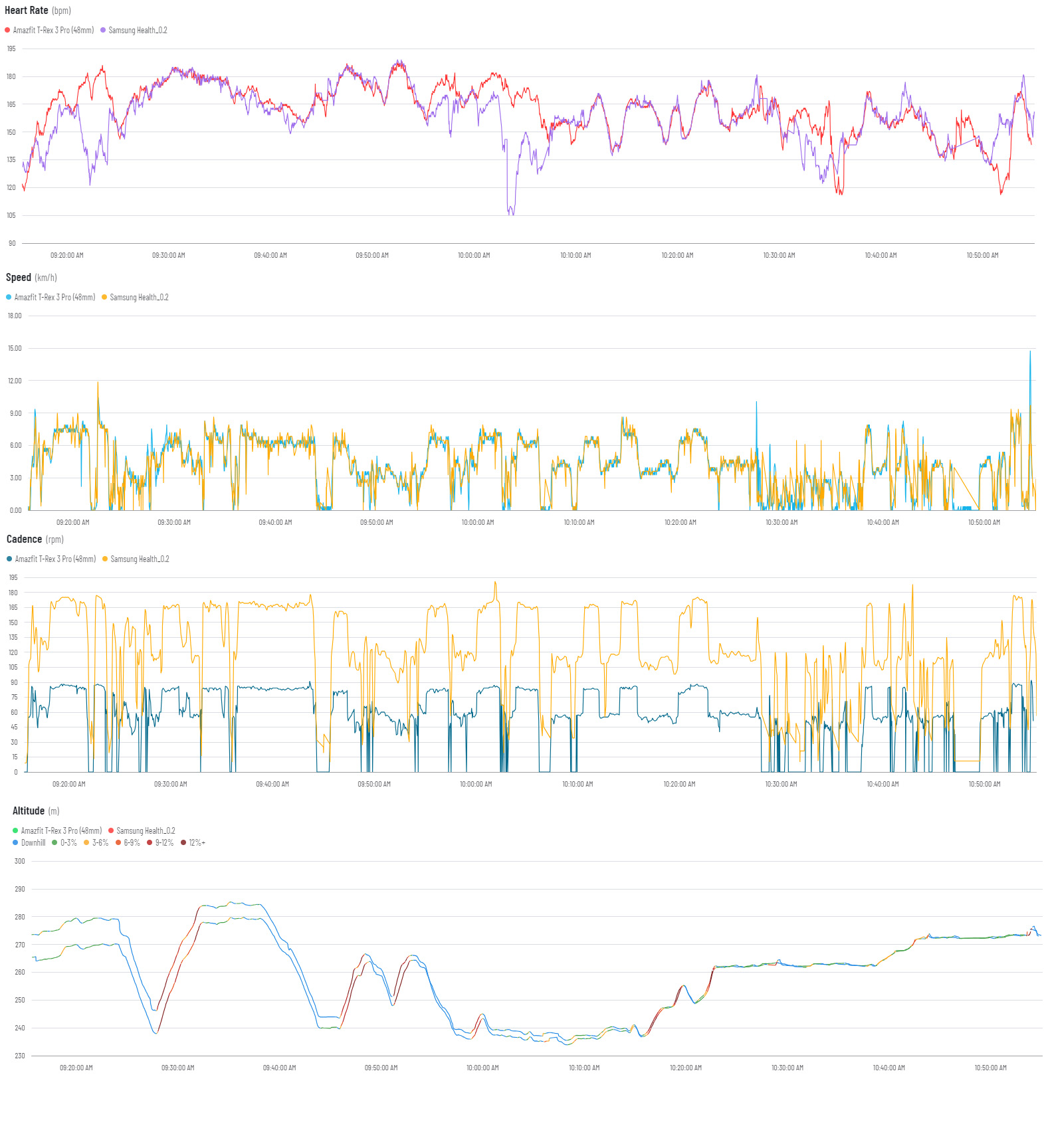

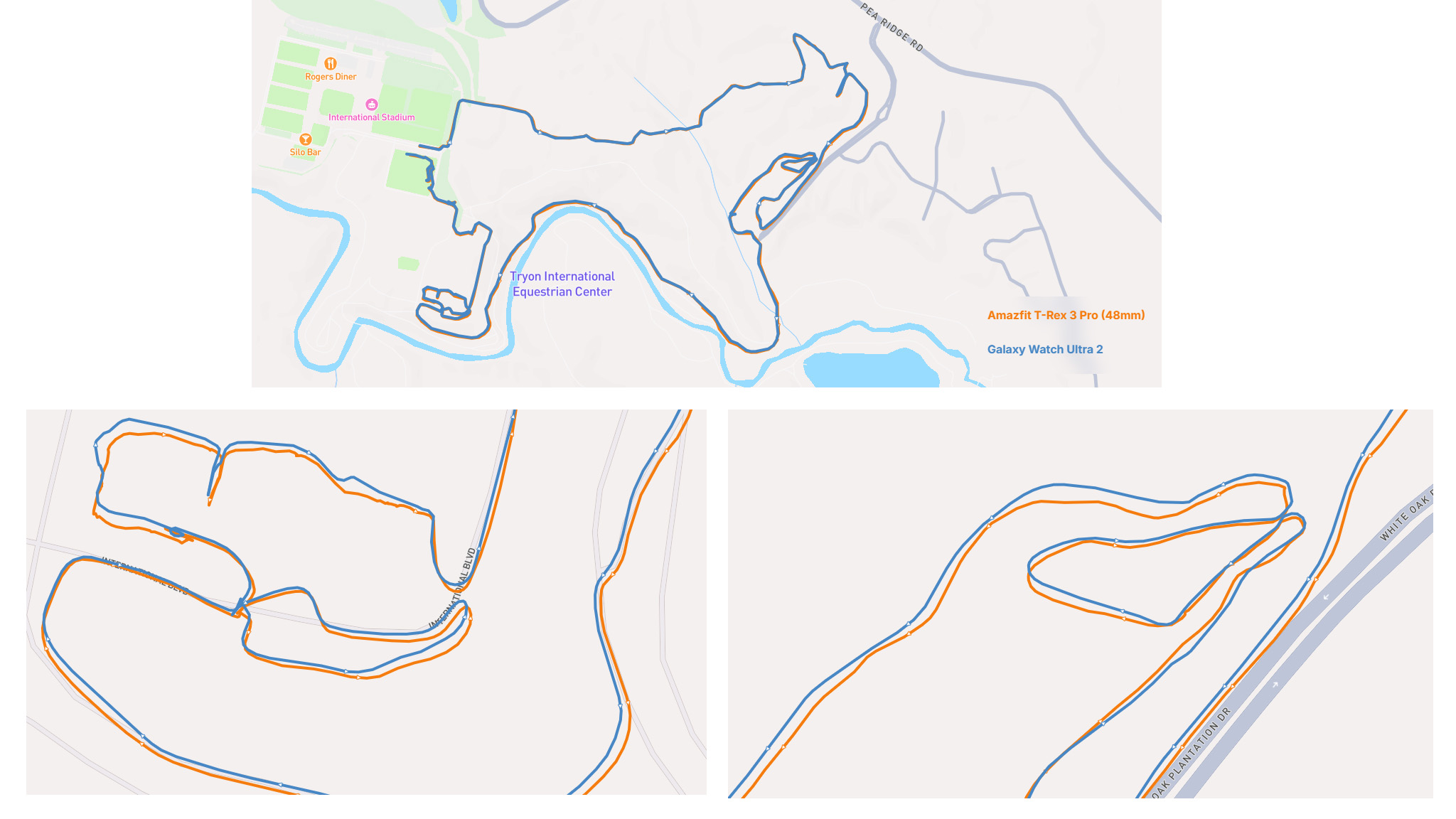

As I approached the Spartan Race, it was clear that Amazfit and Samsung were leading the pack here. Since I had to wear an RFID bracelet and a separate time bracelet for the race, I only had room for two smartwatches, so this was going to be between the winners.
I don't see any obvious discrepancies in the GPS data between the two watches. Clearly, each is slightly different from the other, but it's impossible to tell which one is right since this is a trail course. I'll give this section a tie.
You'll need to click the expand button on the image above and zoom in to see all the details, but once you do, you'll understand why Amazfit did a better job of tracking this race. In the heart rate data, you'll see three points where the Galaxy Watch Ultra 2 did something weird. Just after 9:20 and around 10:05, it registered a far lower heart rate than I actually had.
Then, around 10:46-10:50, it seems to have failed to get a heart rate at all. Strangely enough, that same lapse in data also appears in the speed and cadence graphs. While both watches were dead-on with speed data and mostly similar with altitude, the Galaxy Watch Ultra 2 wildly messed up my running cadence, which happened during other runs I've gone on with this watch, too.
This particular Spartan Race was both very busy and extremely muddy, causing quite a bit of backup at each obstacle. On the cadence graph, you can see where the Amazefit T-Rex 3 Pro properly measured me not moving while waiting in line, yet the Galaxy Watch Ultra 2 seems to think these moments didn't happen. Trust me, I was frustrated enough to remember them, and that's enough to give the T-Rex 3 Pro the win.

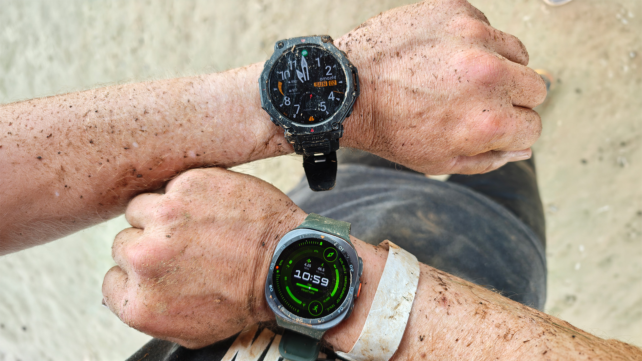

Wearing an Amazfit T-Rex 3 Pro and a Samsung Galaxy Watch Ultra 2 during a Spartan Race
