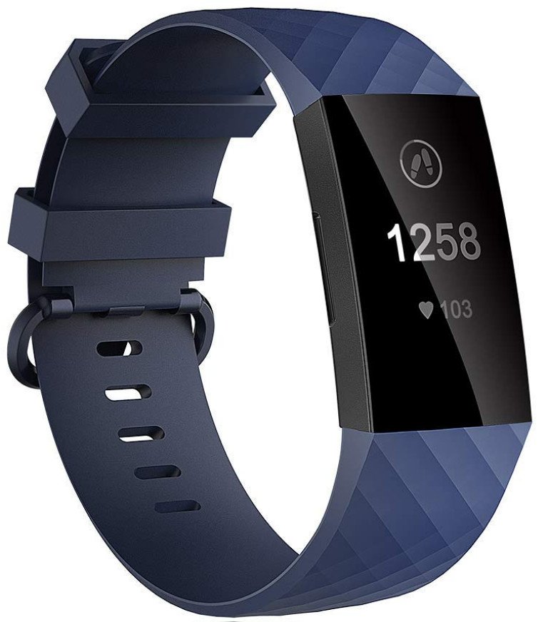

Velavior Waterproof Replacement Band ($7 at Amazon)
If you're searching for the ideal workout companion, this band for the Fitbit Charge 3 or 4 is it. It's made from flexible high-quality elastomer that's waterproof and sweat-resistant. Skin irritation is a thing of the past. You can go hard during all your activities with this soft, lightweight, and durable band.
