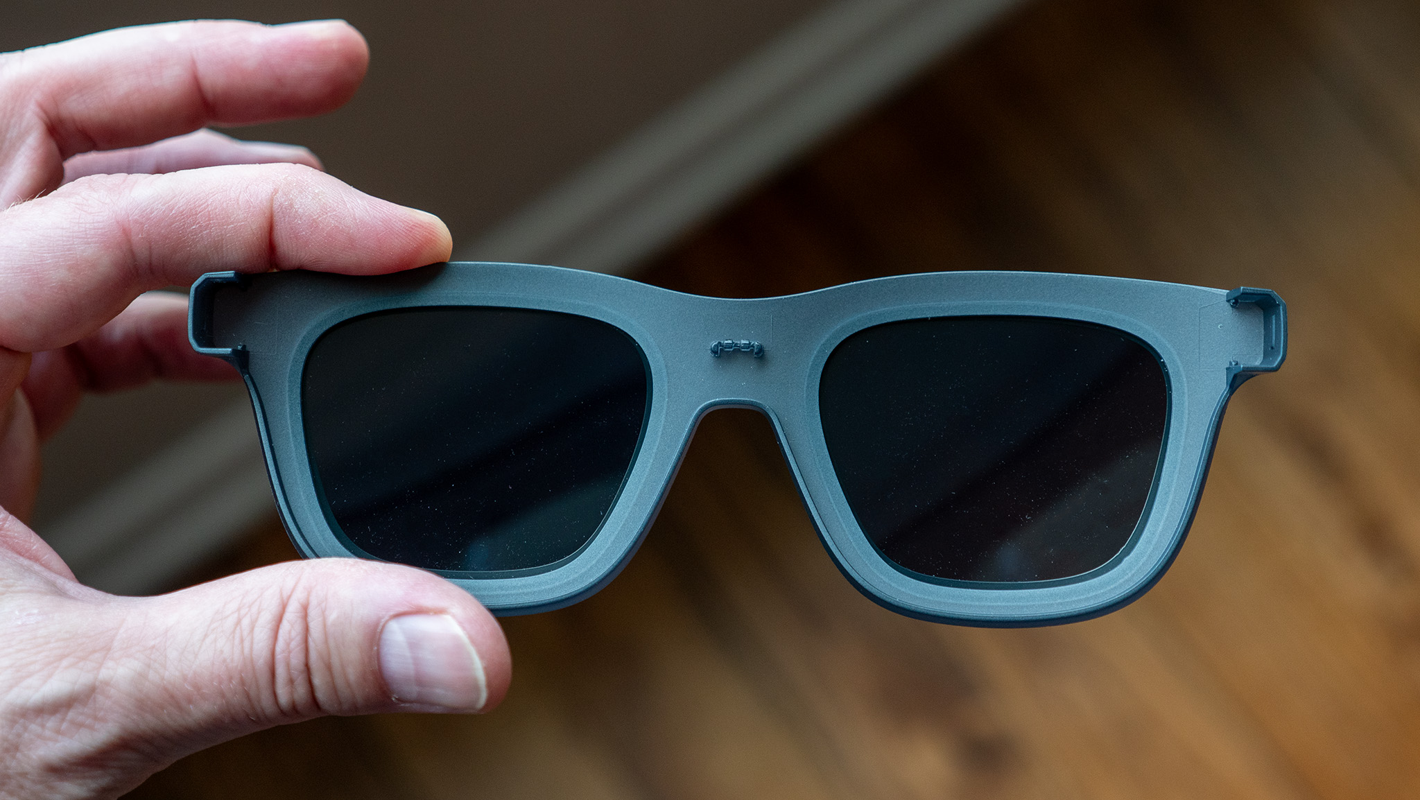

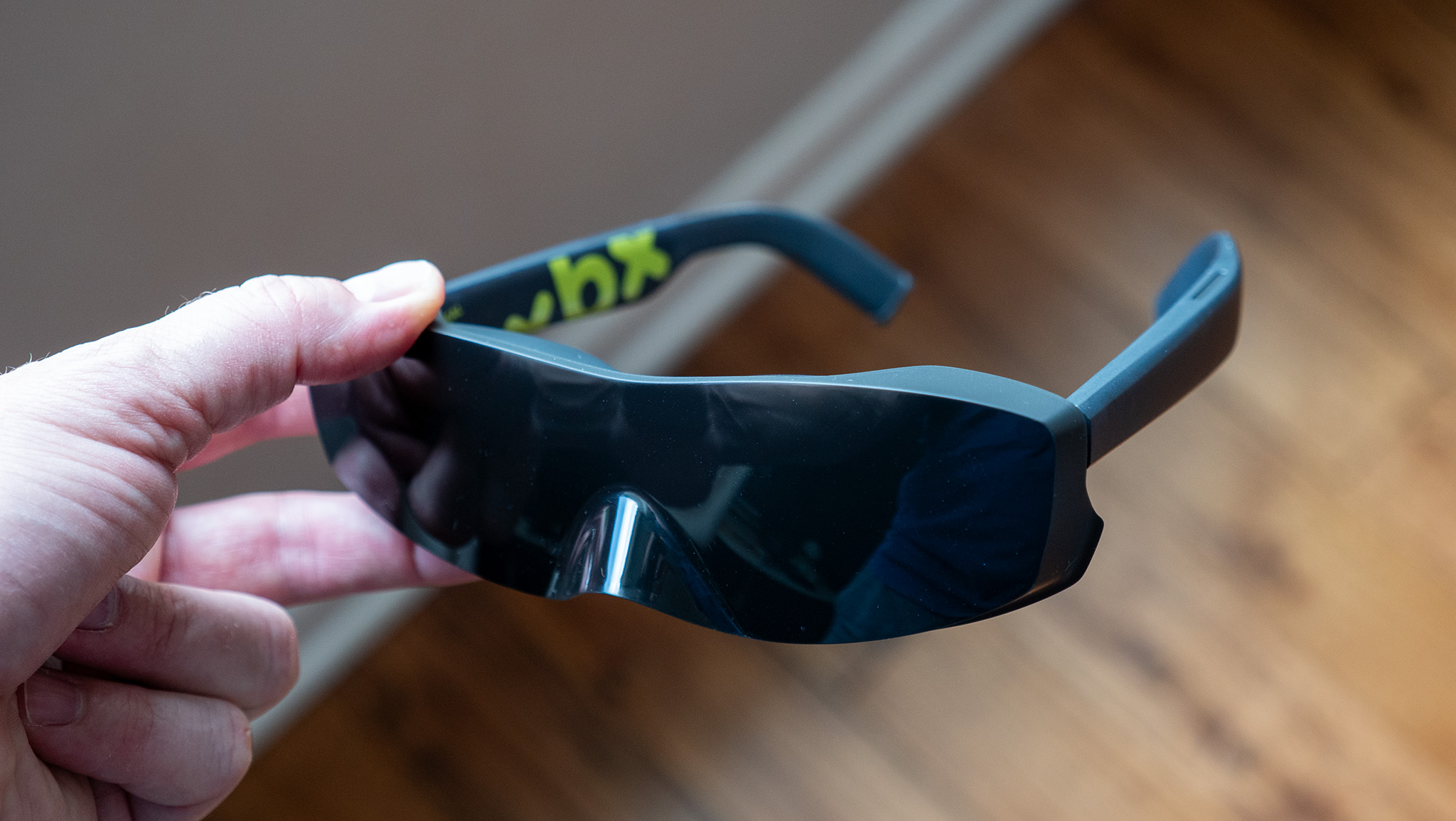

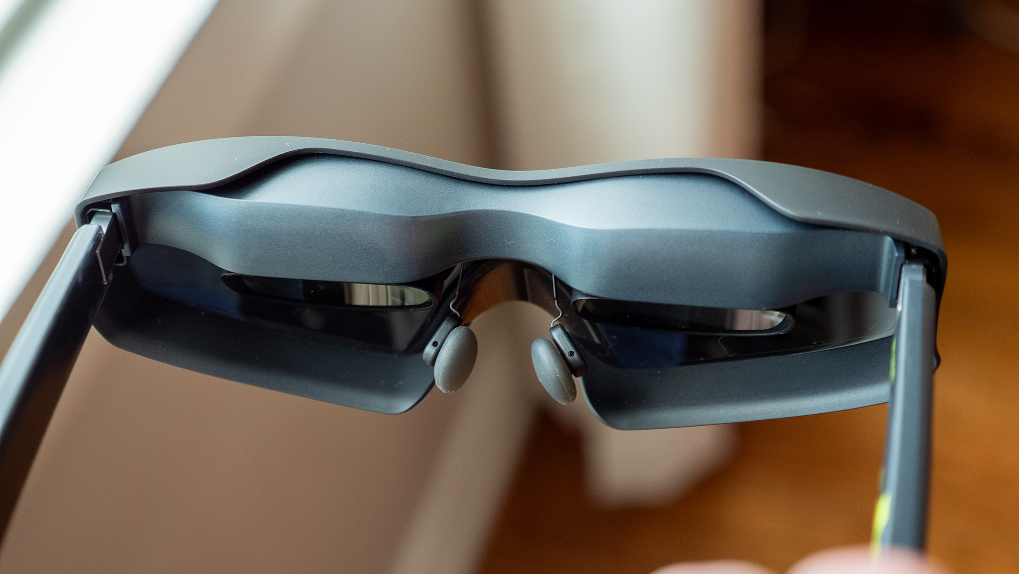

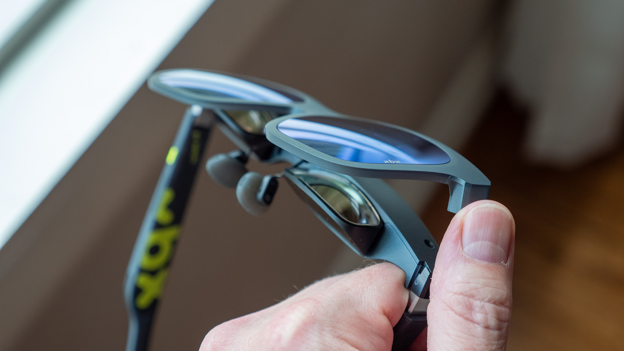

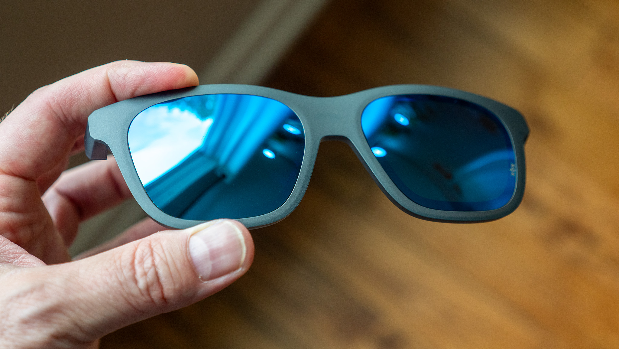

The weight difference alone is reason enough to choose XBX, and the interchangeable frames are more than just the cherry on top. Xreal shipped me a completely different-looking frame that fully replaces the standard Ray-Ban-style look with a smaller, dark-tinted visor style, and that's just one of many styles Xreal offers.

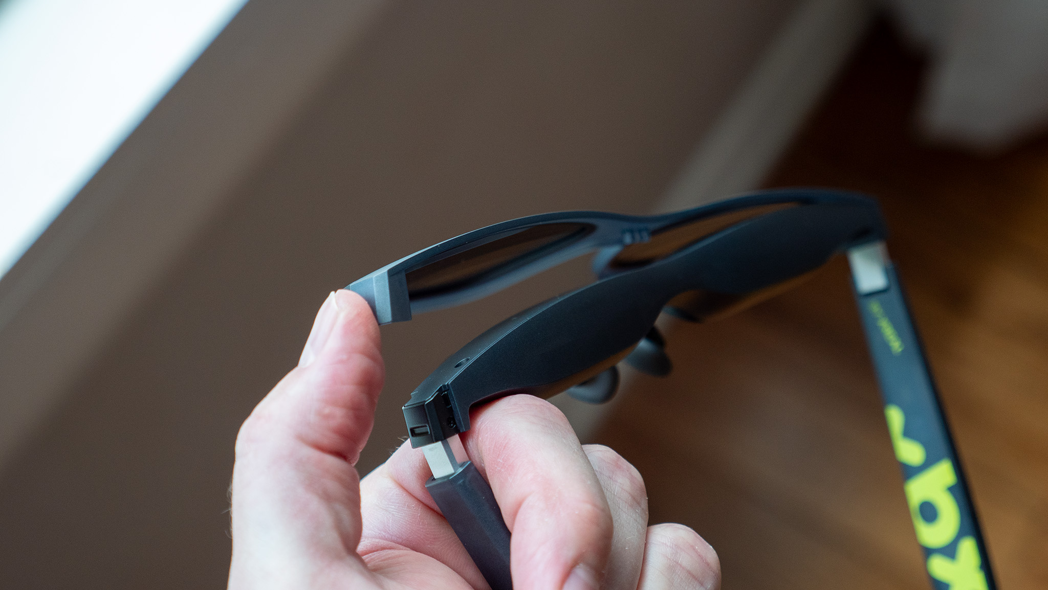

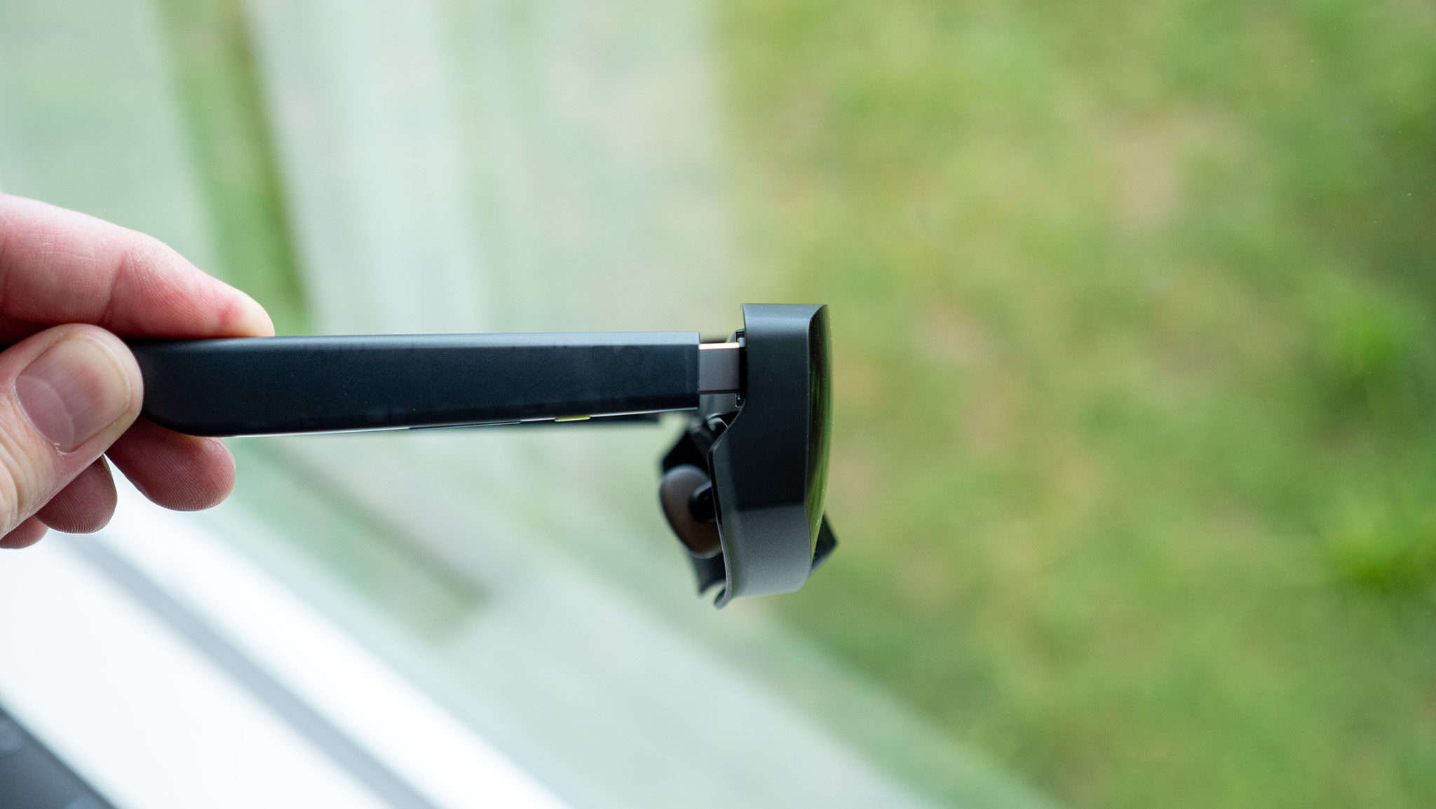

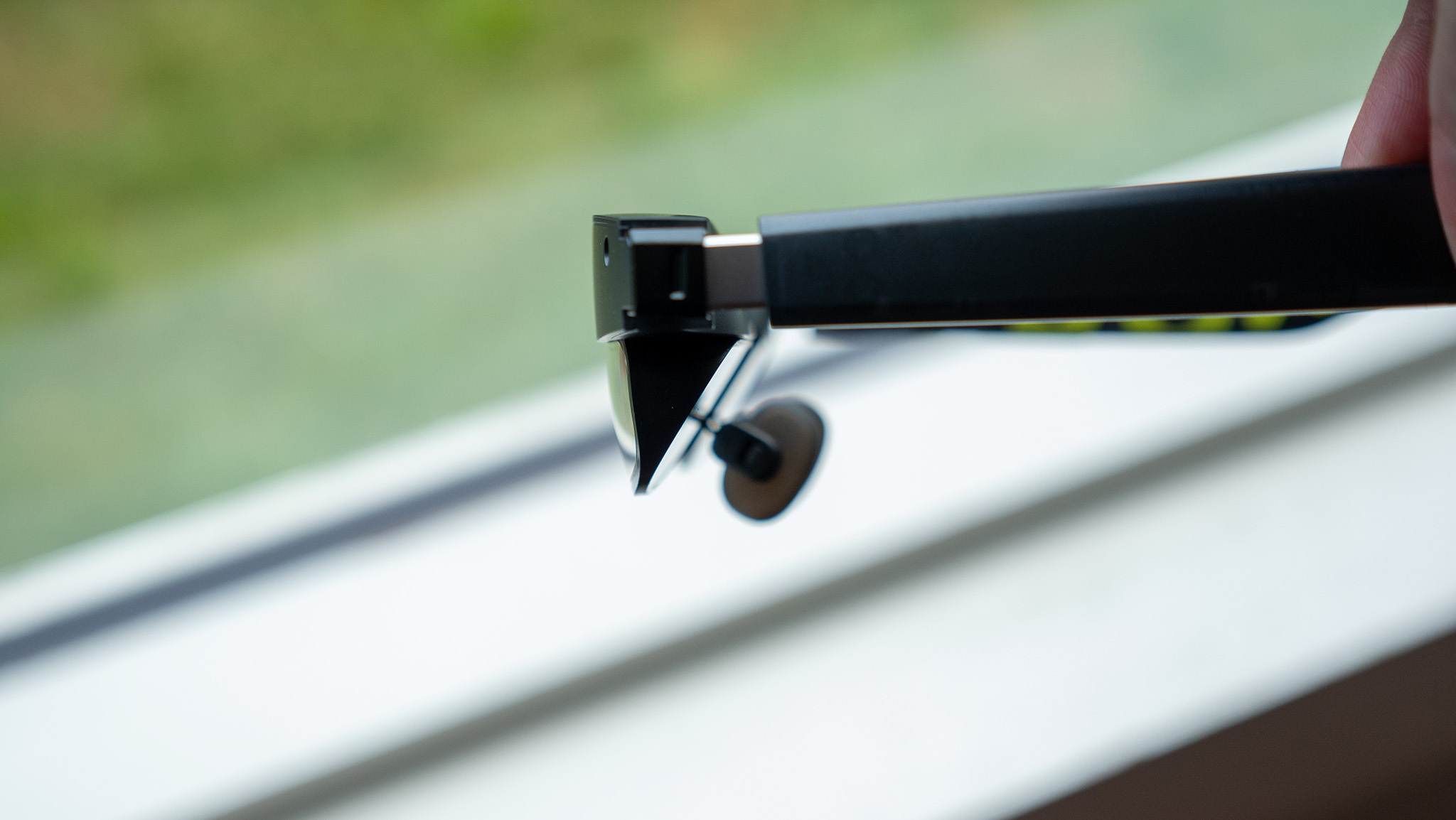

To sweeten the deal, Xreal has provided MakerWorld 3D printing params so the community can create quite literally anything it wants. The frames even pop off by hand, no tools required, and while I was worried I was going to break them on my first few attempts, my Xreal rep reassured me that I'd seriously have to manhandle the glasses to break them.

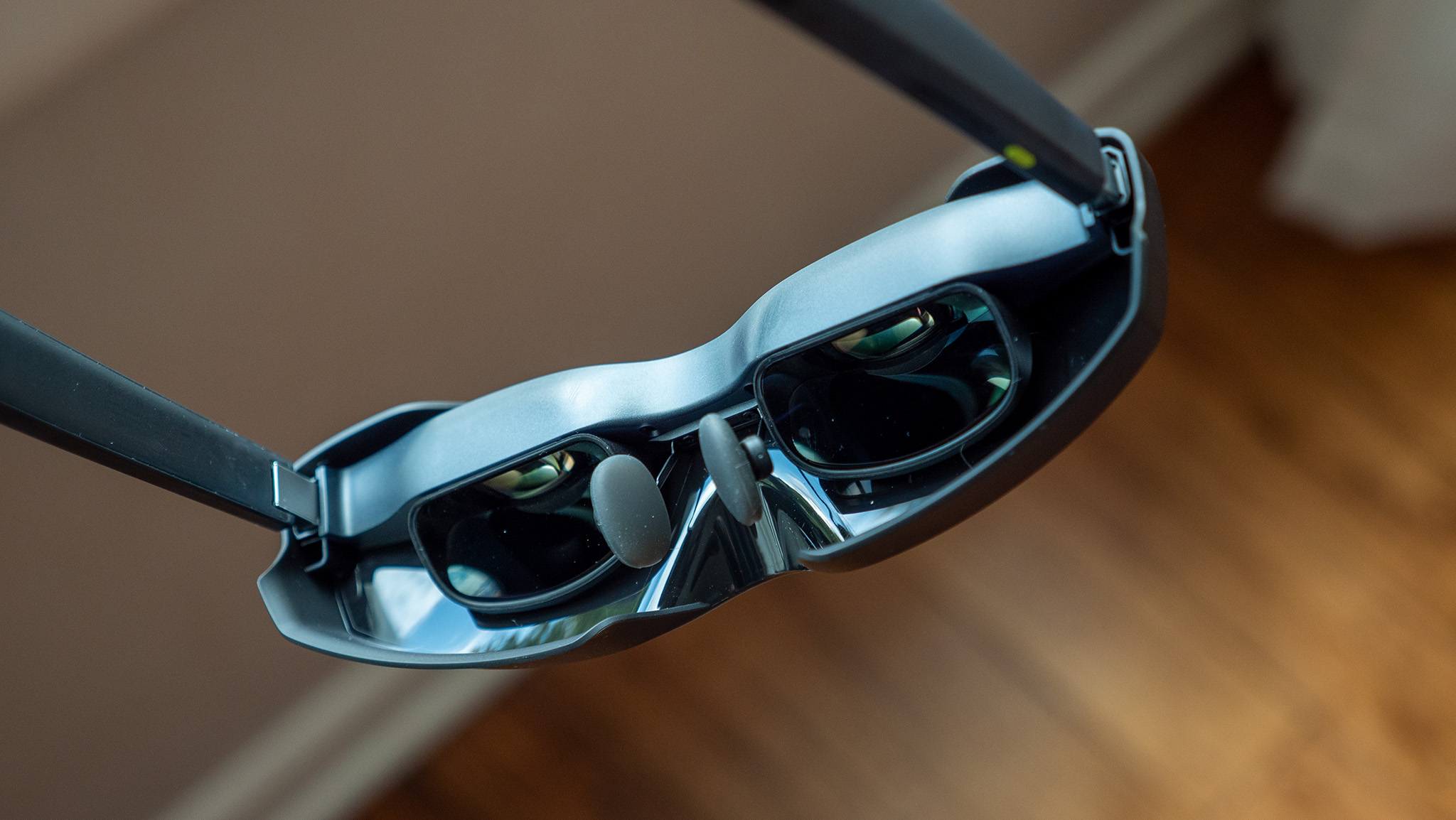

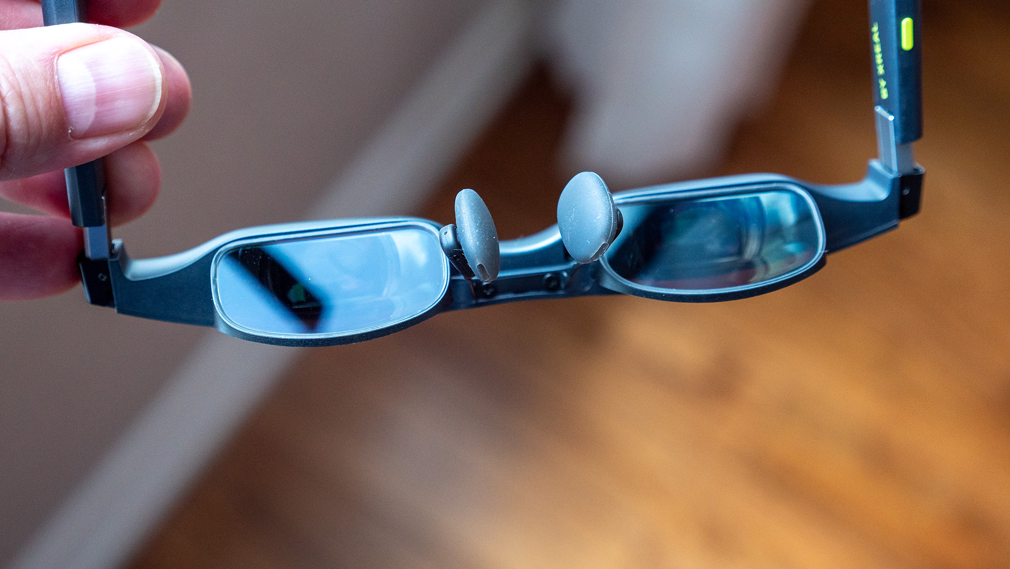

XBX also includes the springiest temple arms to date. These new hinges bend back up to 20 degrees, offering substantial comfort across multiple head sizes. The same three different sizes and shapes of nose pads included with more expensive Xreal glasses are included here, as well, and work wonders for different nose shapes and sizes.

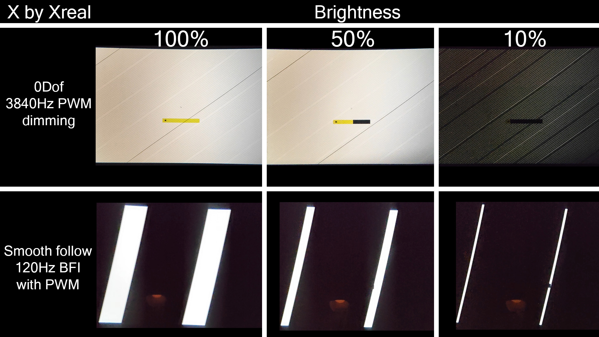

To begin, they use 3840Hz PWM dimming at all brightness levels and during both 60Hz and 120Hz refresh rates. RayNeo Air 4s Pro uses only 3840Hz PWM dimming at 60Hz and switches to roughly half that rate at 120Hz. They also output 1600 nits of brightness, enough to overcome the lack of electrochromic dimming on the lenses.

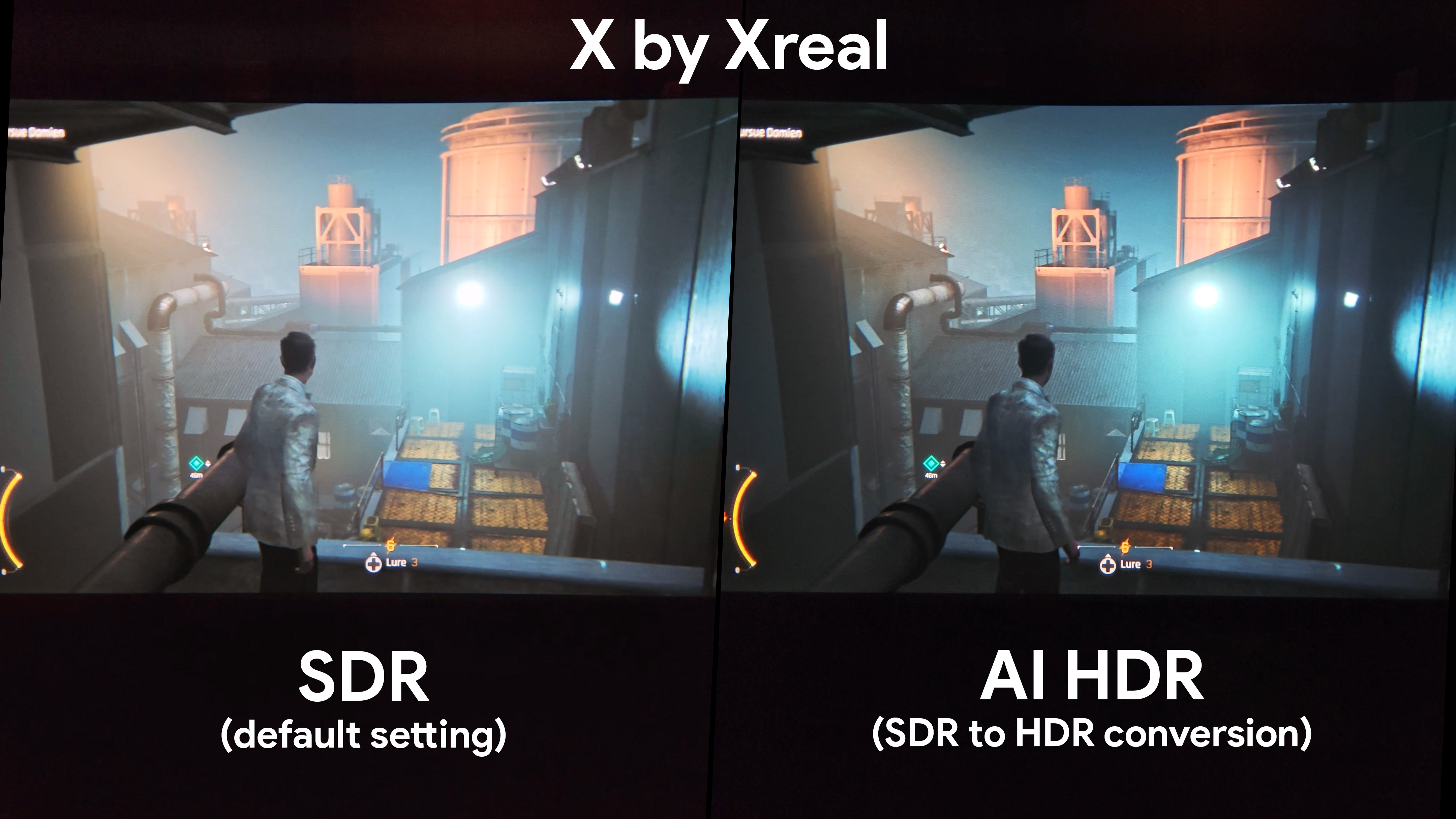

In addition, Xreal's real-time SDR-to-HDR conversion on XBX looks absolutely stellar and adds a notable amount of contrast and dynamic range to all the content I tested it on. I particularly enjoyed this while playing 007 First Light on my Steam Deck, which looked even better than on my TV thanks to the HDR conversion.
On top of all that, XBX offers the first smooth-follow spatial tracking mode on any pair of sub-$400 glasses, a monumental innovation that keeps the display jitter-free, even during airline turbulence. The downside is that, since this isn't powered by Xreal's X1 chip, you can only use smooth follow with the SDR/8-bit display mode. HDR and 10-bit modes are only available with 0DoF tracking, so you'll have to choose between image quality and stability, depending on the situation.

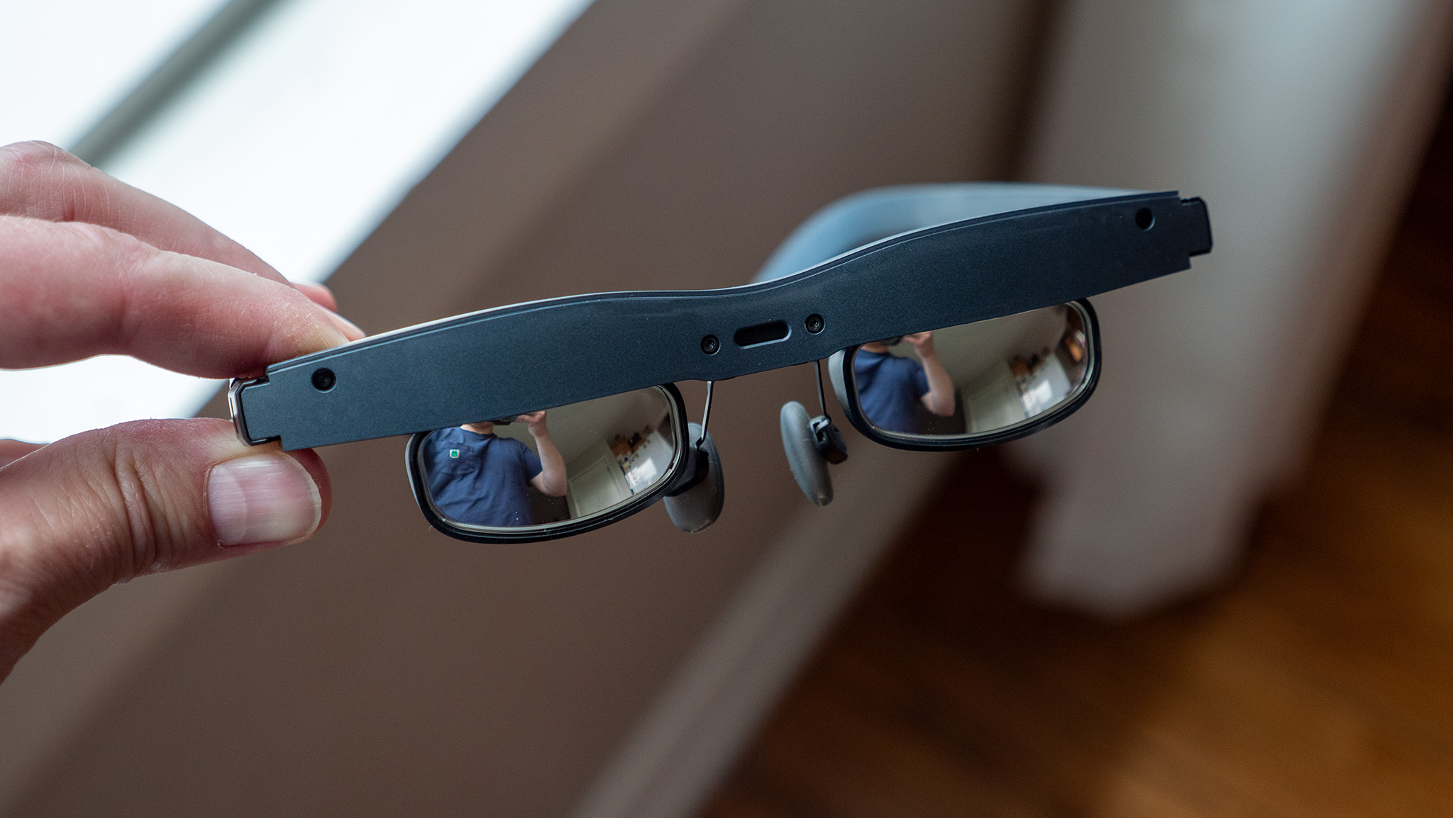

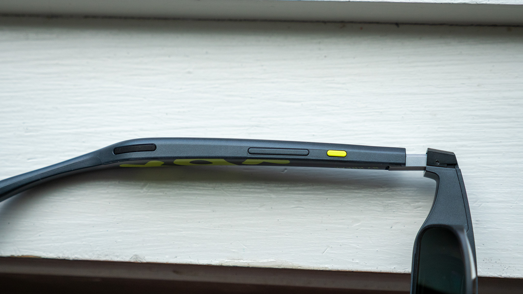

All display and audio options are easily adjusted via the OSD menu, accessed by pressing the X button on the underside of the right temple arm. This menu is quite basic compared to Xreal One or Xreal ROG glasses, but that makes sense given the reduced feature set of this more affordable pair.
