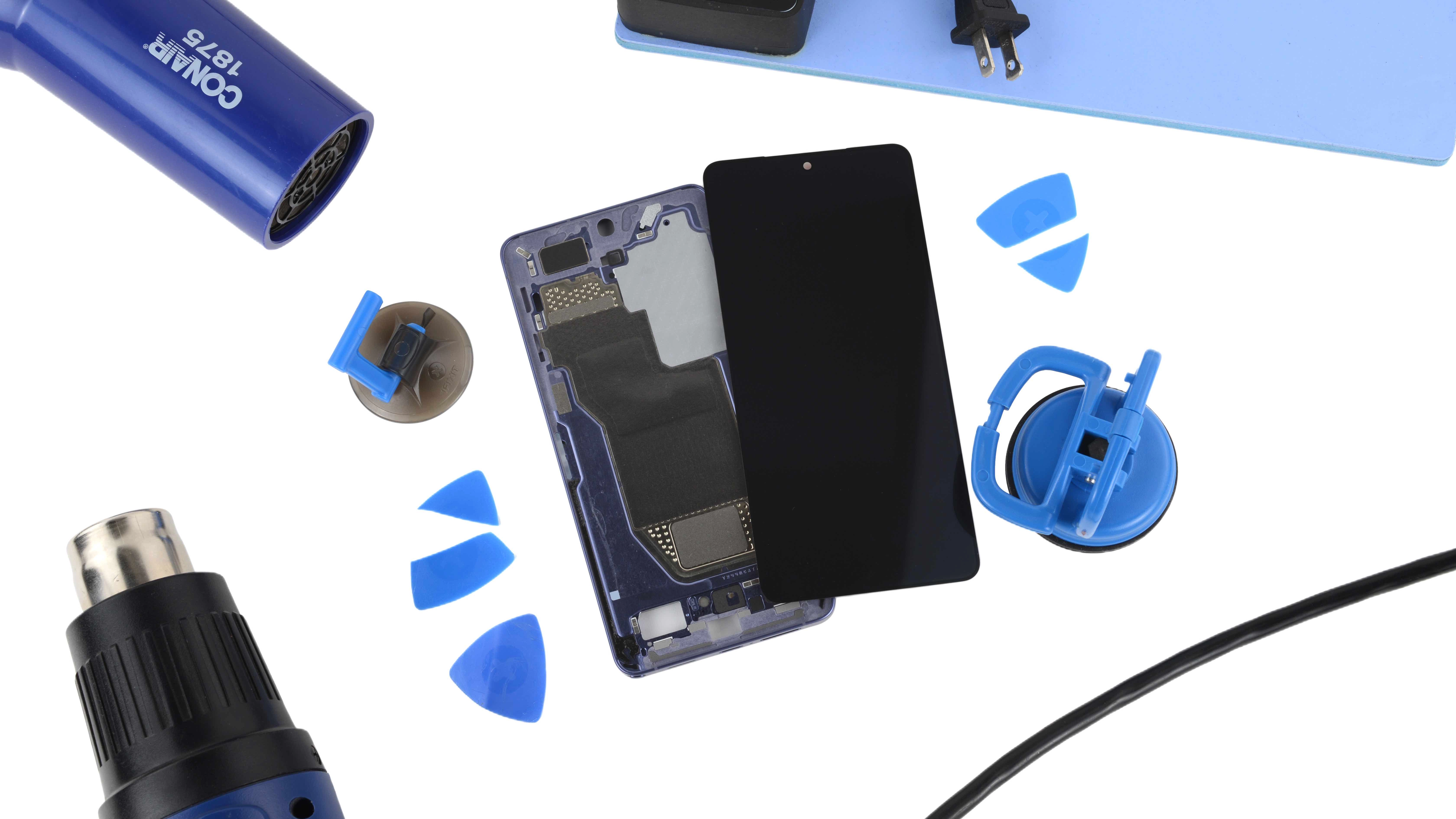

The teardown process got tricky when the iFixit team tried to remove the display. For starters, the Galaxy S26 Ultra's selfie camera is heavily glued to the display assembly, making removal difficult. After moving to the screen itself, iFixit used extremely high heat and a suction cup to try and dislodge the display.
The screen itself ended up separating due to the force before it could be removed, highlighting the finicky repair process that will be difficult for even seasoned techs to pull off. Even after the screen separated, iFixit still needed a heat gun and lots of elbow grease to free it from the chassis.
Due to the complexity of Galaxy S26 Ultra selfie camera and screen replacements, it's not a simple repair. The phone only opens one way, so the repairer must remove the back panel and work their way towards the screen to replace it. As such, people in need of a full screen or selfie camera replacement might not think the repair process or cost is worth the hassle.
