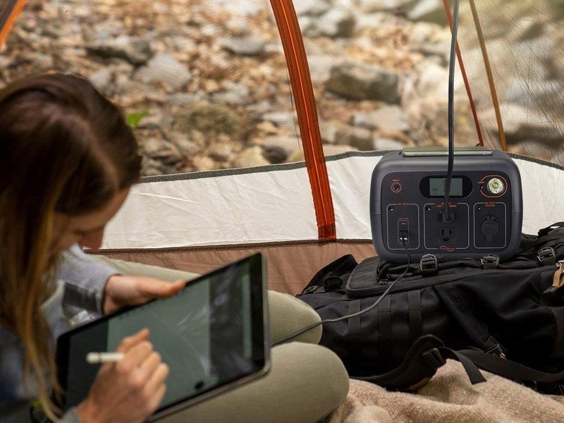

This summer, my family and I started doing a lot of camping, and so when I was asked to do an Anker Powerhouse II 400 review, I couldn't have been more excited. While high capacity portable chargers are becoming more ubiquitous these days, even the best battery packs won't match a capacity equalling 108,000mAh or have the flexibility of ports.
The Powerhouse II 400 is a 300W, or 388.8Wh, charging station that can power up to eight devices at once with various charging ports — including a DC car socket, 110V AC plug, and of course, USB ports. I have used Powerhouse to charge my laptop and phones, run a fan, even keep a powered cooler running for hours while on the way to our camping destination.
Once we made it to our camping location, as the sun was setting, using the Powerhouse's built-in LED flashlights was great to help get everything organized before we settled in for the night. The Powerhouse II 400 can power anything plugged into it so long as you keep the output under 300W, so no running your fridge with it. While there is a lot to like about this device, it isn't perfect — so let's get into some more details.

You can charge up to 8 devices simultaneously with the Powerhouse II 400 from the USB-A, USB-C, DC car socket, and an AC outlet. The front of the unit has three buttons that allow you to control when outlets are using power from the Powerhouse manually. That kind of flexibility is great to have on-hand, allowing you to carry fewer power supplies.
The AC outlet, house plug, can pump out up to 300W of power with a pure sine wave inverter. This output means that it doesn't cause electrical interference or noise when powering things like speakers, TVs, lights, and more. This is important to not only your sanity of not watching flickering lights but also to the health of the item plugged in as "dirty" power can damage it.
