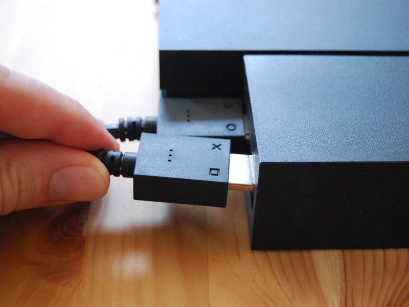

Before you start playing games, you have to physically set up your PSVR with your PC.
  1. Plug an HDMI cable into the PS4 HDMI port on the processing unit.
  1. Plug the other end of the HDMI cable into an HDMI port on your PC.
  1. Plug a USB to Micro-USB cable into the processing unit.
  1. Plug the other end of the USB to Micro-USB cable into a USB port on your PC. Use USB 3.0 if at all possible.
  1. Plug the PSVR head-mounted display into the processing unit.
  1. Plug the processing unit power cable into a power outlet.
To power on your PSVR, you can hit the power button on the PSVR inline cable remote.
