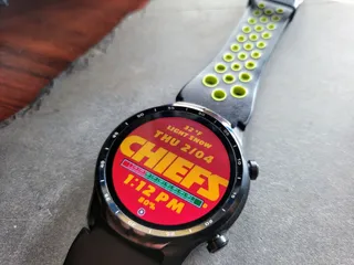

Use a battery-efficient watch face
You can find an unlimited number of watch faces to customize your smartwatch to your liking but, until developers get on board with the new Watch Face Format from Google, many of them could be draining your battery needlessly.
Using the built-in watch faces that ship with your watch will give you the best result, but some of those can be boring. If you're looking at a third party watch face store like Facer, Pujie, or Watch Maker, look for faces with the following qualities:
- Lots of black space. OLED display pixels are completely off when pure black is displayed. More black pixels = more battery savings.
- Fewer animations. Watches with lots of animations needlessly use CPU power and drain battery.
- No built-in apps. Some watch faces have features like a built-in calculator or calendar. These are handy but can drain your watch's battery as if you were running an app all the time.
- Lower weather refresh rate. Some watch faces offer weather services that can drain your battery by checking for updates too often. Choose watch faces that use Wear OS's built-in weather service, instead.
