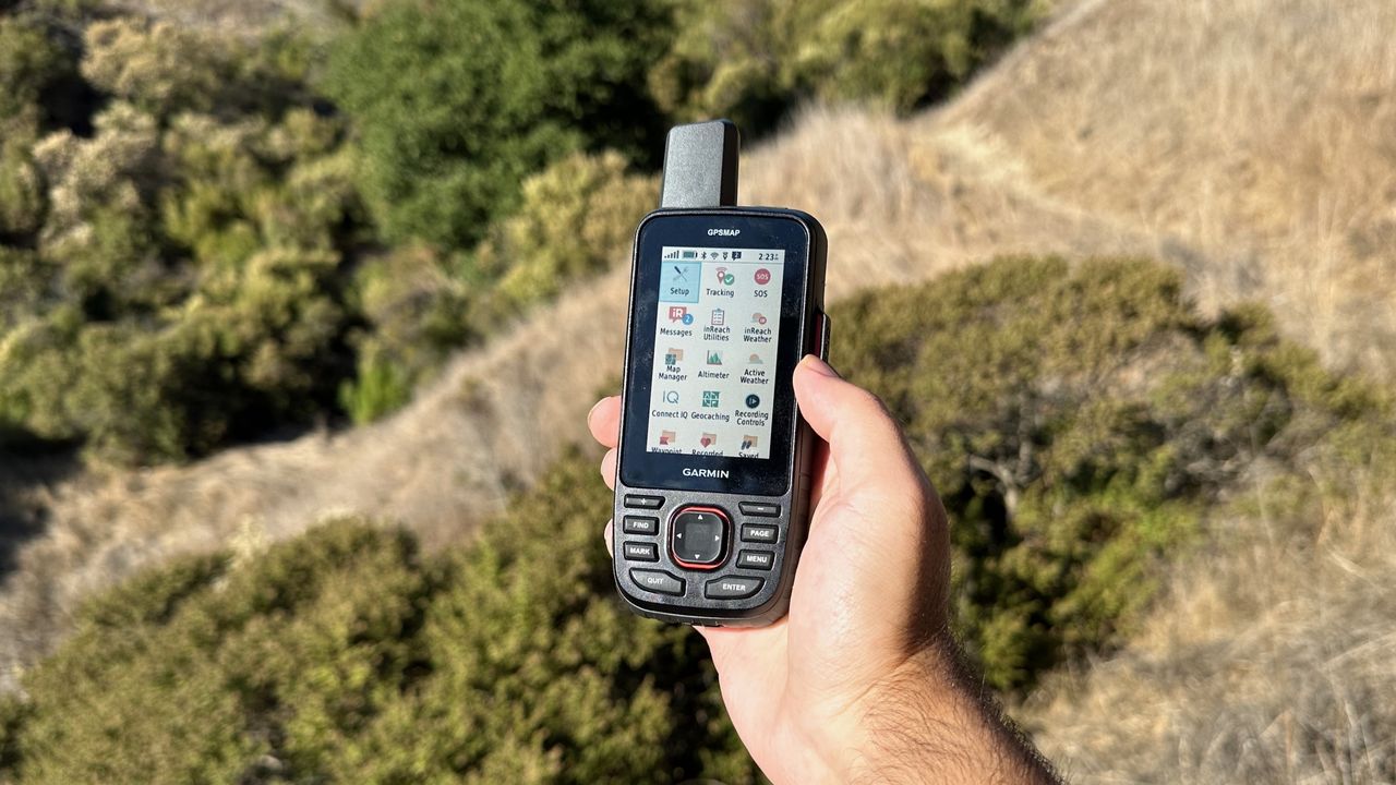

Straight out of the box, the Garmin GPSMAP 67i has straightforward functionality. Turn it on, and it will track your location and elevation automatically; it was actually a bit perturbing to realize it had "tracked" me for days when sitting on my desk, because its Expedition starts whenever the device is on.

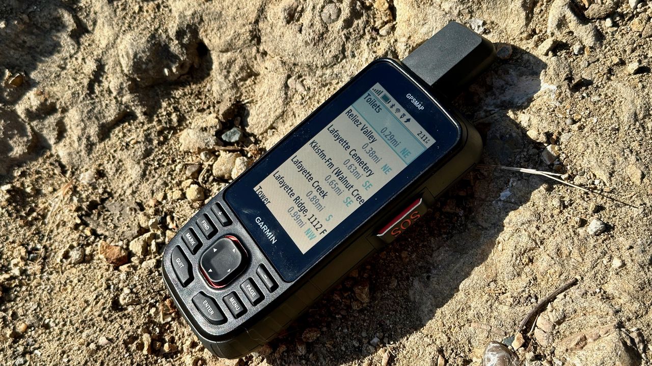

The GPSMAP 67i should come with a topographical map of your region, country, or continent installed by default. If you begin hiking, you can pull up the map and zoom in to see which trail you're on and any forks coming up next. You can also search for nearby places of interest, select them as your target destination, and follow along the route on the fairly small display.

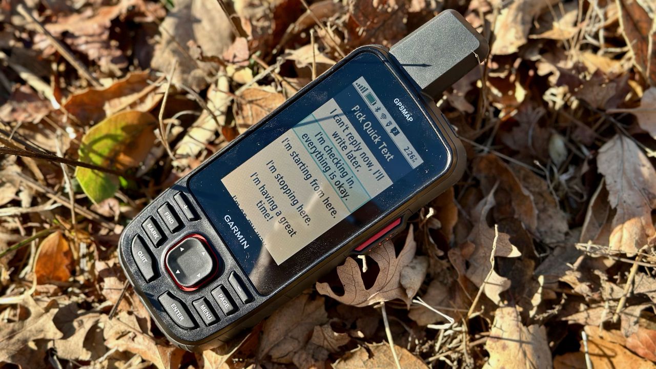

If you have an InReach subscription, you can start tracking and sharing your position via satellite, choose a moving interval between two minutes and four hours of how often it checks on your location, and then create a MapShare page where friends and family can track your progress and see where you are at every interval. That way, if you unexpectedly stop and don't manage to send an SOS, they know exactly where to send help.
If you are able, you can send an SOS signal by tugging off the bright orange "SOS" cover on the side, and then pressing and holding the button until the signal is sent. Garmin works with a 24/7 emergency response center that will send local rescue services to your location.

One somewhat frustrating aspect of using the GPSMAP 67i is that it pairs with four separate mobile apps: the traditional Garmin Connect app for Bluetooth setup, Garmin Explore to create Routes and Courses, Garmin Messenger to set up satellite messaging to send check-ins to family via the 67i, and the Connect IQ app to install custom data fields and widgets.
You can technically fulfill some of these functions on the device itself, but since it's somewhat slow and has no touchscreen, it can prove more frustrating than anything else. For instance, trying to create a custom route involves selecting from nearby landmarks or just dragging a cursor slowly across a map that usually can't keep up. As for messaging, you can send a quick text check-in or location update, or create a custom message by selecting letters one by one with the arrow keys — it'll remind you of your dumb phone days.

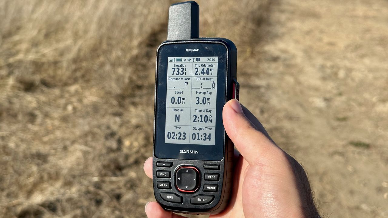

My first few days using the device can be summed up with the Ryan Reynolds "But why?" meme. Here's how the controls work:
  • The +/- buttons zoom in and out in map view
  • The arrow buttons navigate through the Main Menu or move the map cursor
  • The Find button pulls up different Waypoint categories and selects a destination
  • The Page button opens up and scrolls right through the Quick menu
  • The Mark button saves a waypoint of wherever you are on your map so you can find it later
  • The Menu button pulls up a settings submenu for each feature with one click or the main menu with two clicks
  • The Quit button is basically a Back button, but also scrolls left through the quick menu
  • The Enter button selects options
  • The power button hides key options like adjusting the backlight or turning on the flashlight.
It takes quite a while playing with the GPSMAP 67i before you unlearn habits that would be intuitive on other devices, but not here. For example, having to scroll left and right using the Page and Quit buttons (which aren't level with each other), while trying to scroll with the arrows immediately exits the menu or selects options you didn't mean to.
I eventually figured it out — my "I'm not smart enough" headline is mostly hyperbole — but it's still something that takes days (or weeks) of active use before it becomes intuitive and you start to memorize where every function is hidden through the menus and submenus. You simply have to decide if it's worth the effort.
