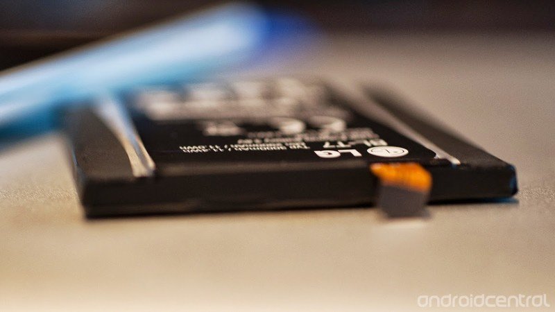

Phones aren't like cars, where changing the battery is as easy as disconnecting the old and connecting a new one. They used to be, but thinner phones and higher battery capacity demands meant that they are now small foil bags sealed up inside your phone. They are designed to last a specific number of charge cycles, and a charge cycle is taking the battery from its lowest point to its highest. It's worth noting that this doesn't mean zero to 100, even though the phone will report it that way. Batteries are designed to be used at 80% of the listed capacity (but still safe up to 125%) and never brought down to a zero-charge state. The circuitry inside your phone takes care of that and makes it simple for us by reporting the scale to 0-100.
The number of charging cycles that a battery is rated for is an approximation; the reported number is based on an average. There are ways to "game" the system when it comes to charging cycles, and you've probably seen advice that says to charge your phone a certain way to extend the usable life of the cell. These do work, but you won't be able to get too much extra life from your phone's original battery, so it may not be worth it. You have to decide if micromanaging the way you charge your phone is worth another two or three months of life.

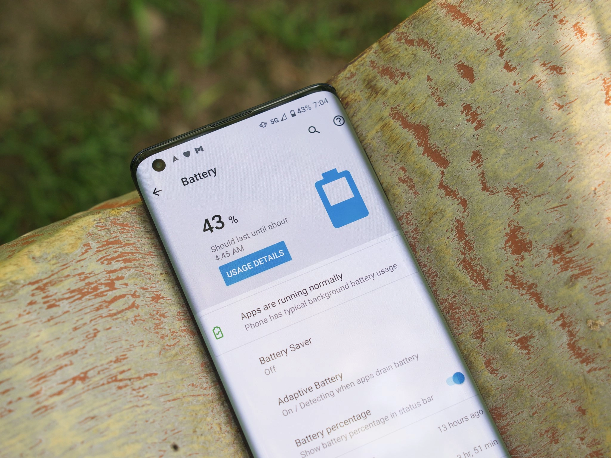

You might notice when your battery is going downhill because it rapidly discharges while you're using it. If you used to go half the day and your battery was still at 60%, for example, and it now hits 30% during the same time, it's a sign that the battery is starting to sour. Other things like bad apps or a bad update can do this, too, so it can be tricky to diagnose.
Your phone's battery will most likely die a slow, noticeable death.
You'll also notice that it won't charge completely. No matter how long you leave it plugged in, it never says it is fully charged — because it's not. It can't hold enough electrical energy to register as full by the electronics in your phone because the materials inside have degraded enough to affect performance.
One of the first warning signs is your phone losing charge right away. If you take your phone off the charger when it says the battery is at 100% and it immediately drops to 90% or 80%, the battery is getting a bit old. It's normal for some phones to lose a few percentage points of battery charge right away (at least according to the battery gauge), but a drop of 10% or more is a sign of a problem.

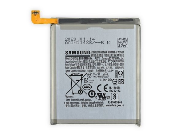

You used to be able to go online or take a trip to the carrier store and buy a new battery for your phone. Those days are gone, and I doubt they will ever come back. But the battery in your phone probably can be changed by someone who knows what they are doing.

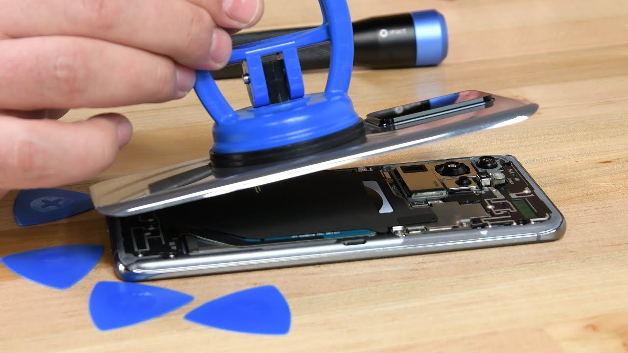

Changing the battery in a sealed phone isn't hard for people who know what they are doing. Most of the time.
Most of us aren't that person. Changing a phone battery isn't hard on most models, but the way you open the two halves of a phone can be a little tricky. There may be hidden screws, plastic clips that are designed to never be unclipped, and there will be adhesive. Lots of sticky adhesive. I can change the battery on some phones here at my desk with a handful of simple tools. Other phones I could never open without breaking the screen. I know because I've done it. Unless you're still using something ancient like a Nexus 4 or iPhone 4, forget changing the battery yourself unless you've spent time fiddling with — and breaking — electronics.
