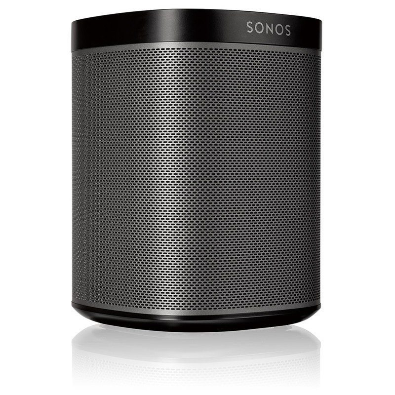

Sonos Play:1
The Play:1 is the smallest Sonos in the series, offering great sound with plenty of bass. The tiny footprint makes the Play:1 a good choice for rooms that are short on surface area.
A threaded mount is on the back so you can pop the Play:1 onto a wall. That's a particularly helpful feature when used in concert with a Sonos Playbar for coordinated TV surround sound.
