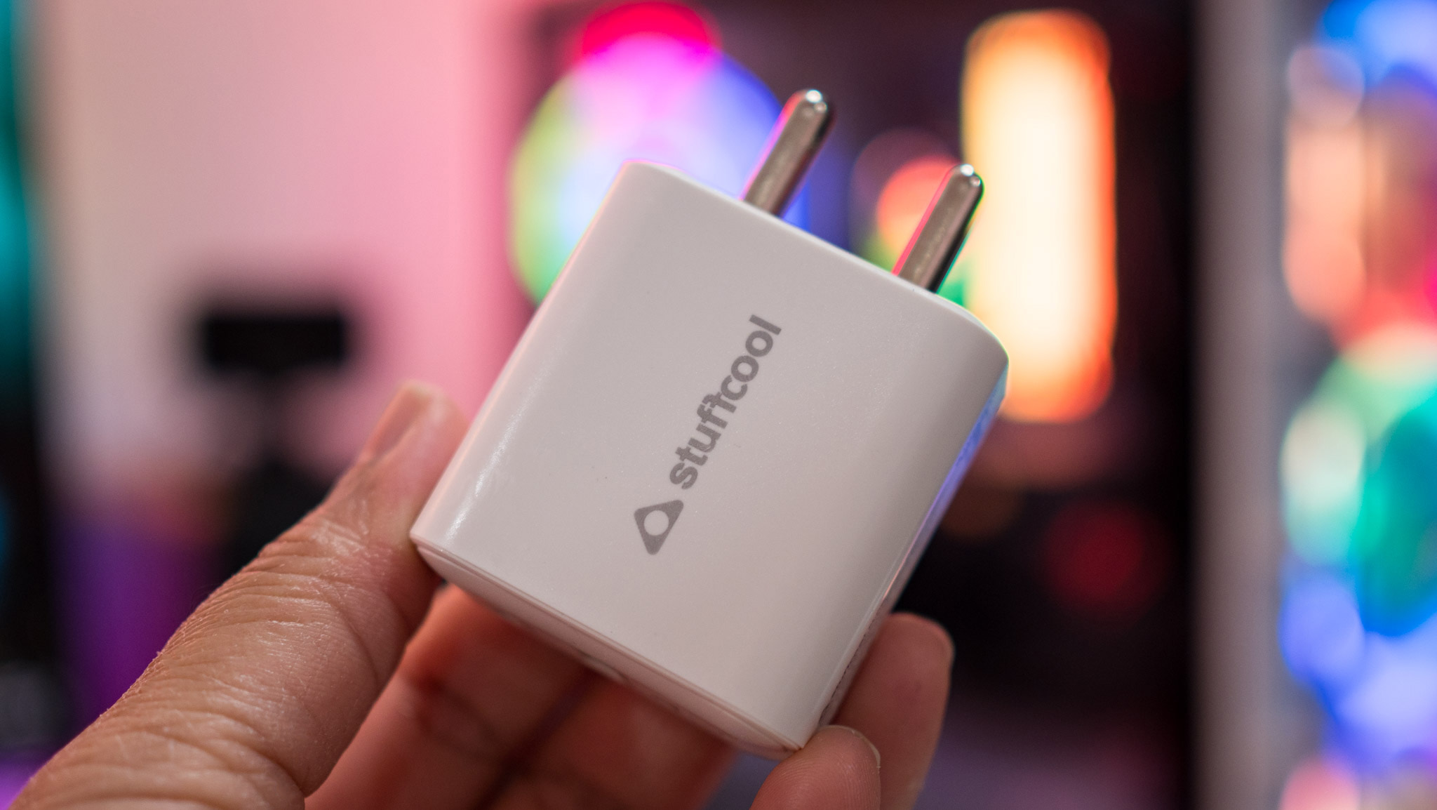

The Flow has two charging ports — a USB-C and a full-size USB-A port — and it works with USB PD and PPS over the USB-C port to deliver 25W of power, and the USB-A port works with Qualcomm's 18W fast charging protocol.
Stuffcool Flow 25W
(Image credit: Harish Jonnalagadda / Android Central)
The charger falls back to 15W when both ports are being used simultaneously, and this is in line with other chargers with two ports. The Flow 25 is made in India, and the design itself is similar to Stuffcool's other chargers.

The Flow 25 isn't a GaN charger, so it isn't quite as diminutive as the Neutron, but it isn't bulky either. The build quality is sturdy, and it has managed to deliver a consistent charge in the month I used the Flow 25.
