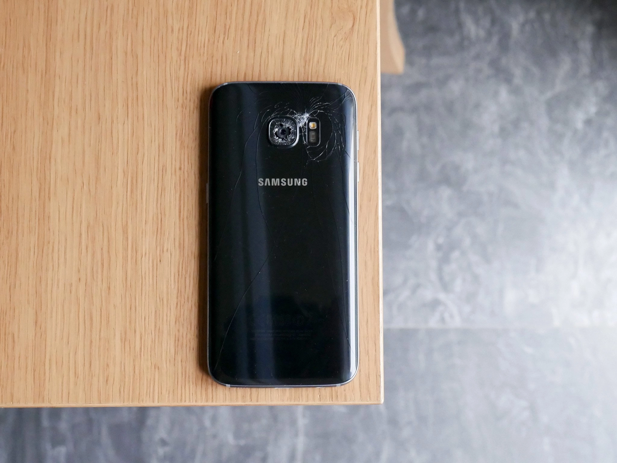

That's exactly what happened to my Samsung Galaxy S7, and while the Galaxy S8 is here and the Galaxy S9 won't be too far away, the S7 is still a very good phone worth saving.
Replacing the front glass is a different story, but if all that's wrong with your phone is some shattering on the back, you can fix it yourself relatively quickly and very cheaply.

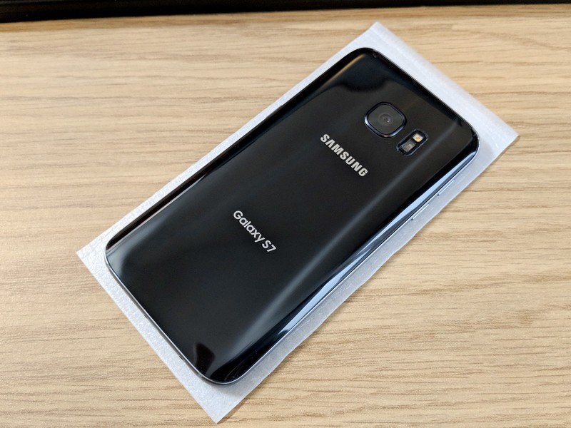

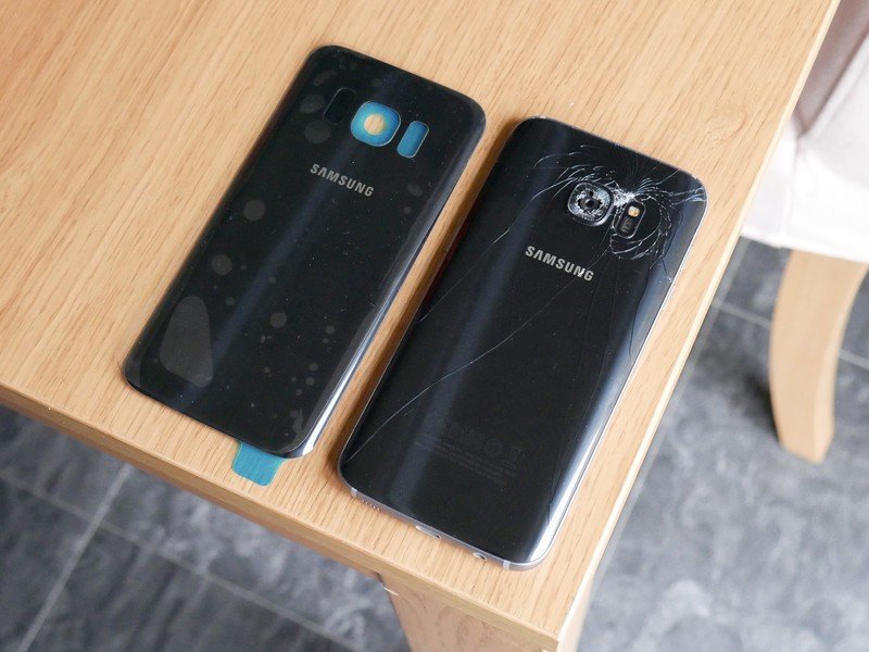

Obviously, the first thing you need is a new back. These aren't particularly expensive, and I got mine from Amazon for about £20 ($26). This also included a basic tool kit, which includes some small screwdrivers, a suction cup, and some plastic pry tools. You may or may not need to use these as you'll see later on.
When choosing a back, also make sure to choose one with adhesive pre-applied. Because otherwise you'll have to do this yourself and it's honestly not something you should have to deal with. They're no more expensive with adhesive, just be sure to choose the right one.
It's also worth noting that there will be a bunch out there that aren't the exact Samsung replacement parts. The one I linked above is the same exact back I used in this guide and while the black color match is perfect, it doesn't make it an OEM part. I'm fine with it, but if you're not then be sure to hunt down a genuine Samsung part.

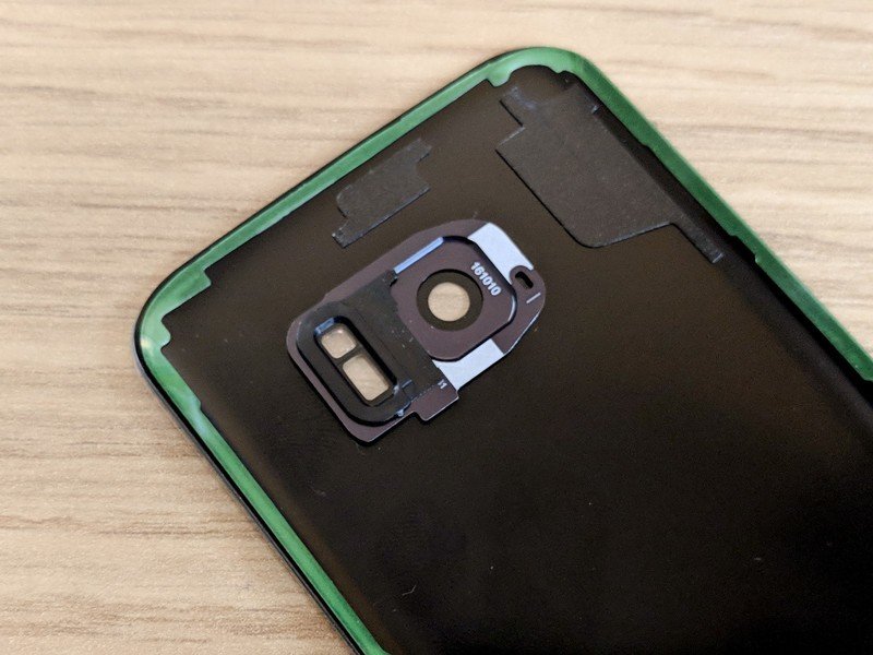

I also recommend acquiring a replacement camera lens and housing. You don't need to do this, but you'll have to remove it from the old back and adhere it to the new one. It's also pretty easy to bend, so for the few bucks it costs for one of these it's worth doing. You'll also get some fresh adhesive so it's easy to apply.

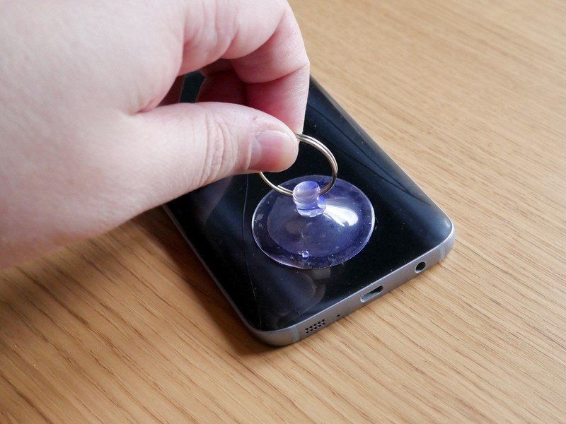

- Apply heat around the edges of the phone to soften the existing adhesive. It helps to focus on one area first that you intend to pry the back up from.
- Using a suction cup or a pry tool, work the back away from the phone on one edge.
- Don't expect much, all you're trying to do first is get a small area to separate so you can move on. In my case, I ended up using a very small flathead screwdriver on the damaged corner.
- Once you have an edge to work with, insert something stiff, like a business card, to keep it from settling back down on the phone.
- Repeat the steps above to heat, lift and separate the back from the phone, being careful not to damage anything inside the phone.

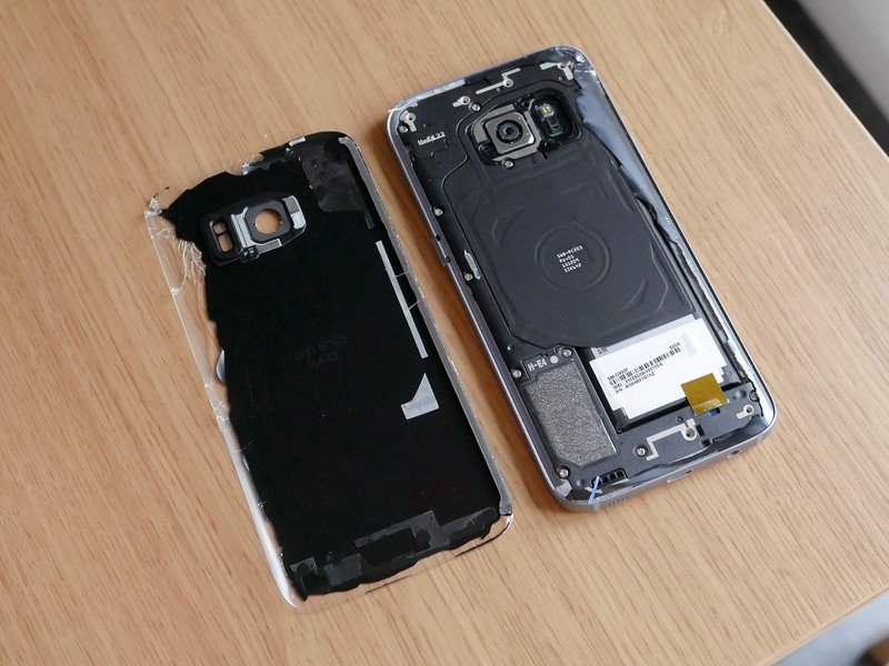

When you've pryed the back off entirely you'll be looking at something like the image above. Ensure you've removed all the adhesive and any colored film that came away from the phone before you move on.

- First, attach the camera lens and housing to the new glass back. It's impossible to get it in the wrong place, just make sure to press it down and that it has a nice tight seal.

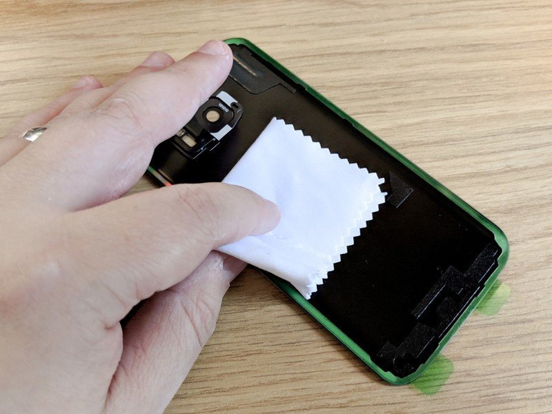

- Wipe down the inside surface of the new glass back. This is the last chance to remove any grease or dust before it goes down on the phone.
