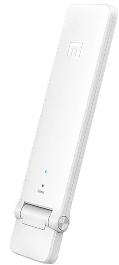

- Amazon: Xiaomi USB Wi-Fi repeater ($12)

This method involves using a USB Wi-Fi repeater with a built in amplifier as a go-between. The Tello connects to the repeater, then the repeater connects to your phone giving you not only smoother FPV but greater range.

Next, grab your USB battery pack and the Xiaomi Wi-Fi repeater.

- Tap on nearby devices and the app should show you the Wi-Fi repeater.
- Tap on the repeater icon to connect.
- When prompted to connect to another router, tap your Tello.
The app will now finalize the connection and will likely "fail" at the final step. If the light on the repeater is blue, all is well and you can ignore this message.
Now the repeater is linked to the Tello's wireless connection. You won't see the repeater listed in the Mi Home app and you'll never have to go into it again unless you need to reconfigure. The final step is to put it all together. This is what you'll do now every time you want to connect to your Tello using the repeater.

Extending the range of your Ryze Tello is simple and very cost-effective thanks to the Xiaomi USB Wi-Fi repeater.
It's such a simple product but its results are extraordinary. The video transmitted to your phone will be crisper and your drone will be able to fly futher thanks to the amplifying effects of this little dongle.
