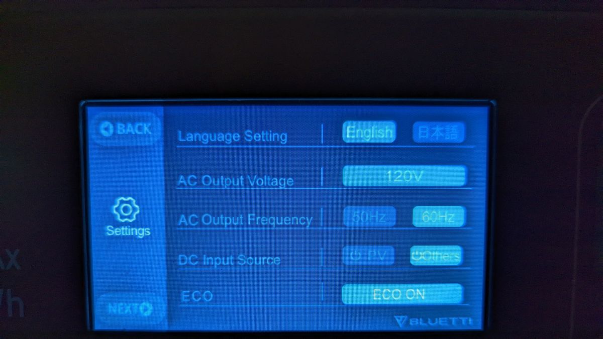

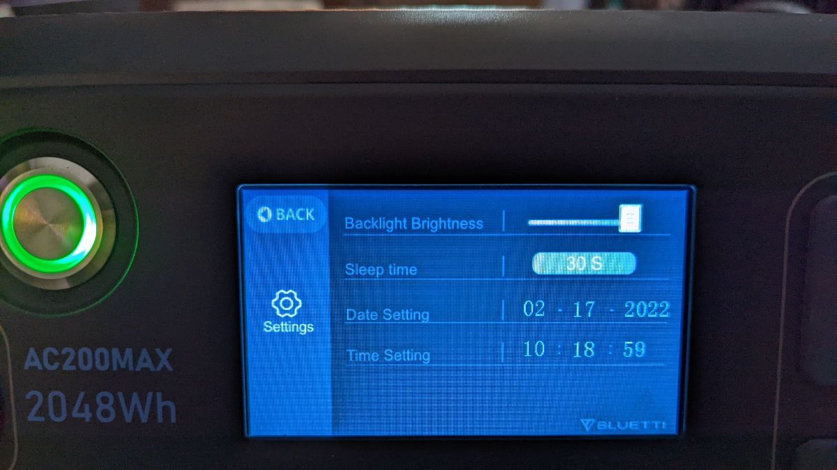

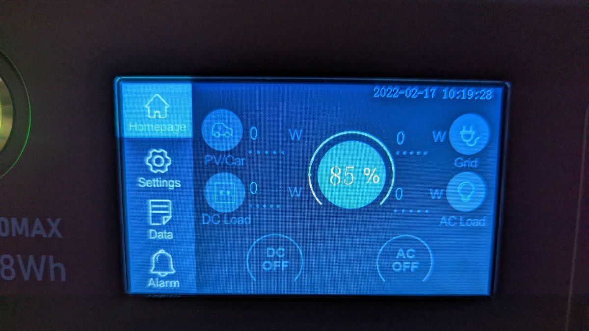

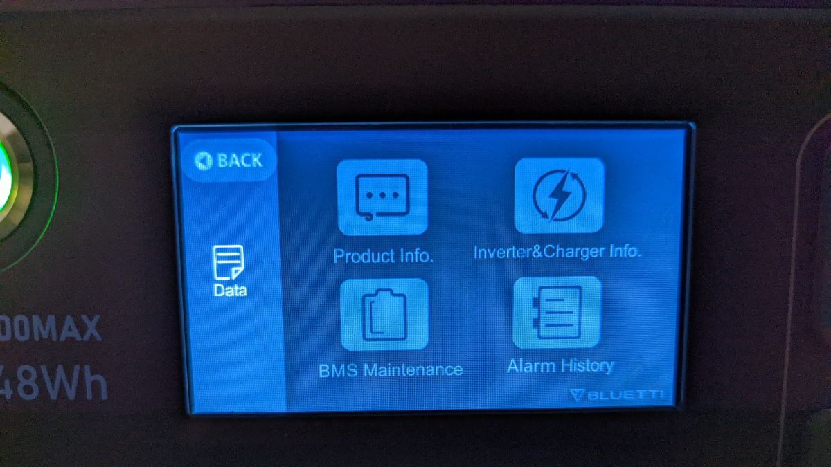

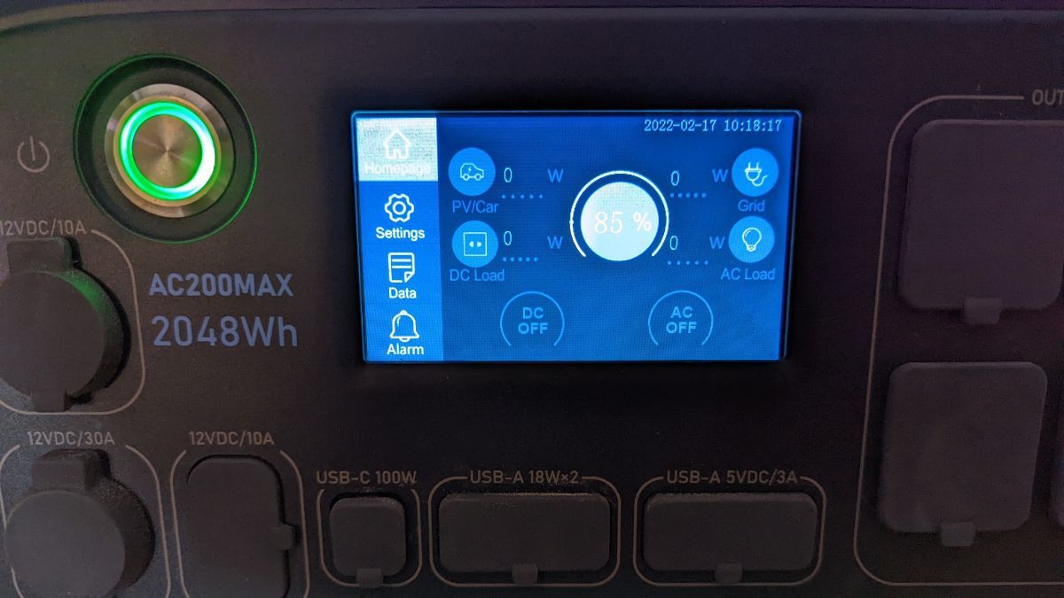

The output ports are right on the front, flanking the 4-inch LCD touchscreen display. To some, going with a resistive touchscreen rather than capacitive like smartphones could seem negative. However, from a practical perspective, it's great. This is because it means you'll be able to use it even if you have gloves on or wet fingers — the controls will still work.

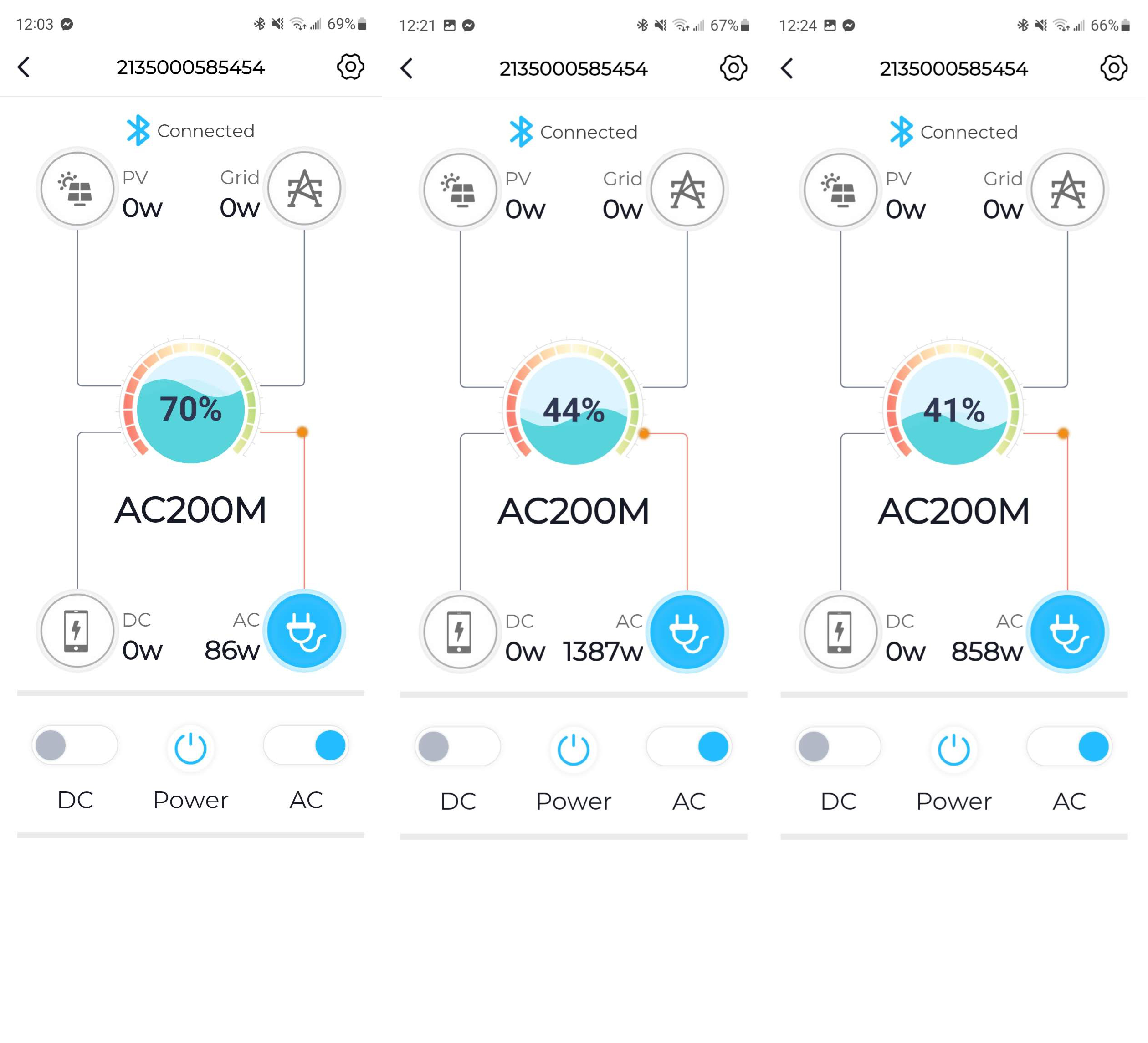

These fridges average around 1,100W surge combined when the compressors fire up, and by the time we stopped for the night after approximately 14 hours of driving, the BLUETTI AC200MAX was at about 65% charge remaining. Once we finally reached the beach and set up our spot about 30 hours after starting our journey, the power station was sitting at 20% charge. I was delighted with how well the AC200MAX handled the trip.
Back at my home in Kansas, I have used the AC200MAX to run power tools such as my miter saw, circular saw, and drills. Since it is very cold where I live in February, we had to use a heater in the trailer when it was time to clean up the camper from our beach trip. Plugging the camper into the AC200MAX using the 30A RV plug — without an adapter — is so nice. We could power our 1,400W heater and a small ShopVac with no issues.

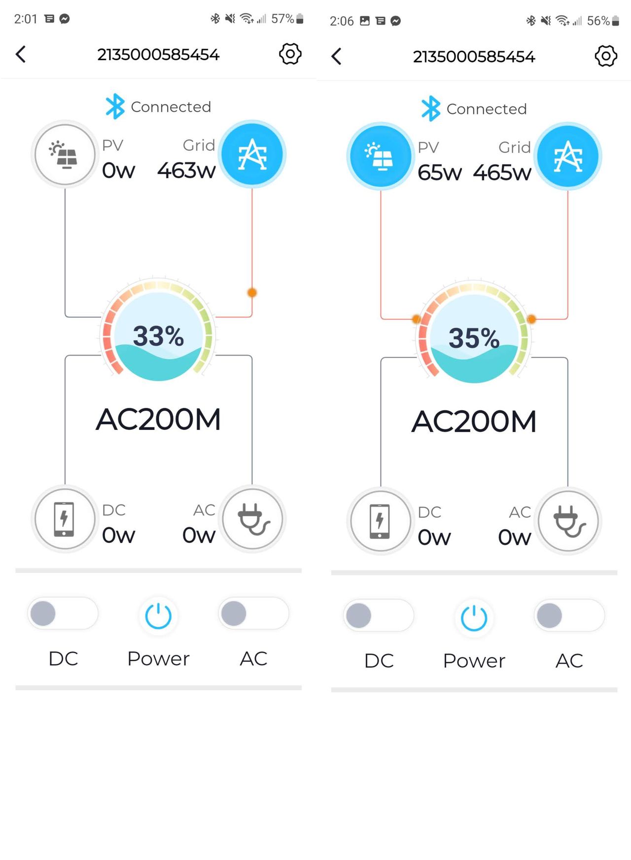

When it comes time to recharge the AC200MAX, many options are available. As mentioned for the input ports earlier, you can plug the included 500W AC adapter directly into the unit. The DC car adapter will plug directly into the unit with the included cable. But solar will use two cables, both included, to connect to the power station.
The companion is great to have, but I do wish it connected via Wi-Fi along with Bluetooth.
The BLUETTI AC200MAX can take in up to 900W solar power and pair with the 500W AC adapter. You can recharge the unit from zero to full in about 2 hours by combining the two input options for 1,400W. Using the AC alone will take around 5.5 hours to get your BLUETTI AC200MAX back to full.

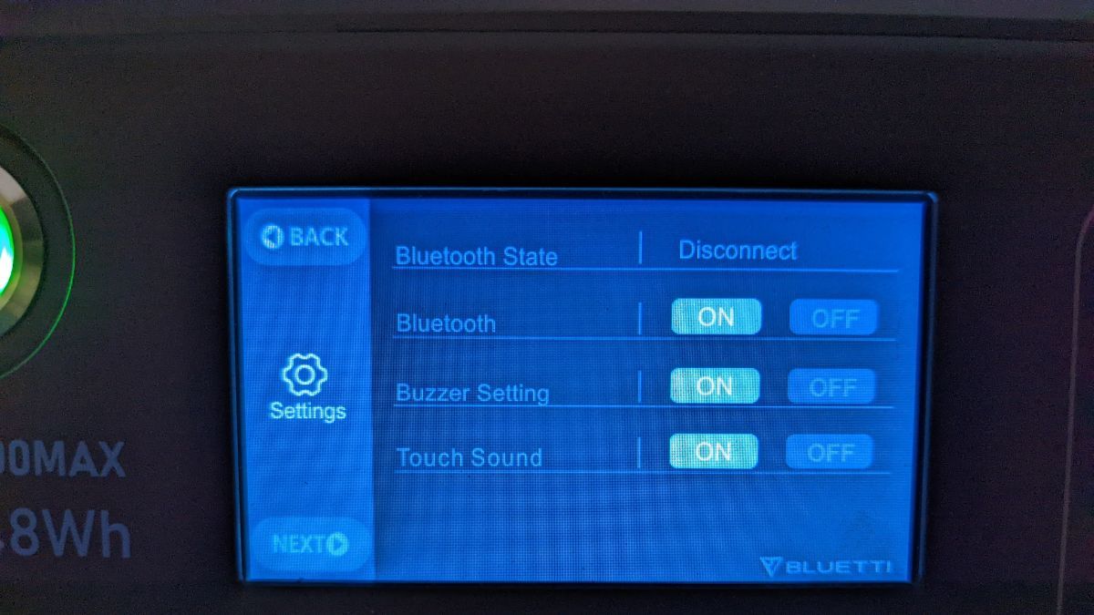

Controlling the BLUETTI AC200MAX is done in two ways: the unit's touch panel or the companion app. The power station has to be powered on with the satisfying clicky button beside the display to use either method. Once it is on, you can navigate through the unit's menu to change various settings and enable the DC and AC output ports.
You can use the BLUETTI companion app to update the AC200MAX's firmware along with some basic unit controls. You can turn on and off the DC or AC power options and turn off the power station itself. Since it uses Bluetooth for connectivity, you won't be able to control the power station from a long distance as you would if Wi-Fi was an option.

Another area that could use some improvement is the display. Though I like that it uses resistive instead of capacitive technology for the touch screen for practical use, it loses some of that practicality when you can't read it. In moderate to low-light situations, the screen is easy to read. But once in brighter environments, like outdoors, you're going to have to use your hand as a visor to see what's on the screen or make changes to the unit.
