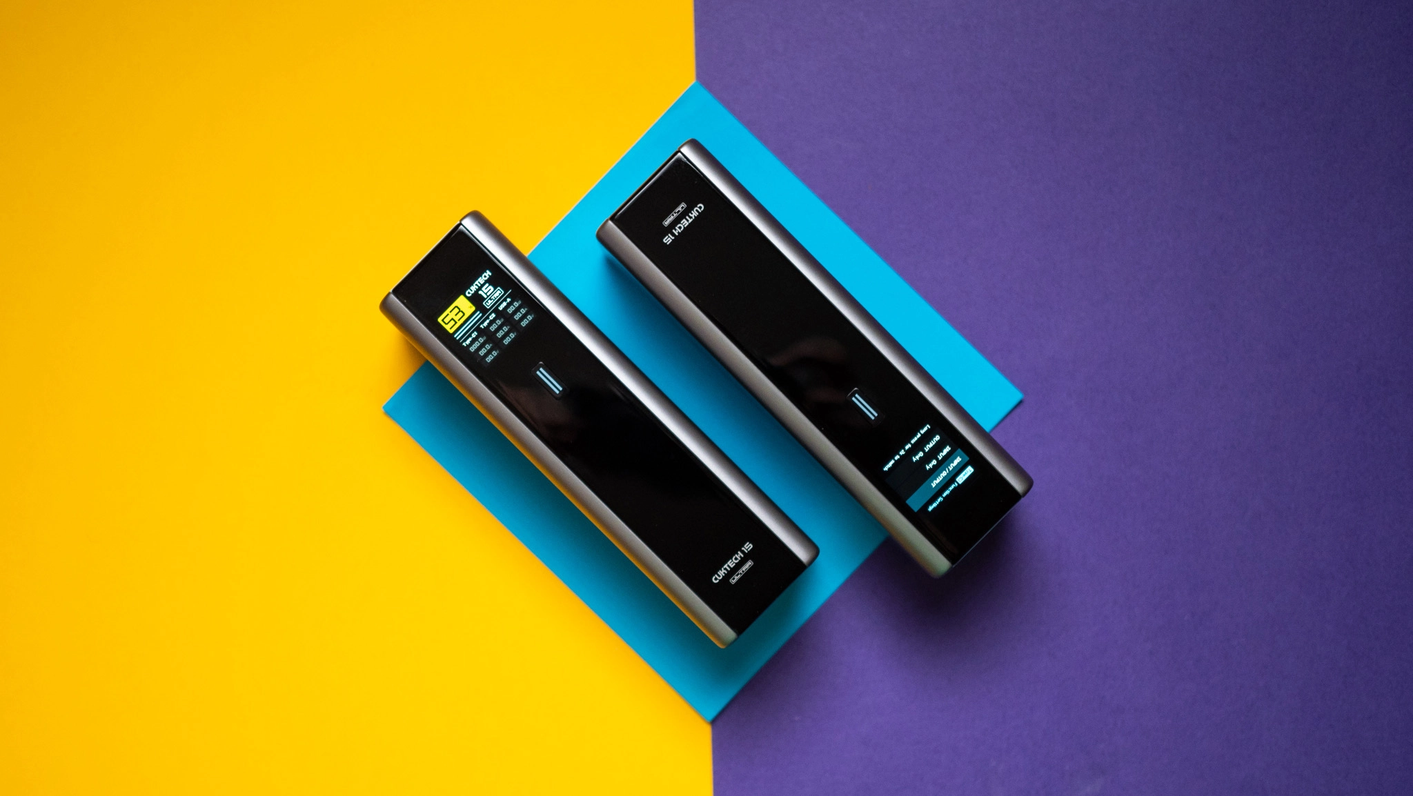

Before we get started, a note on the naming; Cuktech says it chose its name because of the Čuk DC-DC converter architecture, named after Slobodan Čuk. With that out of the way, let's talk about the design. Similar to Anker and UGREEN, Cuktech went with a vertical profile for the power bank, and it is absolutely the right move — it makes the 15 Ultra that much more portable.

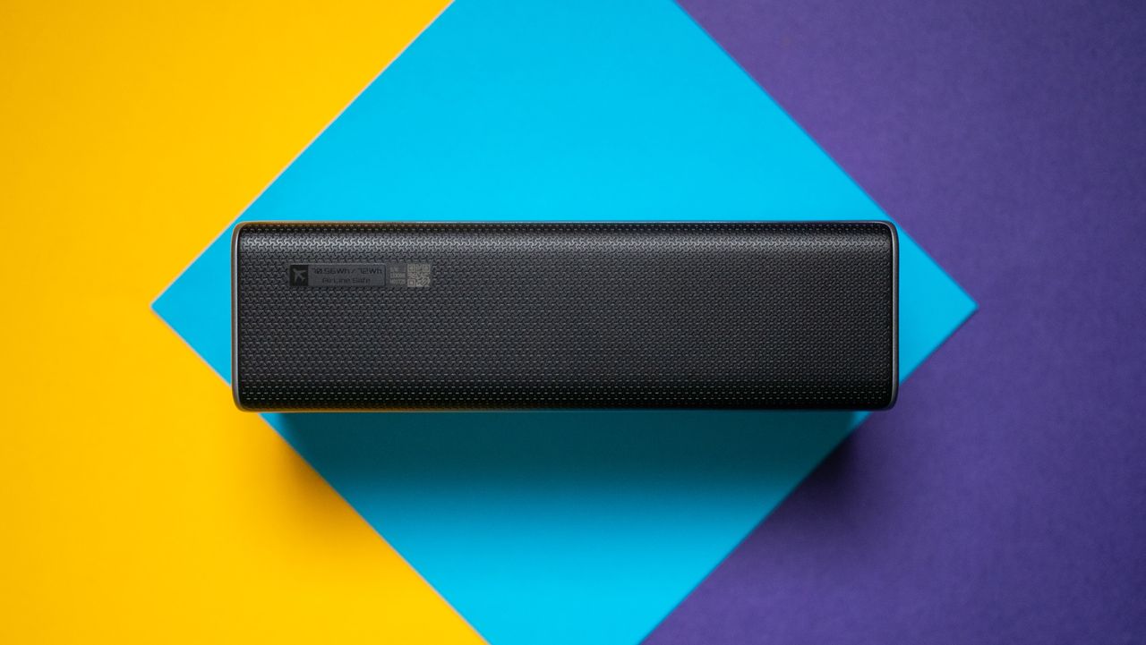

There are other niceties; the grey color scheme with the black front looks clean, and the back has a textured finish that makes it easy to hold the power bank. I don't have any issues with the design of the 15 Ultra, and Cuktech did a good job in this regard.

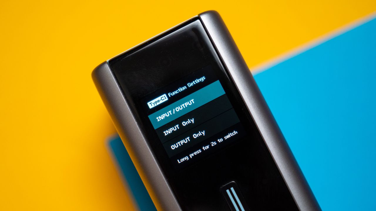

There's a button up front that activates the panel, and you get to see battery life, time to charge devices, and real-time charging metrics on the same page. Ideally, Cuktech should have pushed the real-time charging details to a secondary page as it makes the panel look a little cluttered, but that's a minor quibble. You get all the information you need, and that's what ultimately matters.
