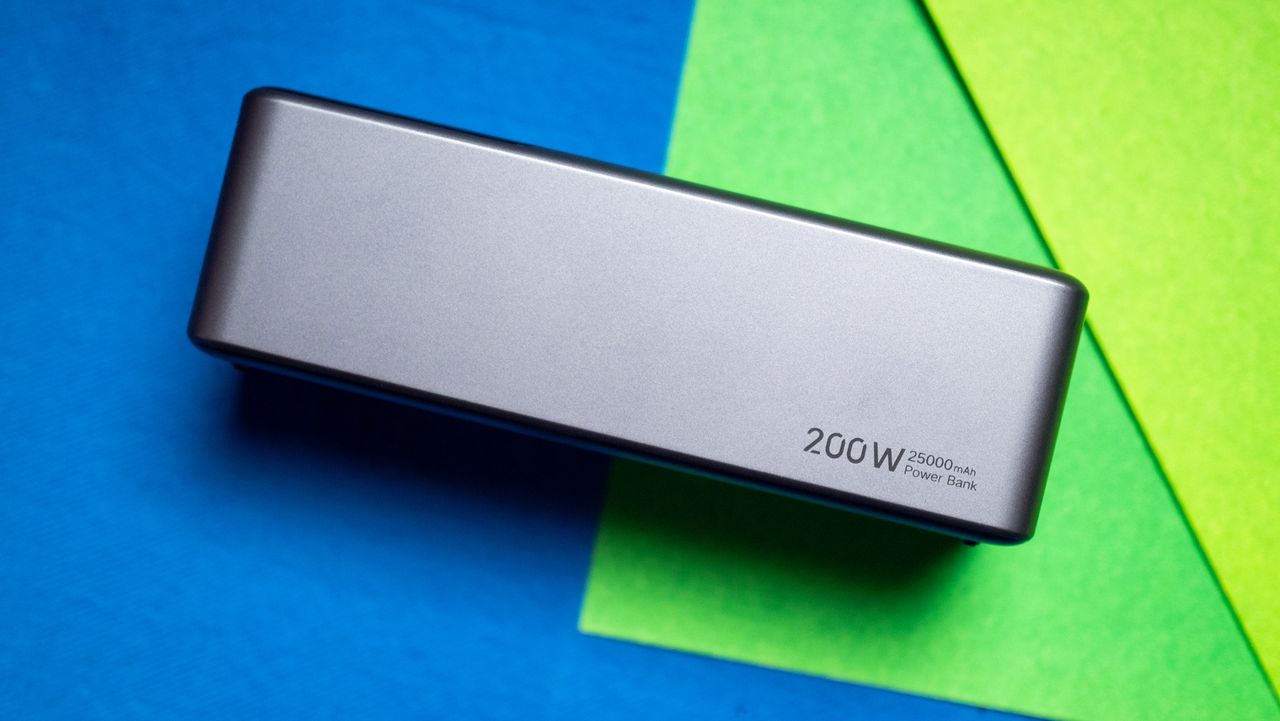

The version that I'm looking at is the 25000mAh option; it has two USB-C ports and a USB-A port, and it can hit 200W when both USB-C ports are in use. The 25000mAh power bank costs $99, and UGREEN is effectively trying to undercut its rivals.

UGREEN's initial power banks had a traditional design, but the Nexode Power Bank switches to a sleeker design that's much more portable. The rectangular chassis makes it highly convenient to carry the power bank, and at 609g, it isn't that heavy either. The power bank consists of five 5000mAh cells housed within the chassis, and there are the usual safeguards against overcharging and overheating.

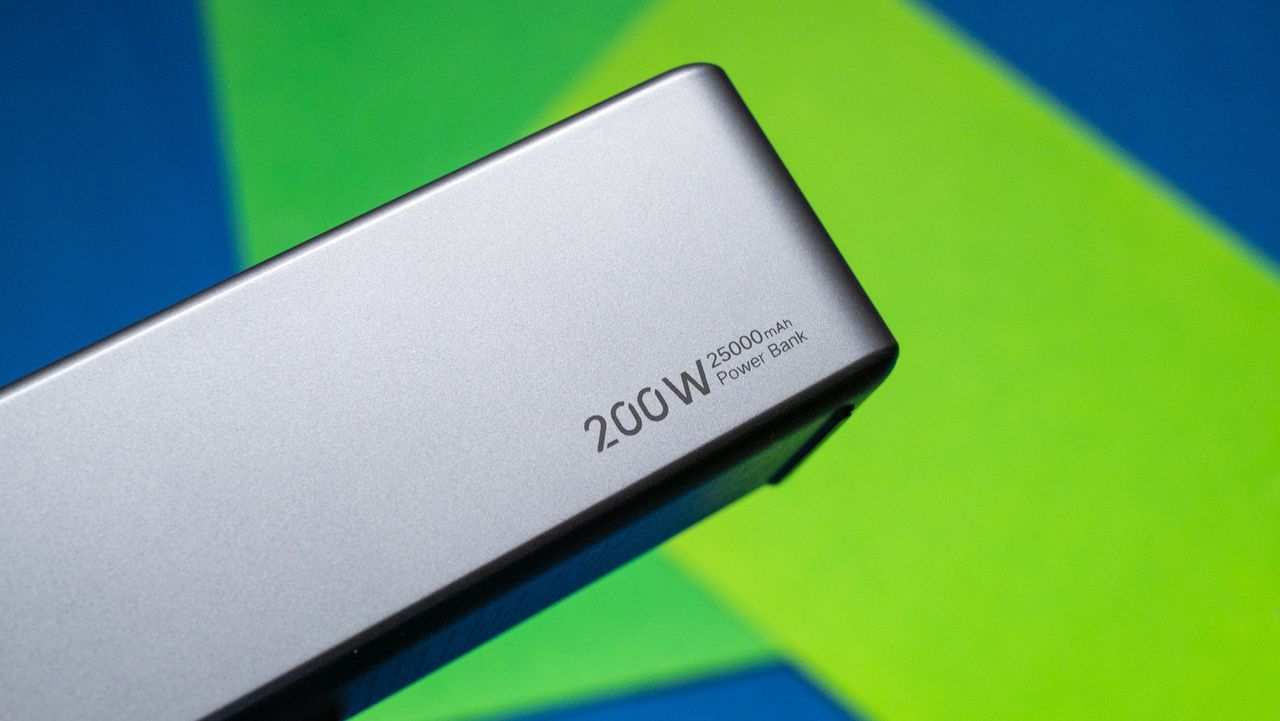

The chassis itself is made out of plastic, and the build quality is fantastic — I didn't see any issues in the month I used the power bank. The only issue I have in this area is that the back and side — where the charging ports are located — have a plain black design instead of the grey color scheme, and this deters from the overall effect. Outside of that, the design is similar to what Anker offers on its Prime series, and it's great to see other brands switching to this aesthetic.

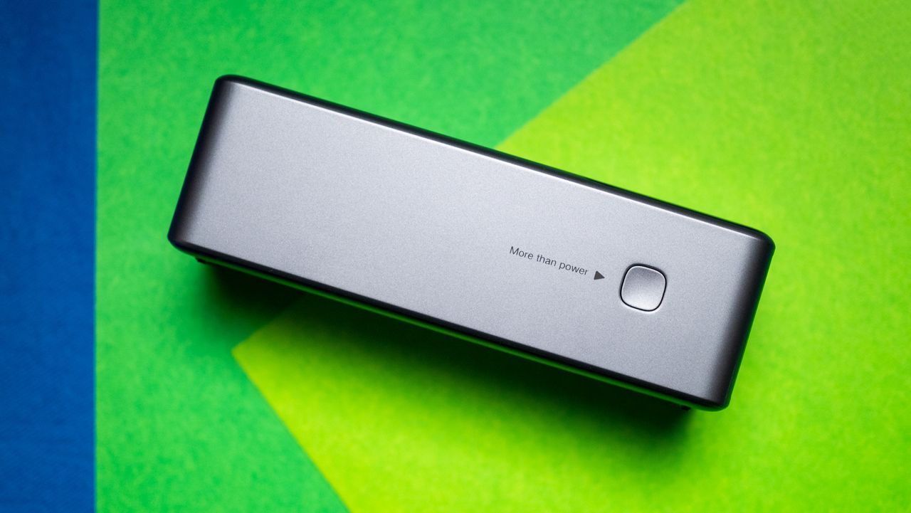

I also like that the power bank has rubber feet on one side, ensuring it doesn't slide on a desk. This makes a noticeable difference when plugging in a cable, and it's a decent addition. There is a power button on the side that activates the TFT panel, and you can see the battery level of the power bank, real-time charging status of each port, and remaining charge time.
