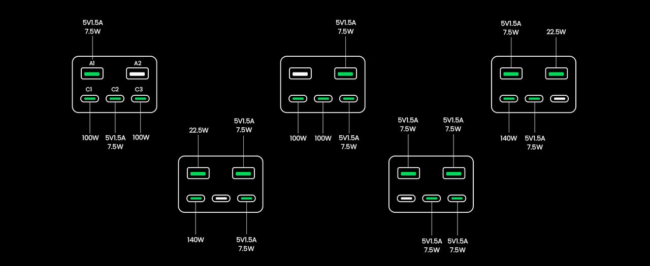

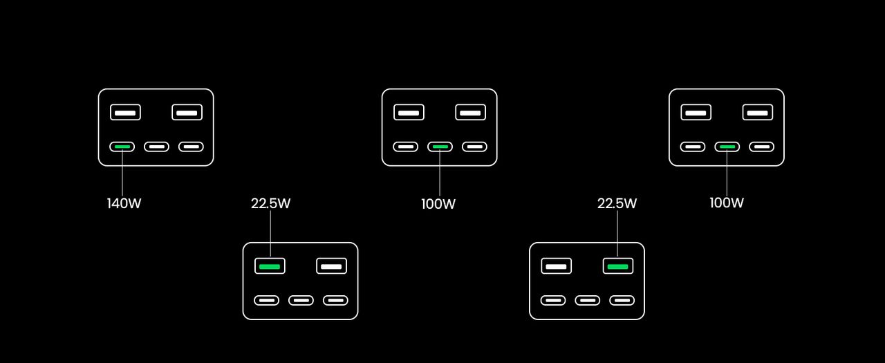

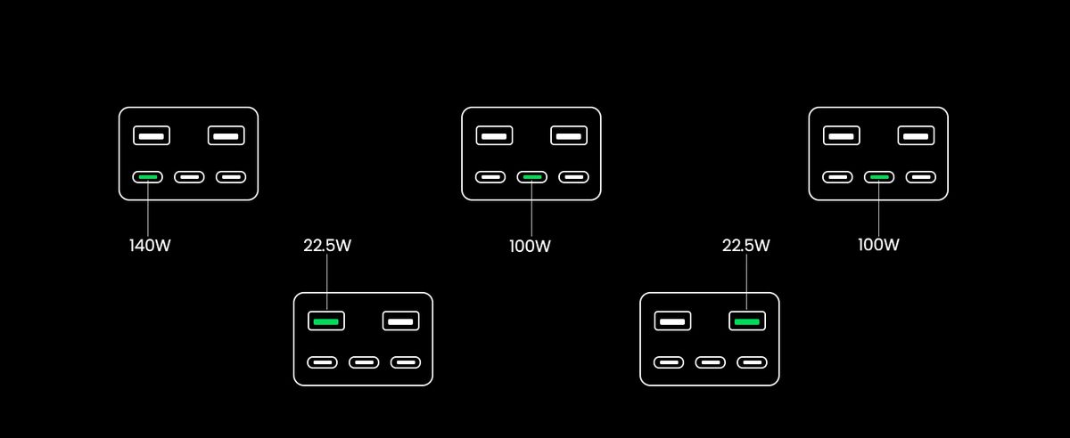

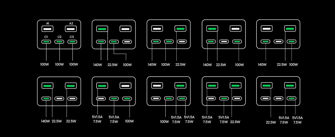

The 48000mAh Power Bank includes two USB-A ports — with each going up to 22.5W — but it's the three USB-C ports that will get the most amount of use. All three are based on the USB PD 3.1 standard, and two ports go up to 100W. The main USB-C port is the default way to charge the power bank, and what's great about this port is that it hits 140W. You can not only charge the power bank at 140W, but also use the port as an output, giving you the ability to charge just about any device.

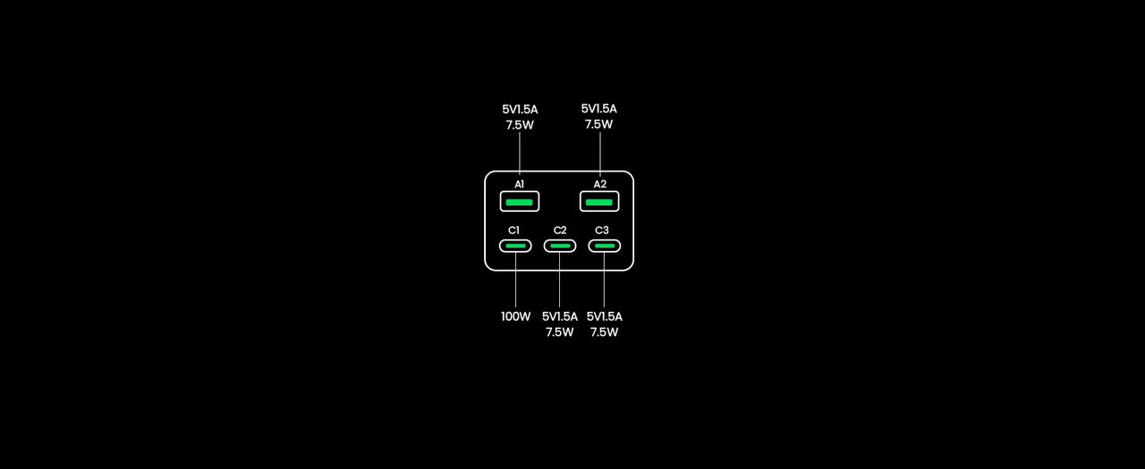

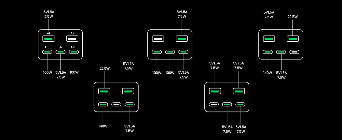

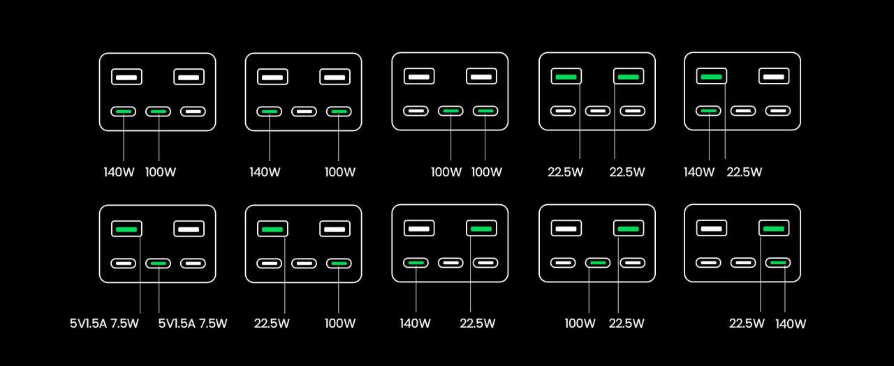

There are five charging ports in total, and you can use the 48000mAh Power Bank to charge up to five devices at the same time. The power budget varies significantly based on how many devices are being charged simultaneously, and with all ports in use, you get a total 130W of addressable power. The best use case is to use the three USB-C ports at once, and in this scenario, you get 300W — 100W via each port.
