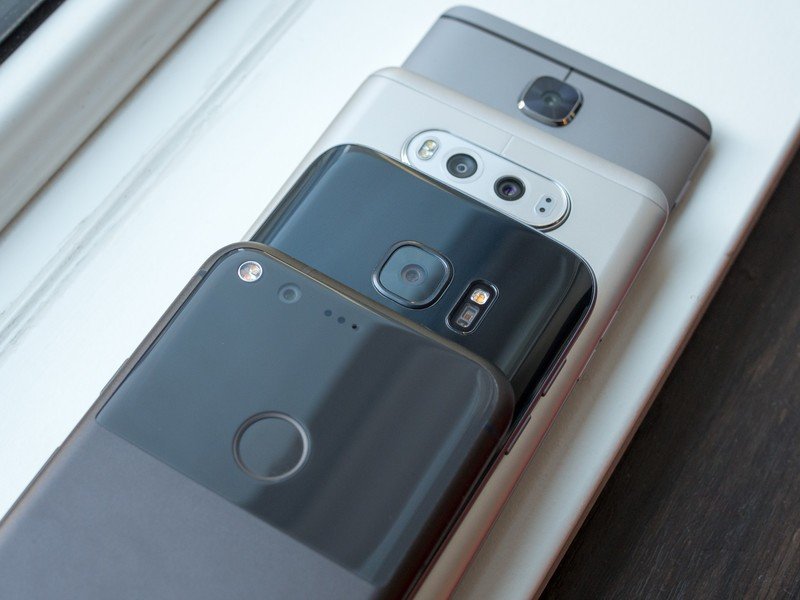

Android Cameras
We all have used a crummy smartphone camera and tried to take a picture without enough light. It ends up being a dark, yellow mess that's not a great way to capture the moment on any level. We've seen the same when we use the flash on a smartphone camera to try and fix it, then everything turns a weird ethereal bluish-white. This is because of the dynamic range of the camera.
The range of light that the camera hardware can focus on and capture is fixed. HDR fixes that.
A camera can only process a certain amount of light that's brighter than a threshold, and a certain amount that's darker. You can move the threshold, but you can't expand it to see more of one side without losing some of the other. If parts of the image are brighter than the allowable range, they are washed out and white. If parts are darker, they are black. If you make an adjustment to see more of the brighter light, more things turn black. If you do the opposite to see more dark things, more things wash out. The range of light that the camera hardware can focus on and capture is fixed.
HDR settings aim to fix this and give you a picture that has more bright things correctly exposed and more dark things correctly exposed at the same time. This is done by taking more than one picture when you press the button. Photos are taken (usually three or five, which is called bracketing) in quick succession and each has the exposure set to a different level.
