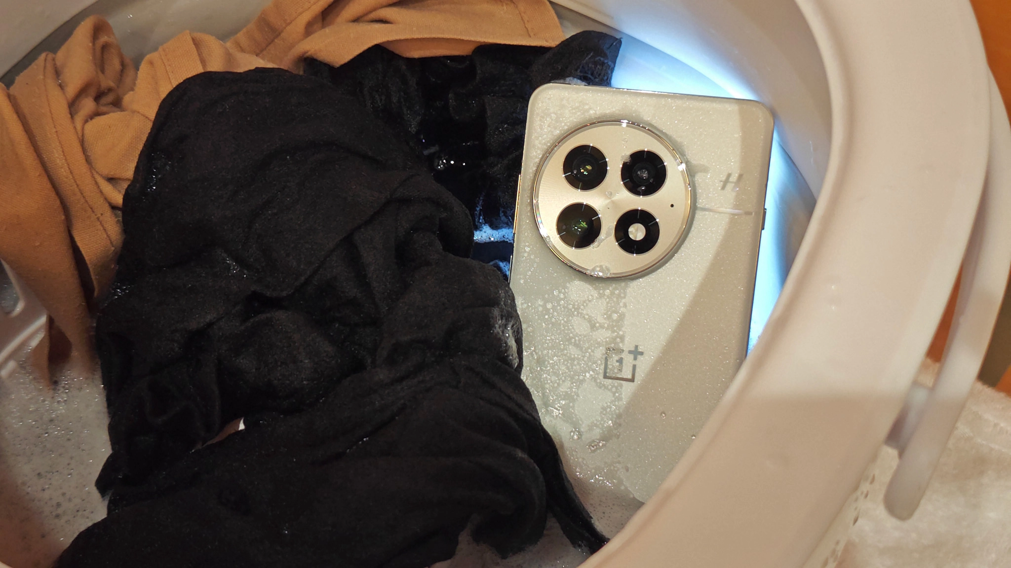

The IP69 certified white OnePlus 13 in a washing machine with clothes
For a while, smartphone water resistance was something we longed for — now it's the standard. Just about every Android phone released these days will have some level of water resistance. The level can vary by phone, and it's worth noting early that no phone is ever waterproof.
