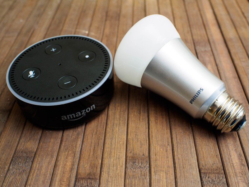

Alexa won't connect to other devices
One of the best parts about owning an Amazon Echo is using it as the access point to all the other smart devices you may have throughout your home. But as easy as things are to set up and use, occasionally you may find that things have fallen out of sync.
There's a number of smart lights and other products available that work with Alexa, so the first step of determining where the problem will be to figure out how the device is connected to Alexa. Some products work directly with Alexa, while other smart home products must first be connected to their own hub, which is what Alexa communicates with. As mentioned above in the section on Wi-Fi connectivity, your first step should always be to power-cycle everything that isn't connecting and see if they connect once power is back up.
If that doesn't help, you'll want to go into the Alexa app on your phone and check in on the devices' status, or search for your product in the skills section. Alternatively, some products can only work with Alexa via an IFTTT recipe. If you've power cycled everything and you're still having a problem with a device or service connected via a Skill or IFTTT Applet, then you'll want to go through the process of setting up the device from scratch again.
