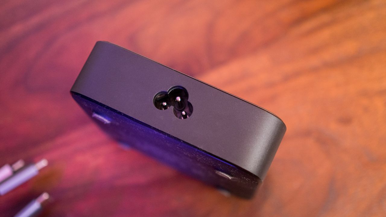

The power cable is two meters long, and you shouldn't have any issues connecting to wall sockets that are further away. UGREEN bundles a 6ft USB-C to USB-C cable in the box, and it works with the USB PD 3.0 standard, going up to 100W. The braided nylon design gives the cable added durability, and I haven't had any issues in the month I used it. UGREEN sells the USB-C cable for $11, and it a decent enough value.

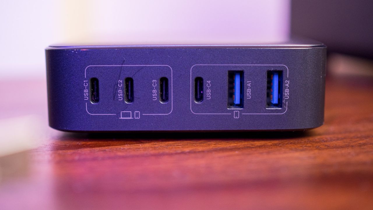

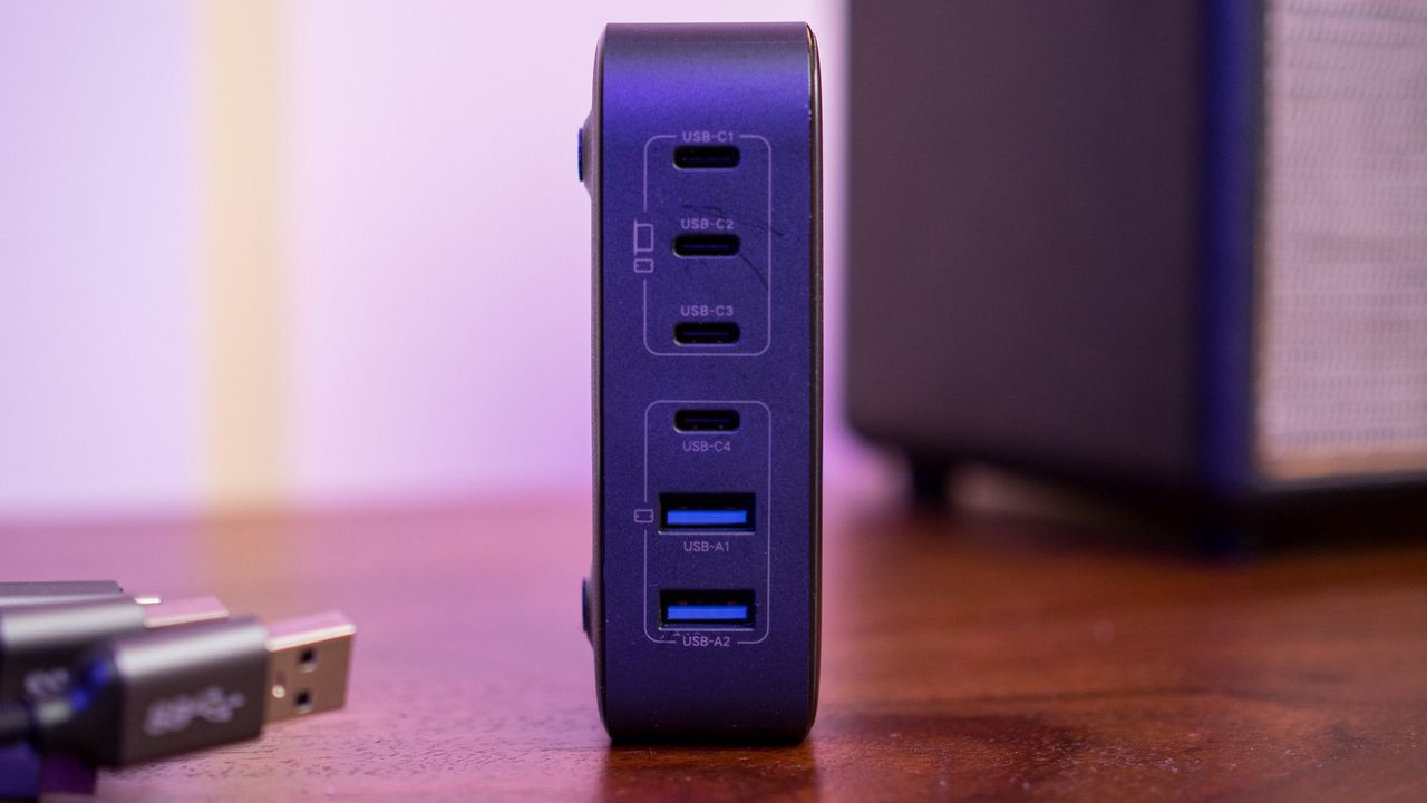

The Nexode 200W has six ports in total — four USB-C ports and two USB-A ports. The USB-C ports are clearly marked from one to four, as are the two USB-A ports. The USB-C1 and C2 ports can hit 100W over the USB PD standard, and the USB-C3 and C4 ports max out at 65W. The USB-A ports go up to 22.5W individually, but when both ports are in use, they share a 20W power budget.
Now, where the Nexode 200W stands out is its ability to allocate power to all six ports simultaneously. With all ports in use, you can get up to a maximum of 195W of power, allowing you to charge all your devices at the same time. Here's what the power allocation looks like when all ports are in use simultaneously:

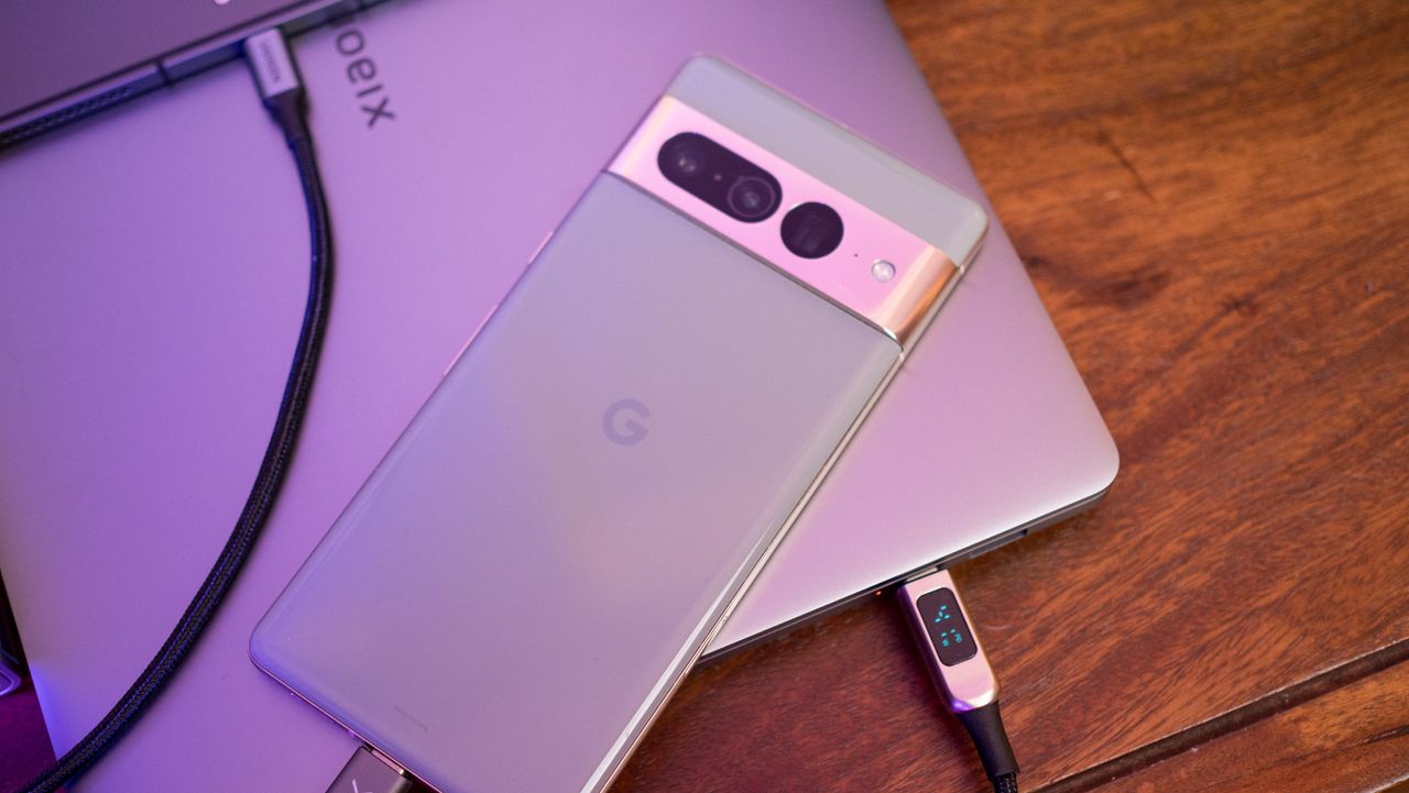

If you don't intend to use the USB-A ports, you can get the same 195W power budget split across the four USB-C ports. And if you use any three USB-C ports at the same time, they go up to 65W each. I used the USB-C ports to charge several devices at once — including the Galaxy S22 Ultra, Z Fold 4, Pixel 7 Pro, and the Xiaomi 12S Ultra, and it did a great job charging all of the devices at once.

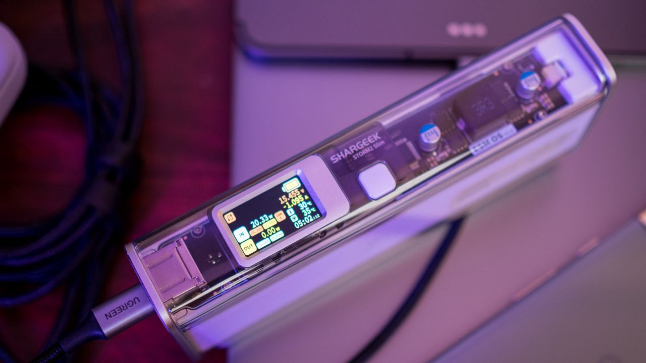

One other feature that would be useful is a built-in screen showing real-time charging details — this is one of my favorite features of the Shargeek Storm 2 power bank, and I want other manufacturers to do the same.
