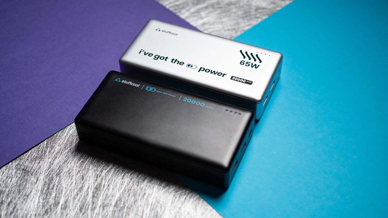

As the Major Ultra is a new variant of the Max, the design is identical. The power bank has a silver aesthetic that looks a little cleaner than the basic design of the Major Max, but there's a lot of obtrusive text and branding on the device that doesn't cater to my tastes.

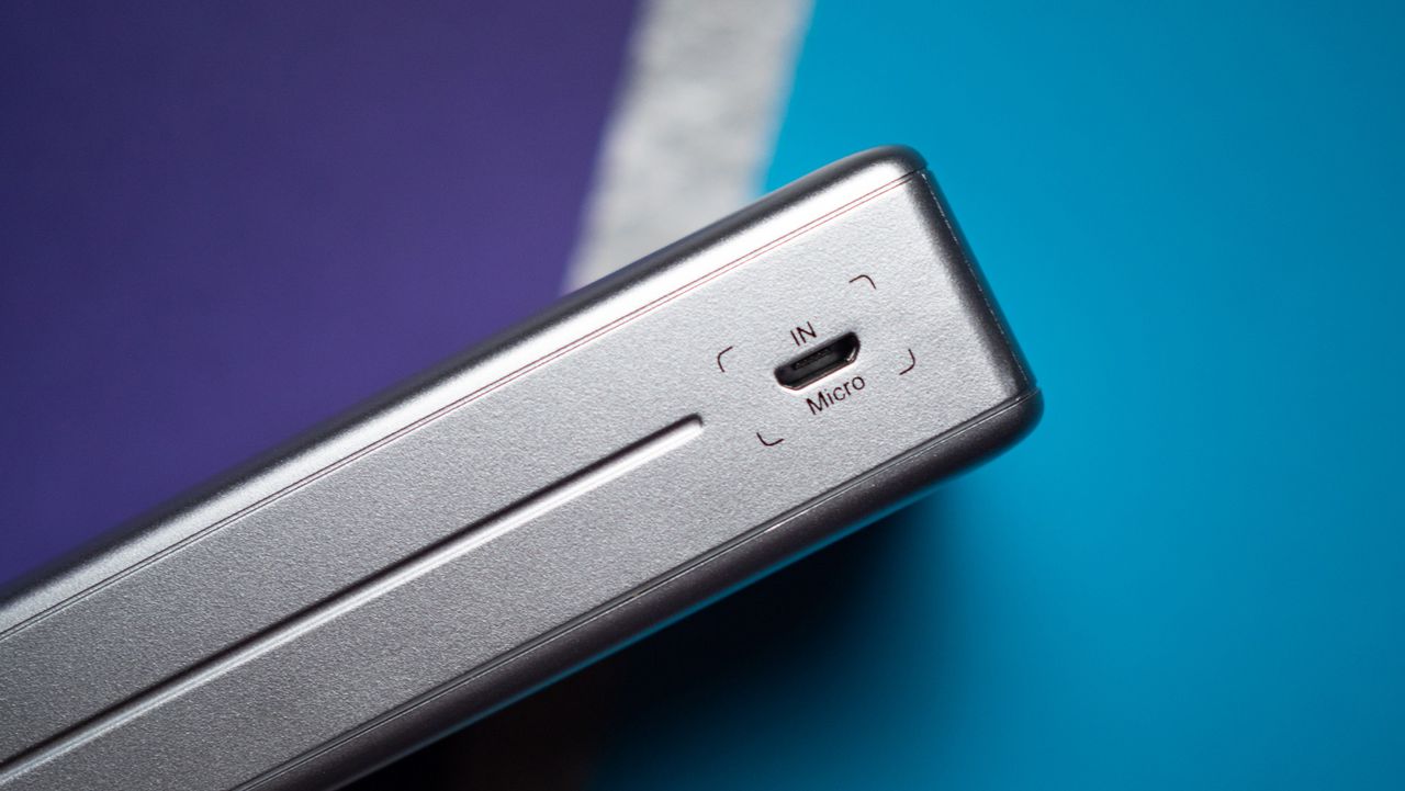

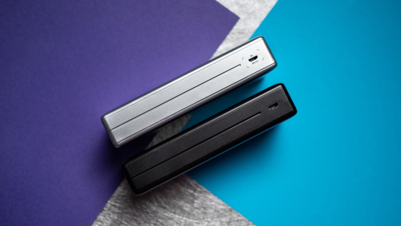

The Major Ultra has a rectangular design, and you get the same LED indicators that highlight remaining battery level. There's a power button on the right, and a Micro-USB port on the left; like the Major Max, you can use the Micro-USB port to charge the power bank at up to 18W. I don't get the utility of the Micro-USB port; if you're like me, you would've switched over to USB-C by now, and it's unlikely that a majority of Stuffcool's intended userbase would have Micro-USB cables lying around.

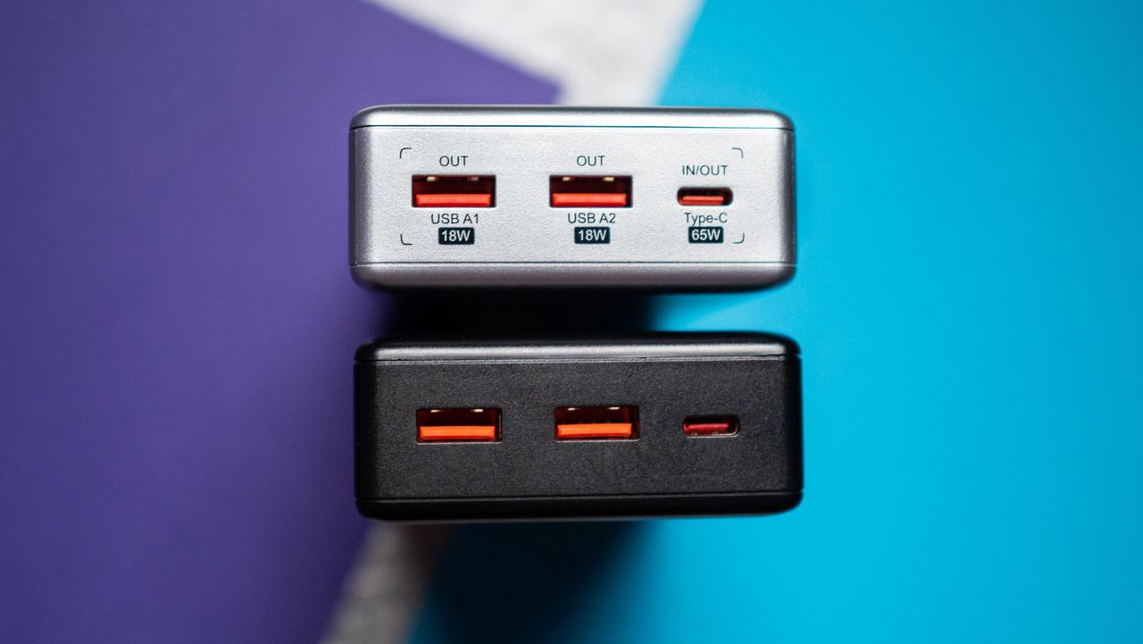

The Major Ultra comes with one USB-C port and two USB-A ports. The USB-C port is the one that goes up to 65W over the PD protocol, with the USB-A ports limited to 18W. Stuffcool obviously reused the same design as the Major Max, so it went with the same port configuration, but the brand should have offered two USB-C ports — all other 20000mAh power banks I tested in the last 15 months have at least two USB-C ports, and the Ultra is distinctly on the backfoot as a result.
The solitary USB-C port limits the versatility of the Major Ultra, but the power bank has a unique advantage in that it hits 65W over the USB PD PPS standard, making it a fantastic choice for use with Samsung devices. Yes, you get just a single USB-C port, but it delivers a reliable charge, and the ability to use it with Samsung devices is a big deal in this category.

  • USB-C in/out (65W Max): 5V/3A (15W), 9V/3A (27W), 15V/3A (45W), 20V/3.21A (65W)
  • USB-C PPS (65W Max): 3.3 - 13.5V/5A (65W)
  • USB-A1/A2 out (18W Max): 5V/3A (15W), 9V/2A (18W), 12V/1.25A (18W)
  • Micro-USB in (18W Max): 5V/3A (15W), 9V/2A (18W)
With two devices connected to the power bank, the USB-C port goes down to 45W, with either USB-A port limited to 15W, going up to a maximum of 65W. I used the Major Ultra over the course of a month to charge the likes of the Pixel 9 Pro XL, Vivo X100 Ultra, Xiaomi 14 Ultra, and a host of other devices, and I didn't see any problems with charging. The dual USB-A ports are better suited to charge accessories, and that's what I ended up using most of the time.
