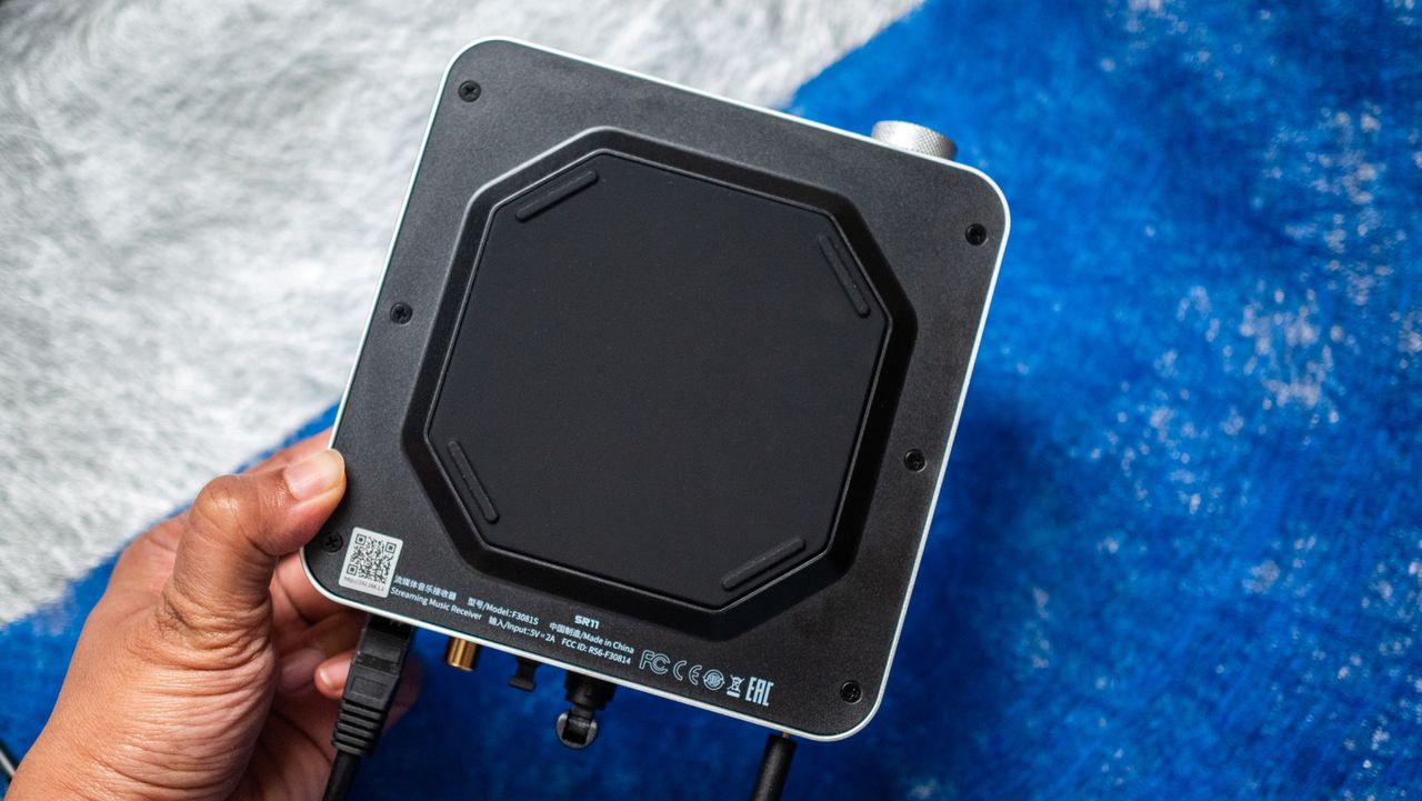

Fiio SR11 back view showing connectivity
(Image credit: Apoorva Bhardwaj / Android Central)
Another feature that's missing is DLNA; Fiio is limiting that to test builds, and I don't really understand why that's the case. Essentially, you're not getting as much in the way of connectivity, with the device aimed to be used with iPhones, or if you have Roon.
Because there's no built-in DAC, the SR11 doesn't need much in the way of power, and it is powered over USB-C. There's a wall plug bundled in the box, but you can use it with any source as long as it delivers 10W of power. You also get USB-C and USB-A out, as well as optical and coaxial. There's an antenna that does a good job delivering a strong signal, and of course, you get Ethernet.

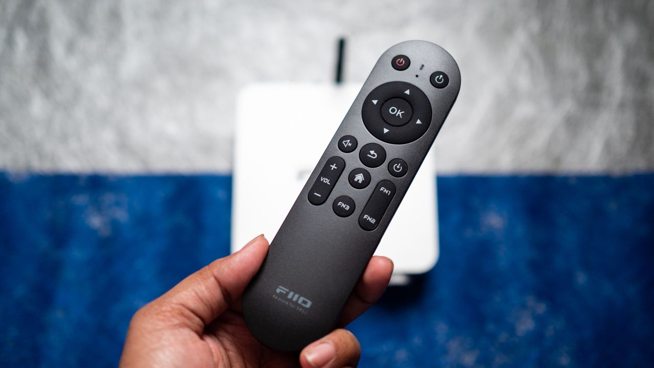

I like the fact that Fiio bundled a remote with the device; it makes it much more convenient to use than the control knob. This is what I do with the K19 DAC as well, and I'm glad to see the remote included on a budget product. Connecting to another DAC via USB is as straightforward as it gets, and you can use just about any device.
