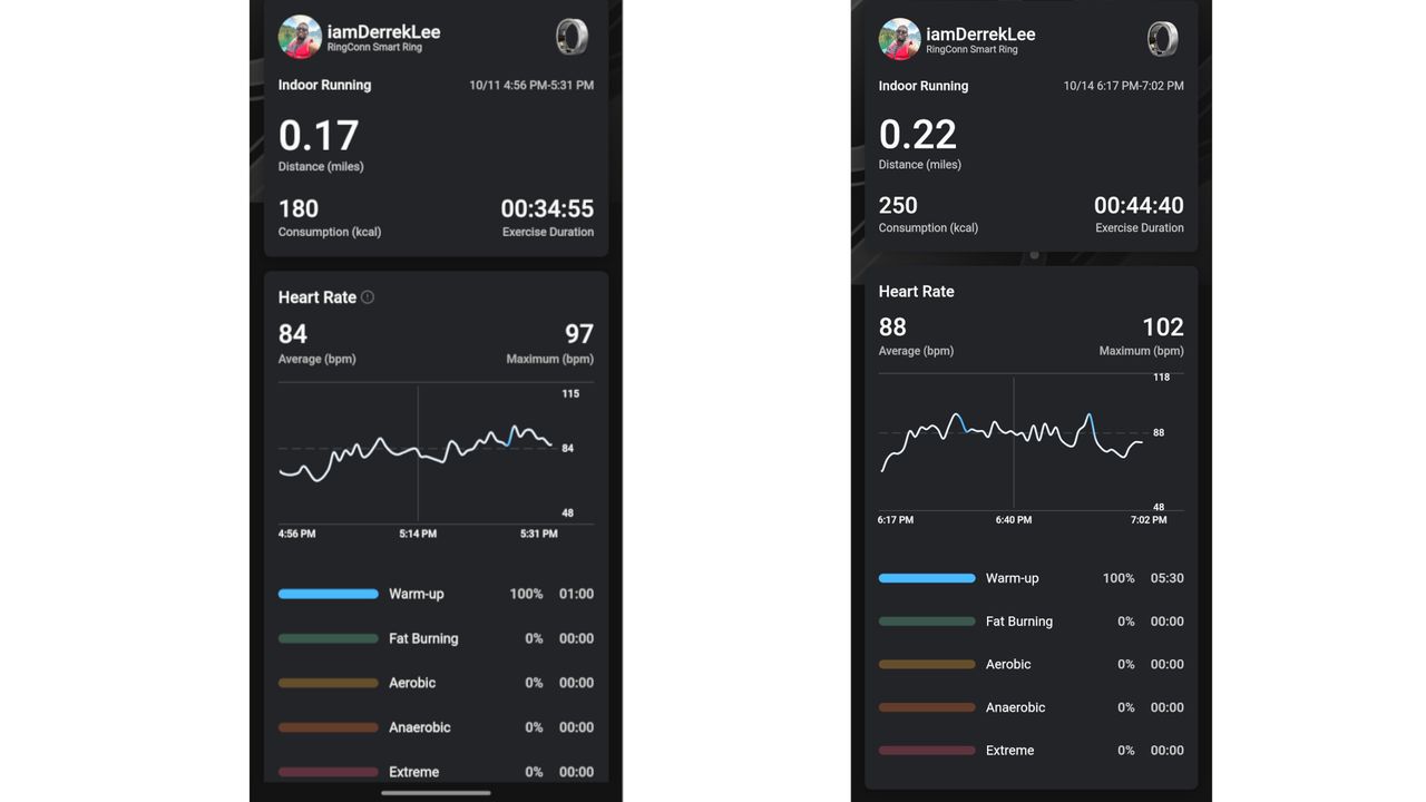

Plus, some of these smart rings don't even let you trigger a manual workout unless it's a specific type, like walking or running. For some brands like RingConn, we had to trick the app by saying Derrek was "running" during a gym workout to have it save his heart rate data. Without a workout mode, smart rings don't sample your heart rate frequently enough for the results to be at all helpful.

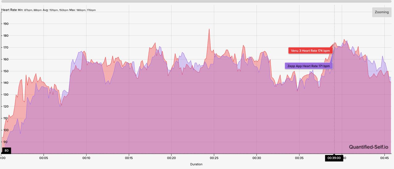

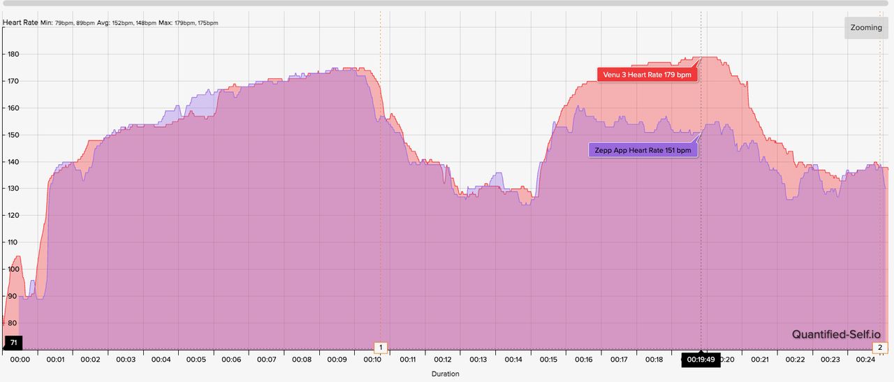

Now compare these three smart rings' massive gap in results. You'll see that only the Amazfit Helio Ring is consistently accurate — especially if we flip a coin and assume Google is more accurate than Garmin here. Its averages are very much on point, and while its max-HR data falls short, it's not as underestimated as Oura or RingConn.
It's not perfect, of course. You can see in the two heart rate graphs below that it falls well short of Garmin for an extended stretch once Derrek's heart rate reaches certain heights; in the second graph, it's always close but tends to show small valleys where Garmin peaks. But overall, it's closer than I expected from any smart ring.

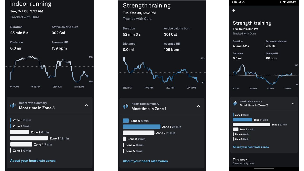

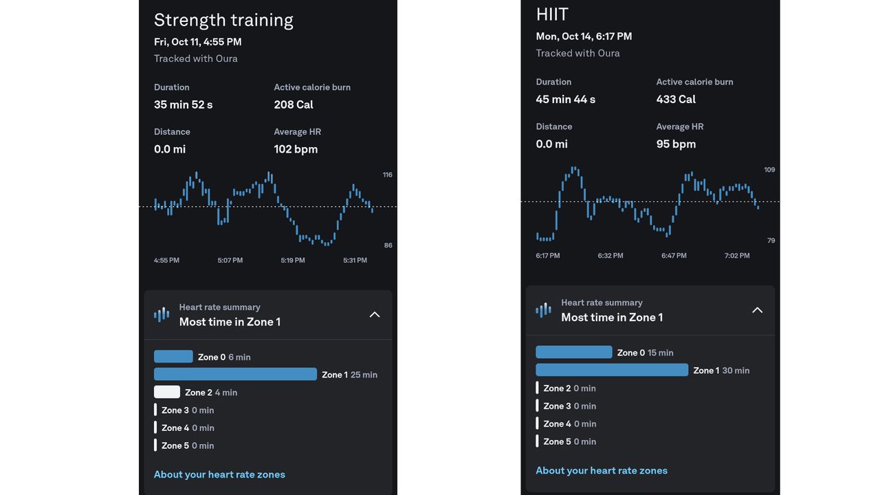

Oura doesn't do badly for low-aerobic workouts in the 100–130 range, but the higher Derrek's heart rate climbed, the more difficulties the Oura Ring 4 had. In the last workout, the heart rate chart showed a massive 60–70 bpm gap for most of the workout.

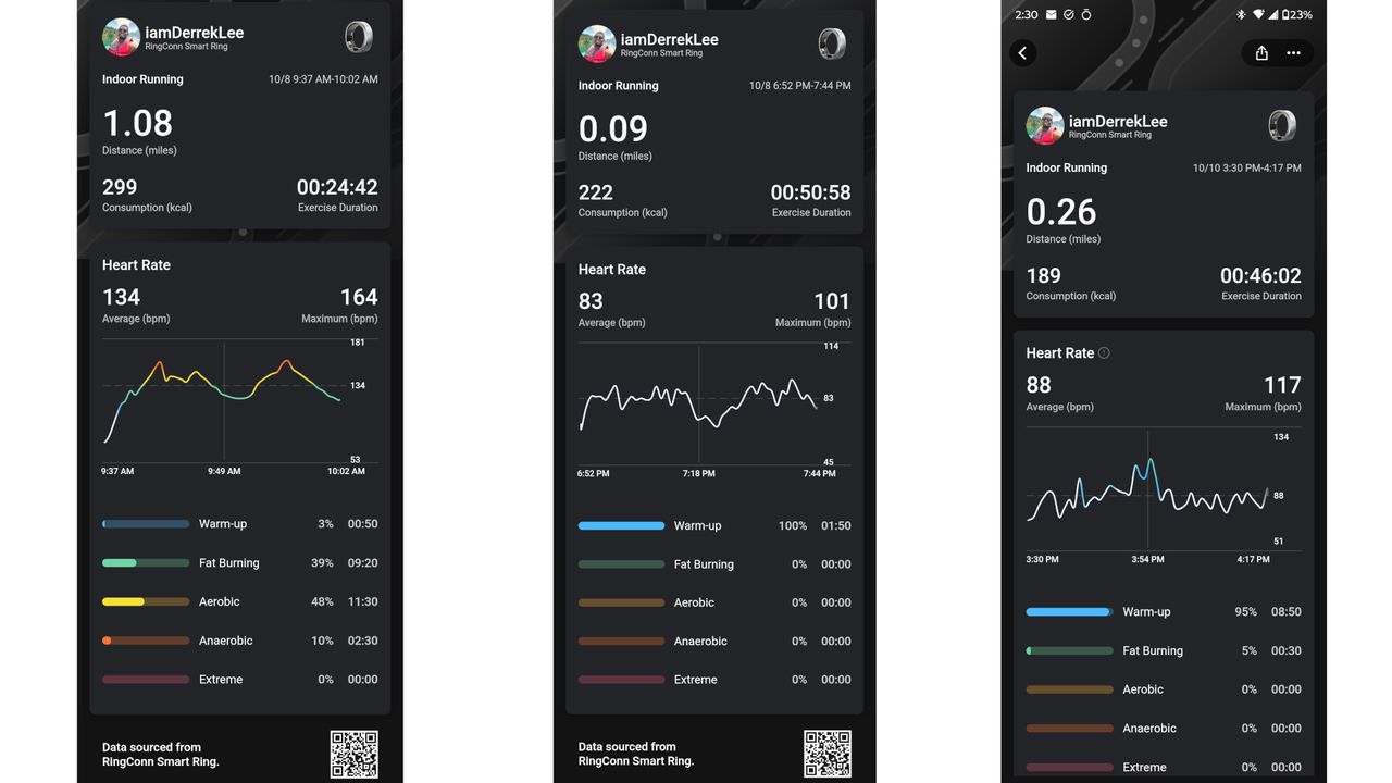

RingConn's stats are so far off that Derrek speculated that the issue might be that he was forced to wear it on his ring finger instead of his usual index finger (he only has so many fingers, after all), leaving it too loose for a proper reading. That might explain the issue, so we can give RingConn a tentative pass here, while still keeping the data for now.

I will point out that if you wear a smartwatch too loosely or too tightly, your results will be skewed, too...but not this much. It goes to show how important a smart ring's fit is for proper results.

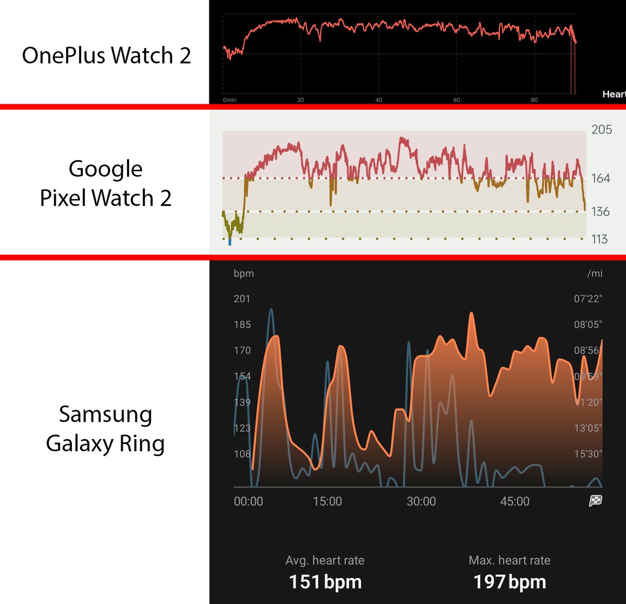

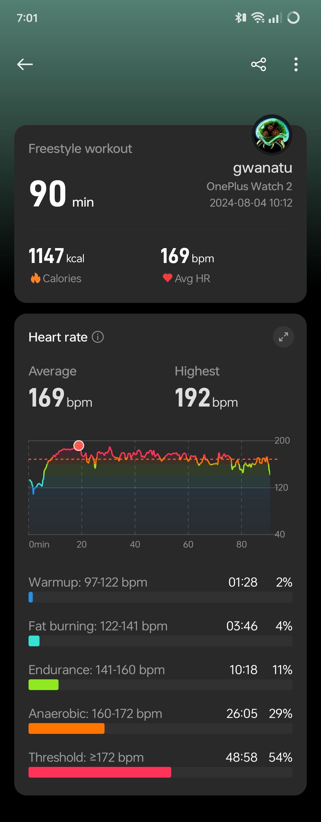

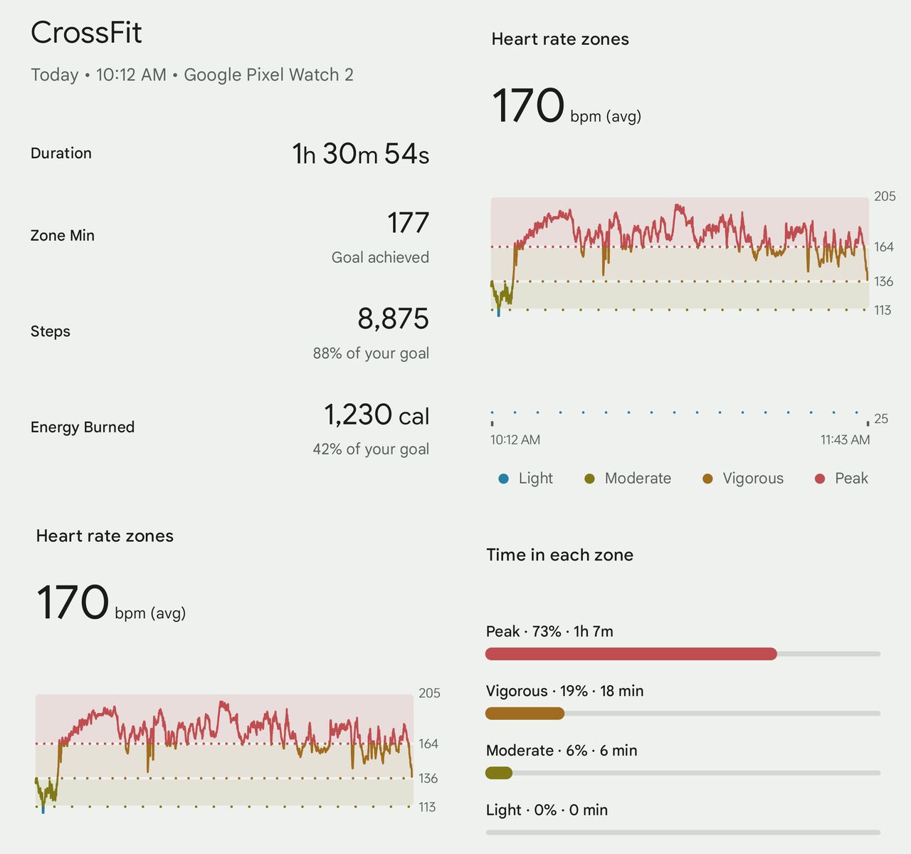

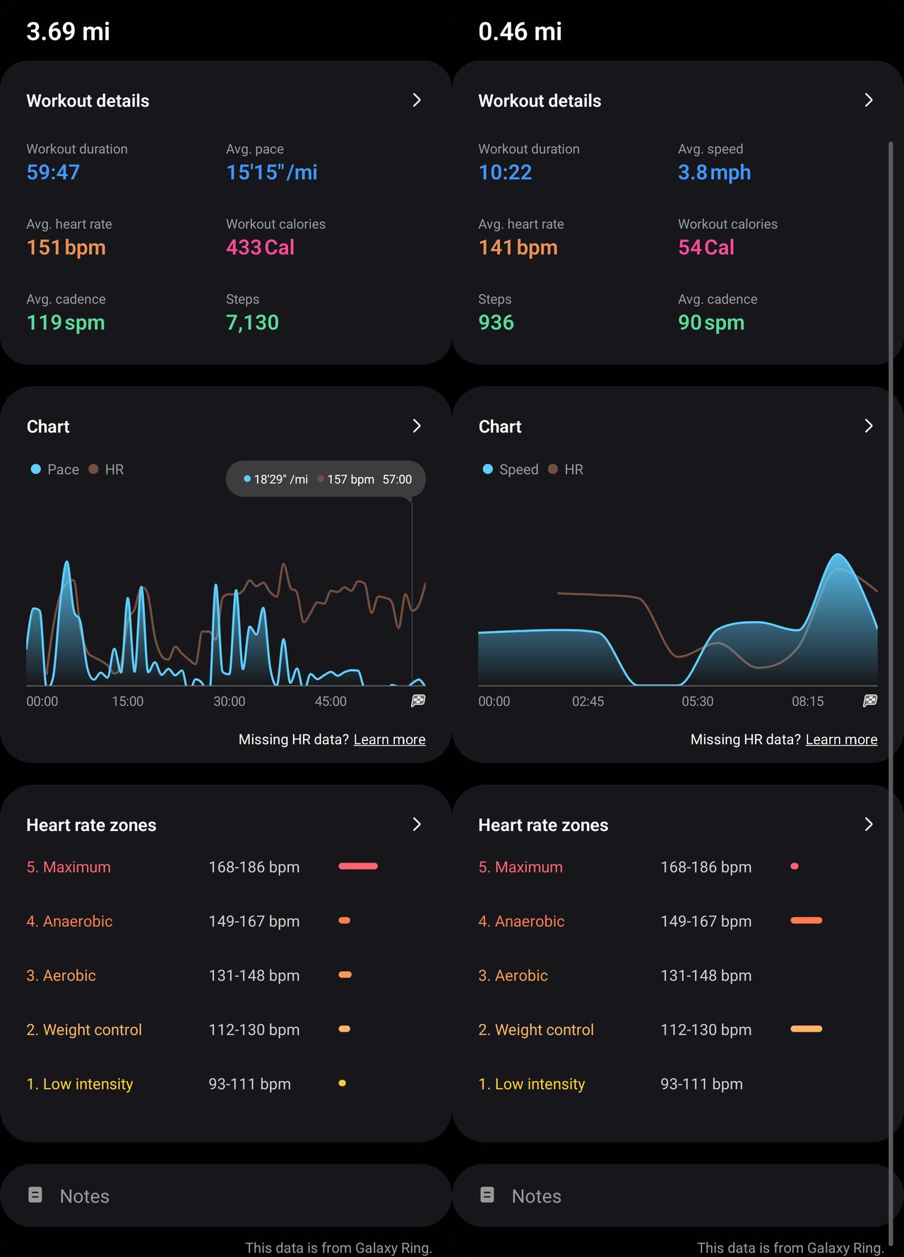

Nick already wrote about the Galaxy Ring's fitness struggles in his review: The Pixel Watch 2 and OnePlus Watch 2 averaged 170 and 169 bpm during a hard Spartan Race; the Galaxy Ring averaged under 150 bpm, randomly splitting the race across two activities.
