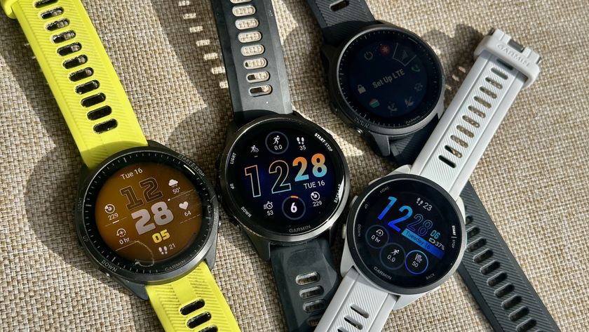

The Garmin Forerunner 165, COROS PACE 3, Fitbit Charge 6, and Polar H10 sitting together on a table.
(Image credit: Michael Hicks / Android Central)
