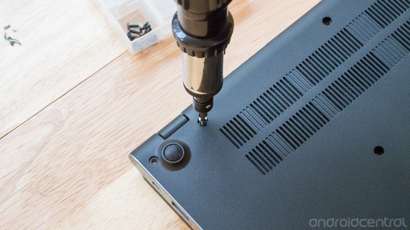

The first step of this install is removing the screws that hold the bottom plate onto the chassis. Close the laptop lid, flip over the Chromebook and check out the screw holes. You'll notice a total of 12 screws visible, and one hidden by that aforementioned warranty sticker in the middle. The screws don't take much force to remove, so be careful. As we said before, these types of screws are easy to strip out, and that's when you really run into troubles.
One by one, remove each of the screws, in no particular order. The screws are all identical sizes and lengths, which is nice. Get a small container of some sort (preferably with a sealable top) to store the screws in as you remove them — these things are small and easy to lose if you drop them on the carpet.

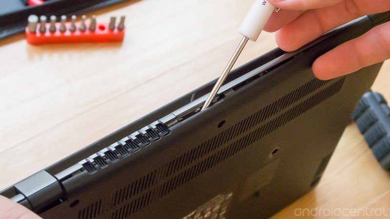

Here's the fun, yet terrifying, part. Now that you've removed all of the screws, you must pry the bottom plate from the base. The plate is held on by a good number of hard plastic clips that go around all four edges. You'll have to open up the case at some point along the edge to get things started.
We chose to use a flat head screwdriver, but any sort of relatively thin plastic or metal separation tool will do. We picked a spot just to the right of the fan vent on the hinge portion of the laptop as our starting point. Once you have the body separated, you will have to slide your tool in either direction until you hit the first snap point. Once you pop one out, the case will open wide enough that you can simply use your fingers to pull the plate off one snap at a time around all four edges.
Be as careful as possible with these snap points, as they are extremely fragile. We managed to break (just) one of the snaps on our own Chromebook — luckily it isn't noticeable when put back together — and you definitely wouldn't want to break many more than that. These aren't the sort of flexible snaps you find on a removable back cover of your Samsung Galaxy S4, they're meant to be clipped on once and never let go.

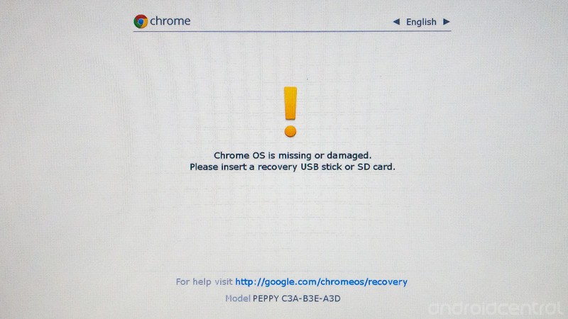

Now that everything is put back together, flip the Chromebook back over, open the lid and hit the power button. You'll be greeted by the above screen, which (understandably) informs you that there was an issue booting into Chrome OS. Remember that recovery disk that we made before we started this whole process? Pop that into the USB port or SDcard slot.
The Chromebook will automatically recognize the disk as a recovery media and start the restore process. It will take a handful of minutes, but you'll be able to watch a nice progress bar while it does its magic. As it says on the screen, make sure to plug your Chromebook back into its power supply just in case the battery was low before you started the drive replacement.
When the recovery is complete, remove the USB drive or SDcard and your Chromebook will automatically reboot and greet you with a fresh start screen. Move through the setup process just as you normally would, add in your Google credentials and you'll be logged in.
