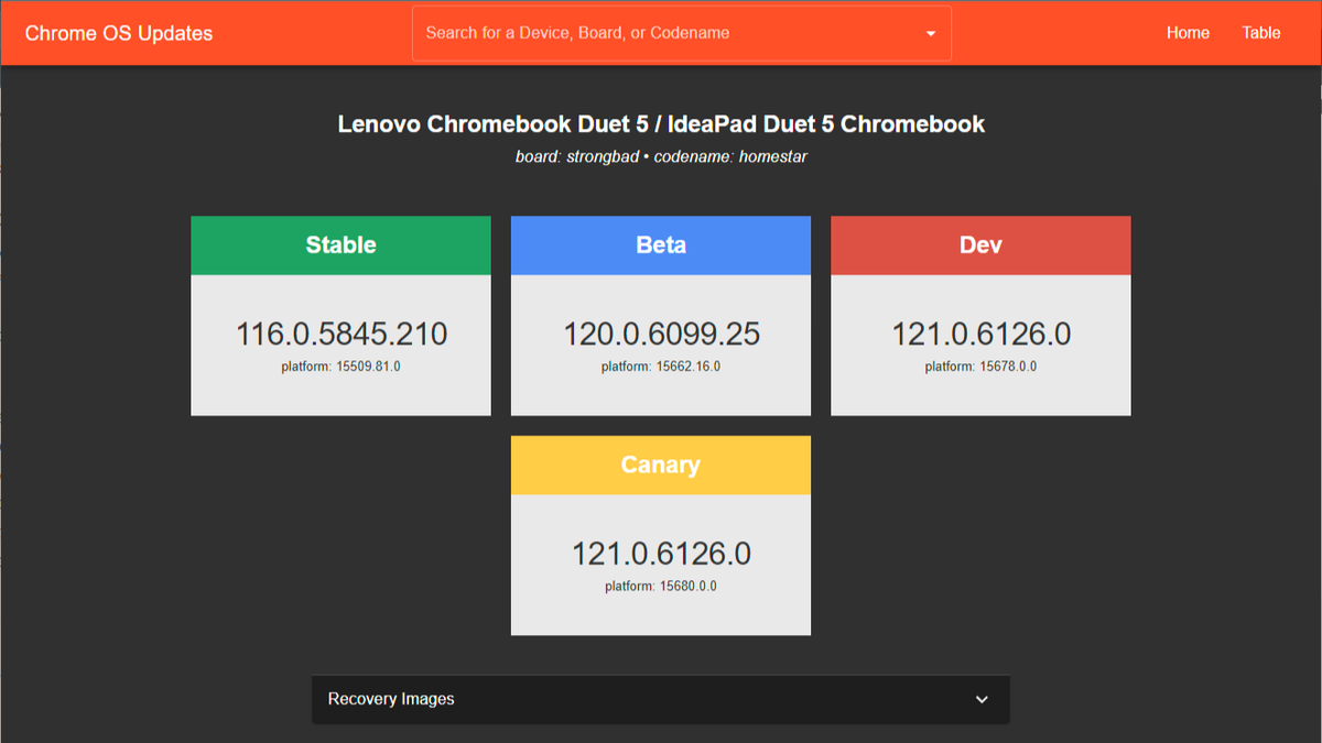

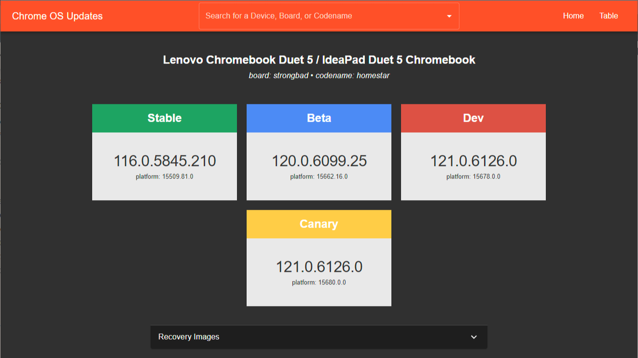

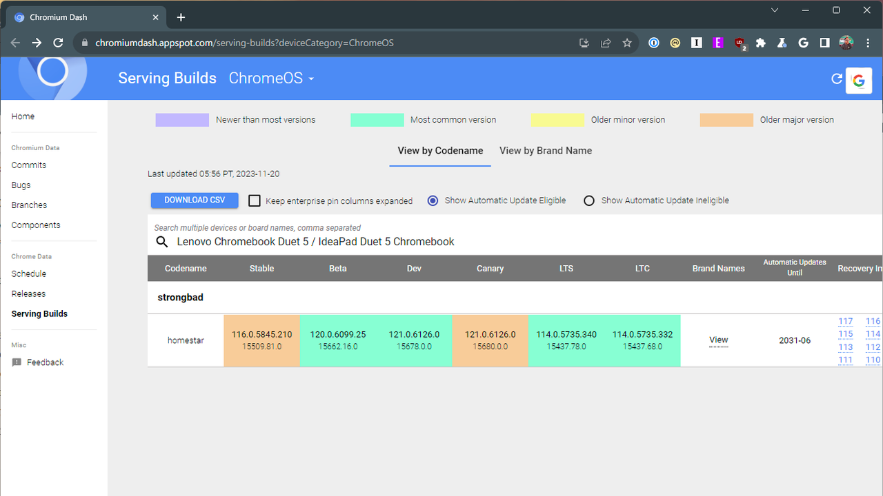

If you head over to either cros.tech or Chromium Dash and look up the Duet 5, you'll see that the Stable build is currently ChromeOS 116. Considering that we're already up to ChromeOS 119, this is rather problematic, and it has nothing to do with the software.
