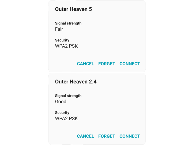

Lower frequencies can penetrate further into buildings and cover greater areas around towers before fading out. You can even observe degradation in higher frequencies with a Wi-Fi router that transmits both 2.4 GHz and 5 GHz signals. As you put more distance and objects between your phone and router, the 2.4 GHz signal will reach farther than the 5GHz signal.
