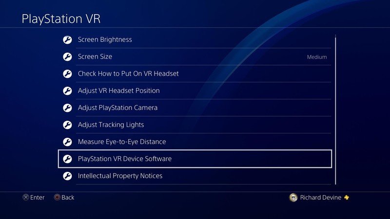

  1. Scroll down and select PlayStation VR.
Source: Android Central (Image credit: Source: Android Central)
  1. Scroll down and select PlayStation VR device software.
  1. The screen you see will now show you the current software version you're on.
  1. To check for a software update select update PlayStation VR device software.
