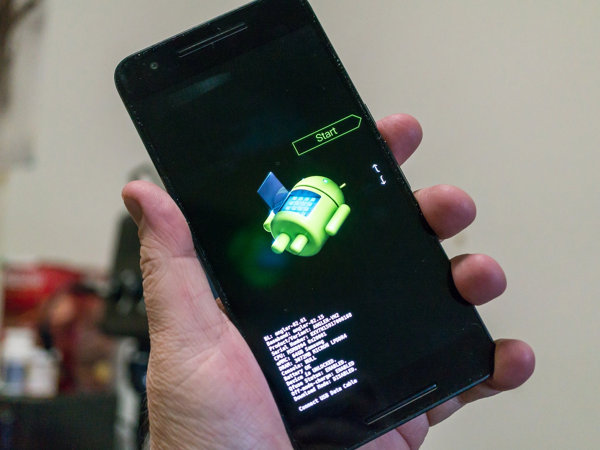

Once you have things sorted, it's time to reboot to the bootloader:
adb reboot-bootloader
When you get to this stage, you will need to use fastboot to communicate instead of adb. If you're working out of the folder where the fastboot command is located, remember that dot and slash if you're using a Mac or Linux computer. Try this command to see if everything is working:
fastboot devices
See the serial number like we did with the adb command? If so, you're good to go. If not, you need to troubleshoot. If you're using Windows and having issues, chances are it's the driver. In any case, hit the forums and work out why things aren't communicating if you need to.

Up until now, things are the same here as they have always been with Nexus phones. But the command to actually unlock the bootloader has changed. When you're ready, at your command line, type:
fastboot flashing unlock
Remember — this will erase everything on your phone and restore it to the way it came out of the box.
You'll need to confirm this action on your phone's screen, using the volume and power keys. Follow the instructions on your screen.
Let it do it's thing, and when it's done send one more command to make things final:
fastboot reboot
After recovery erases everything and you've booted back to Android (at the device setup screen) you can unplug your cable and use your phone normally.
