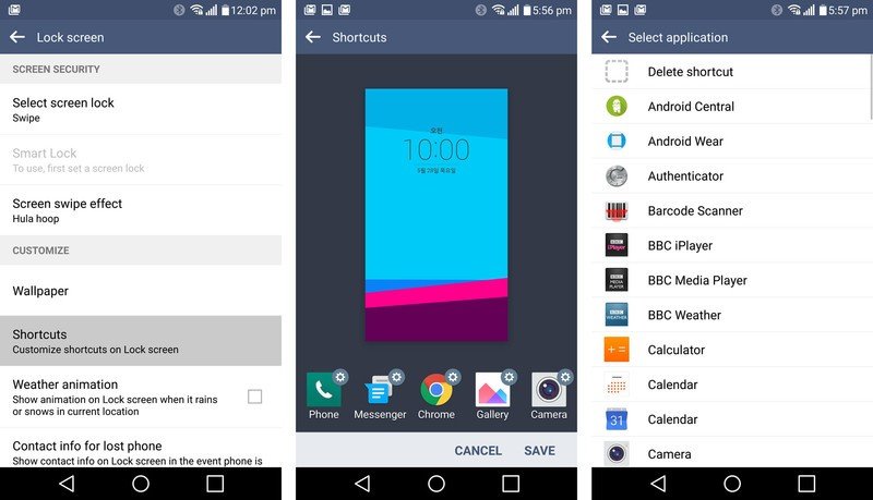

- Under the default tabbed Settings view, go to Display > Home & Lock > Lock Screen ...
- ... Or in the list view, go to Device > Lock Screen
In the next menu, head to Settings > Shortcuts, and tap an icon to change it to a different app, or disable it entirely. You can also drag and drop icons to re-order them. When you're done, tap "Save" — simple.

If your G4 is unlocked using Smart Lock, you'll still see lock screen shortcuts as normal. However because you've got a PIN or pattern lock set as well, the "Shortcuts" menu item is hidden. A quick work-around for this problem involves temporarily disabling your PIN or pattern, changing your shortcuts, then re-enabling it.
- In the "Lock Screen" settings menu, set your screen lock type to "Swipe." (You'll need to enter your PIN or pattern again to confirm this.)
- Go back to the Lock Screen menu and enter the "Shortcuts" menu item that will have just appeared.
- Change your lock screen shortcuts in the menu as described above, and save them.
- Go back to the "Select screen lock" menu and set up your PIN or pattern once again. You'll be asked to confirm your notification privacy settings as well.
