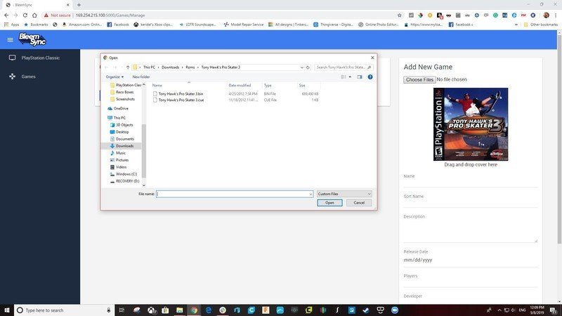

- On the game manager screen, click the choose files button to open your file manager.
- Use the .bin and .cue files of your game to upload. You do not need to worry about the picture or other details, it will populate automatically.
