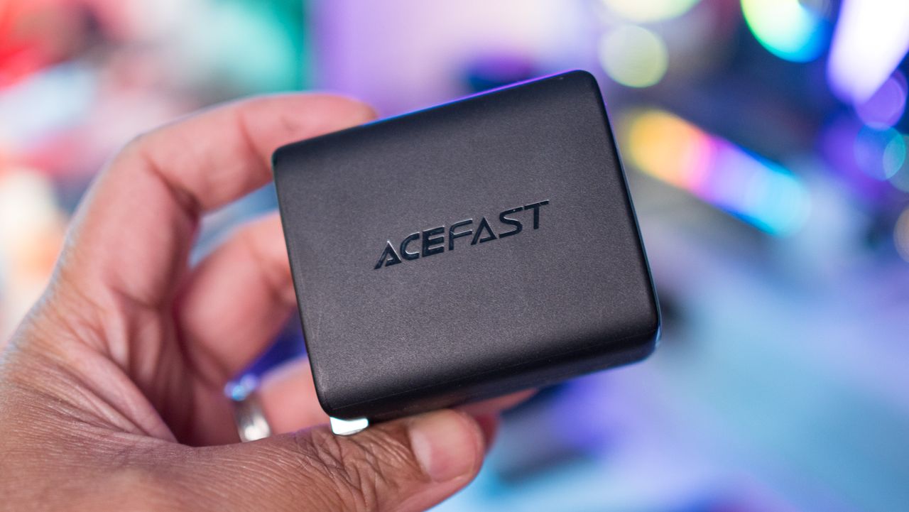

Acefast isn't a brand that many would be familiar with, but the Chinese accessory maker rolled out one of the most interesting chargers I've used. The Acefast GaN PD65W has a USB-A and USB-C port and works with the USB PD protocol to deliver 60W of power, making it a decent choice for charging the best Android phones.
When both ports are active, you get a total power budget of 65W; again, standard fare for most chargers these days. But what makes Acefast's charger unique is that it has a third port: an HDMI connector. The HDMI port turns the charger into a dock for your Steam Deck or Nintendo Switch, allowing you to connect a TV or monitor with ease.

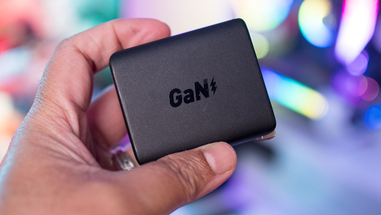

Let's start with the charging part. The USB-C port is the star of the show here, delivering up to 60W of power over the USB PD 3.0 protocol. There is a USB-A port as well, but that's used mostly for connecting accessories and doesn't offer much on the charging front, going up to just 5W. Here are the charging profiles on offer:
  • USB-C: 5V/3A (15W), 9V/3A (27W), 12V/3A (36W), 15V/2.6A (36W), 20V/3A (60W Max)
  • USB-A: 5V/1A (5W Max)

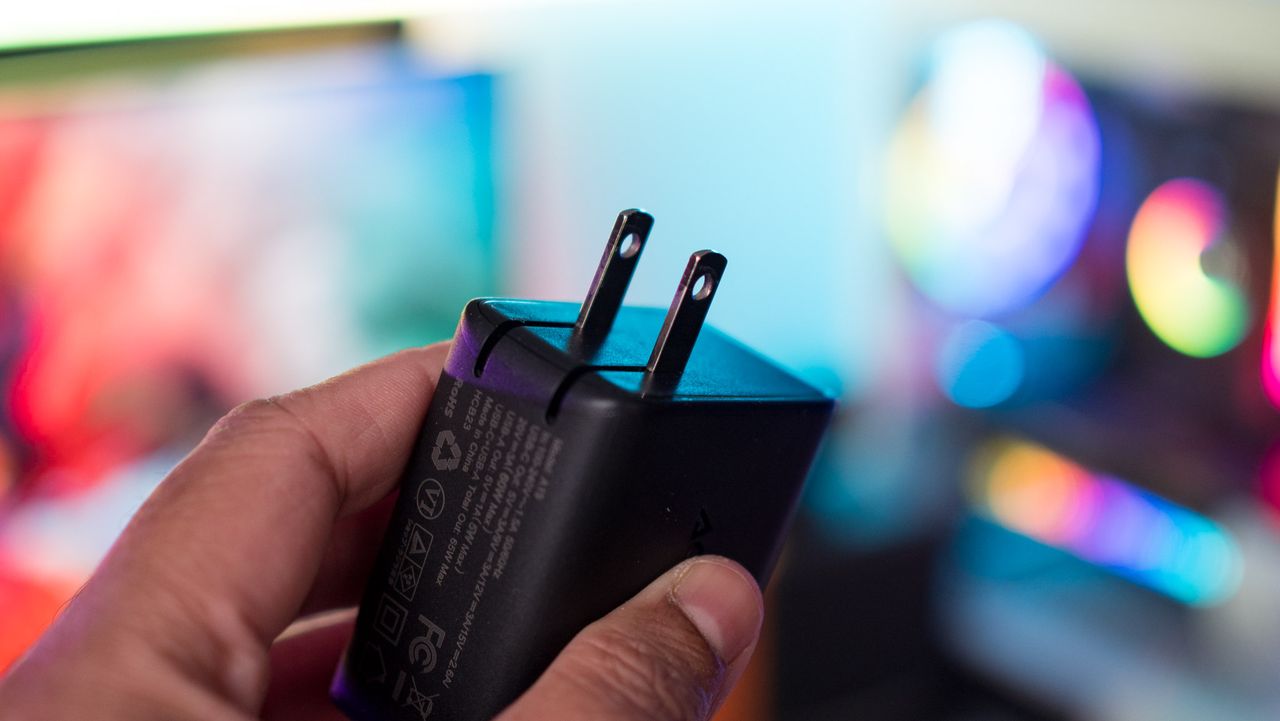

Overall, Acefast managed to carve out a niche for itself by adding an HDMI port to an otherwise traditional GaN charger. The charger itself isn't bulky thanks to GaN charging tech, and the pins fold into the design, making it ideal for use on the road. The fact that you can use the HDMI port to dock your handheld console makes it a truly standout charger, and you're not paying a lot for the added features — it costs just $49 on Amazon. Acefast has its own storefront as well if you're interested in buying direct, with the charger available for $50.
