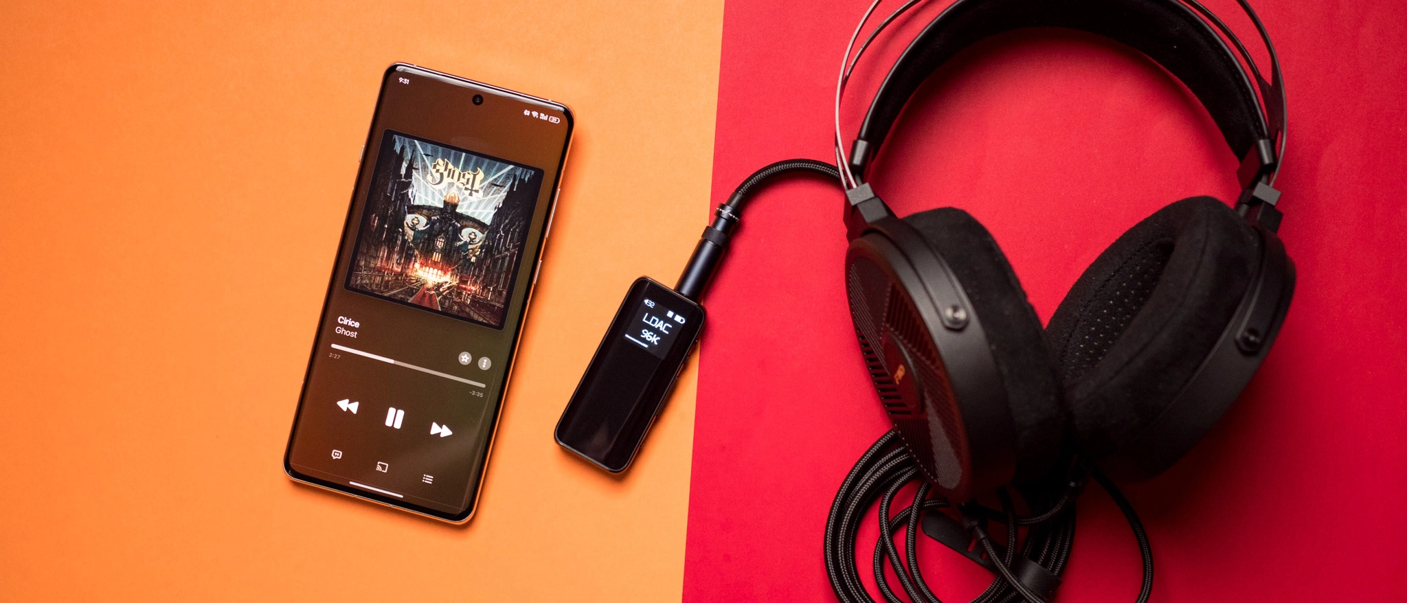

Fiio BTR15 review: This Bluetooth DAC is the ultimate value
The BTR15 costs less than the BTR7 while delivering more power and Bluetooth 5.1 connectivity.
Fiio BTR15 review
(Image credit: © Harish Jonnalagadda / Android Central)
Android Central Verdict
The BTR15 retains the same design as the BTR5, so you get a small chassis that's easily pocketable, and terrific build quality. The DAC has a larger screen with better readability, you get Bluetooth 5.1 connectivity, a balanced 4.4mm port in addition to 3.5mm, but the biggest difference is the power: it now goes up to 340mW over the balanced port. You get a clean sound with excellent resolution, and coming in at just $109, the BTR15 is the best value if you need a Bluetooth DAC that has all the extras.
