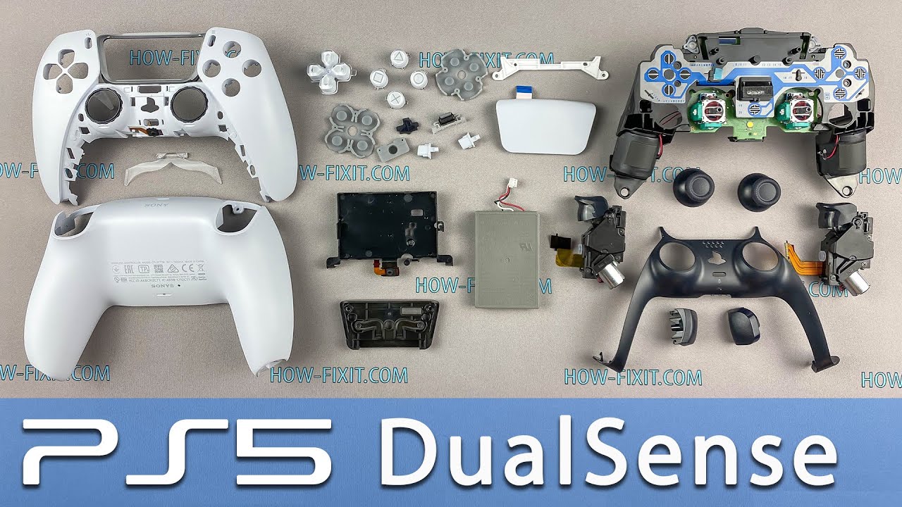

If your DualSense isn't holding a charge, you unfortunately may need a new battery. It's not exactly intuitive to replace it as it's not meant to be replaced, but if you don't want to buy a new controller, then it's doable. The video above provides a great walkthrough on replacing the battery. The DualSense packs a 1,560 mAh battery, so we'd recommend one that's similar. Unfortunately, we haven't been able to find any online that are guaranteed to be compatible. If you think it'd be easier to send it in to Sony to fix under warranty, you should do that first.
1. Using opening tools or something with a flat edge, pry the black panel off the face of the controller.
2. Once loosened enough, it should pop off.
(Image credit: Jennifer Locke / Android Central)
3. Using another thin object, remove the right and left bumpers (L1 and R1).
4. Unscrew the four screws beneath the bumpers on either side and at the bottom of the grips, where you removed the black face plate.
5. Take your opening tool or flat edge and pry the shell apart at the seams.
6. On the bottom of the controller, push out the two clips holding the casing together (next to the 3.5mm jack).
7. Carefully remove the battery and replace it.
