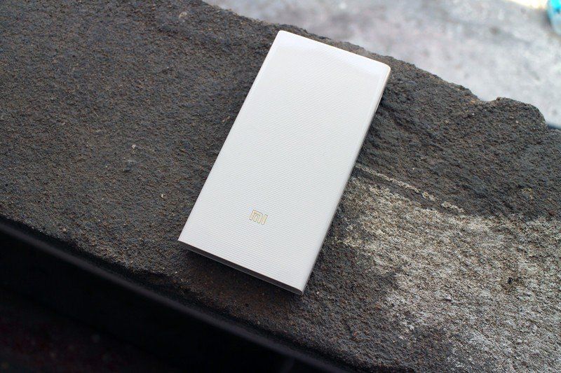

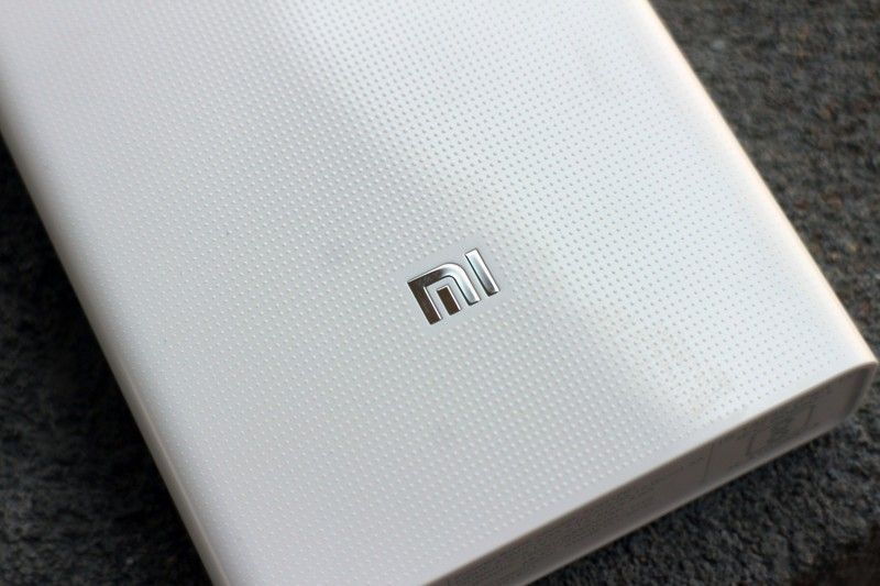

The 20000mAh power bank comes in an environmentally friendly ABS plastic housing with a textured pattern aimed at improving grip. The design is a switch from the anodized aluminum casing seen on the 5000mAh, 10400mAh, and 16000mAh power banks. The plastic makes for a far better finish, as it doesn't make the surface of the power bank nearly as slippery as the aluminum design. The casing is also scratch-resistant, and can withstand heat up to 90 degrees Celsius (not that it gets that hot itself). With an overall weight of 338g, the power bank is lighter than the 350g 16000mAh version, which is impressive.
Going with a plastic case makes the battery much lighter, but keeps durability high.

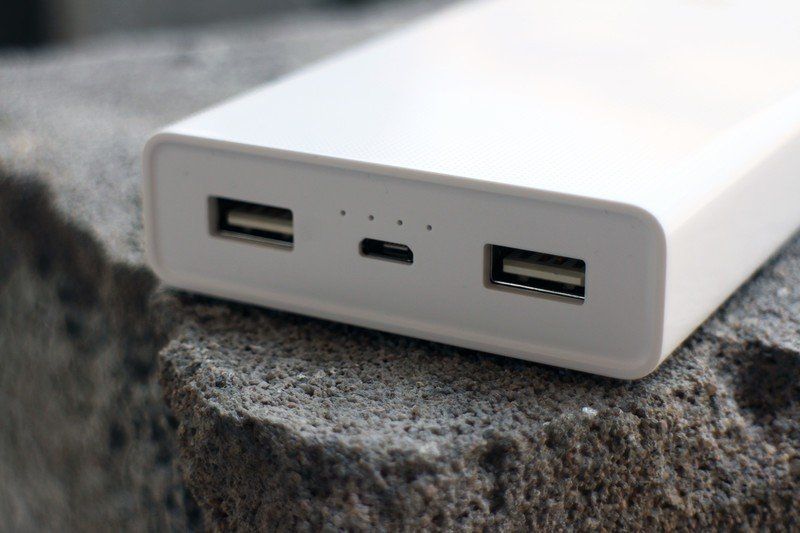

The 20000mAh Mi Power Bank features six high-density batteries from Panasonic and LG, and has two USB ports that allow you to charge two devices simultaneously. The dual USB ports offer a combined output of 5.1 volts at 3.6 amps, which translates to 18.36 watts. Each port is capable of outputting up to 2.1 amps, and you can also use the power bank to charge USB Type-C devices. However, the output from a single port falls short of the recommended Quick Charge 2.0 spec, which means that you're looking at solid but generally longer charge times. You'll have to go elsewhere if you want a battery that can quickly juice up a dead Quick Charge phone.

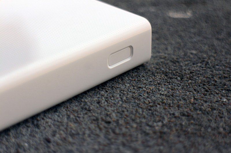

There's a four-LED capacity indicator at the top of that shows the charge remaining, with each LED corresponding to a 25% charge. The power bank automatically switches on and off as soon as you connect a device, but there's a dedicated power button on the right as well. Xiaomi bundles a one-foot long flat micro-USB cable out of the box, but I prefer these Monoprice cables.
The power bank has a micro-USB input for recharging, but there isn't a wall charger included in the box. I used a Tronsmart Titan — which delivers the suggested 12V/1.5A charge — and it took over eight hours for the power bank to fully charge.

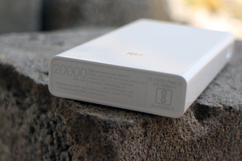

20000mAh is a lot of capacity, and to ensure that the power bank delivers all that power safely, Xiaomi uses what it calls "nine layers of circuit chip protection," which provides protection from circuits shorting out, input and output overvoltage, overcharge and overdischarge, output overcurrent, and more. The USB power control and charging chips are made by Texas Instruments, which are far more reliable than what's commonly used in products in this price range. As noted above, Xiaomi aims to use high-quality battery cells from reputable manufacturers as well, which not only keeps capacity figures consistent but also improves safety.
Given Xiaomi's brand cachet and the nature of the hardware on offer, the vendor is susceptible to counterfeits from third-party sellers, who use low-quality batteries packaged in a similar casing. To combat the issue, Xiaomi issues a 20-digit security code on the packaging of the Mi Power Bank, which can be verified on its official website. If you're buying a Xiaomi power bank from anywhere other than its own portal, a safe practice is to verify before using the power bank to ensure its legitimacy.
