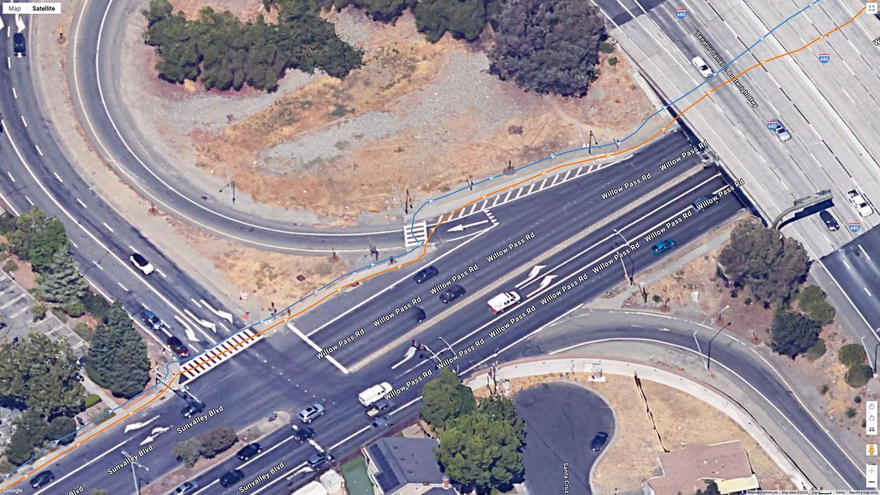

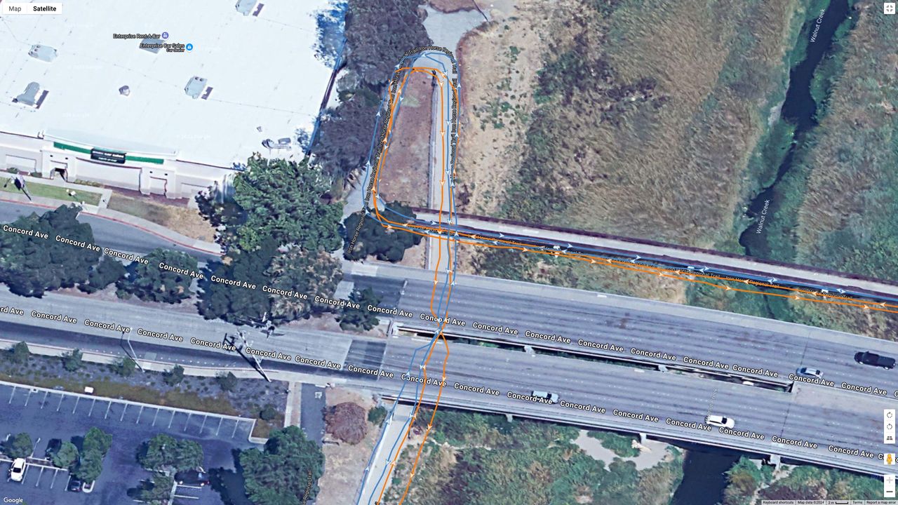

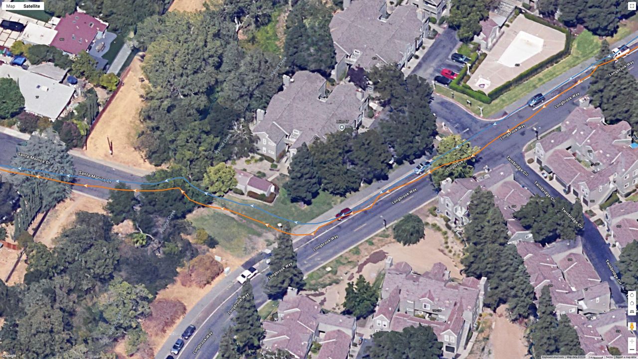

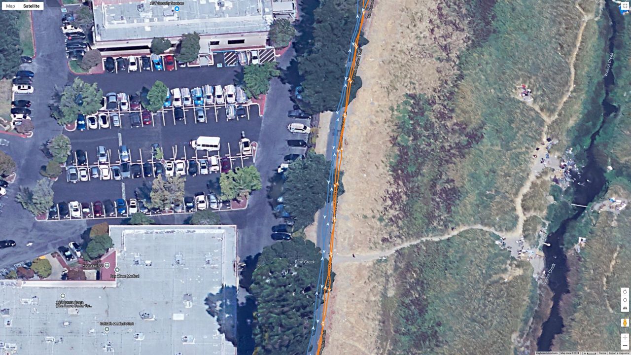

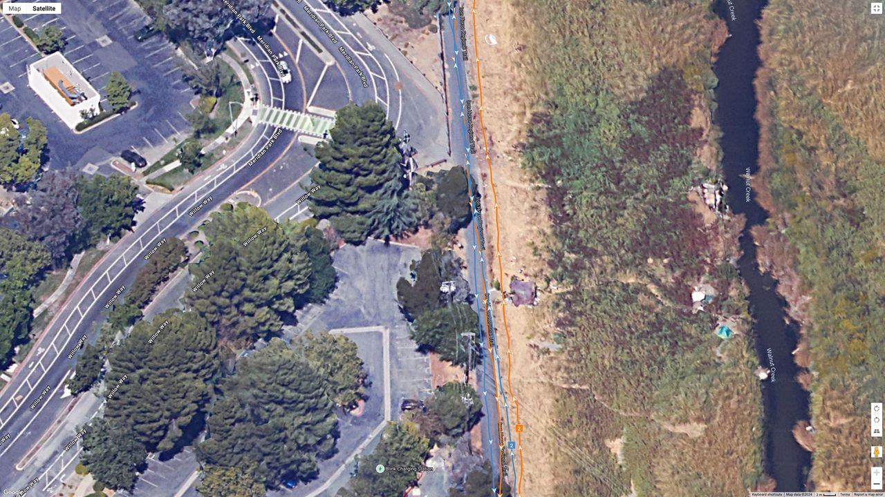

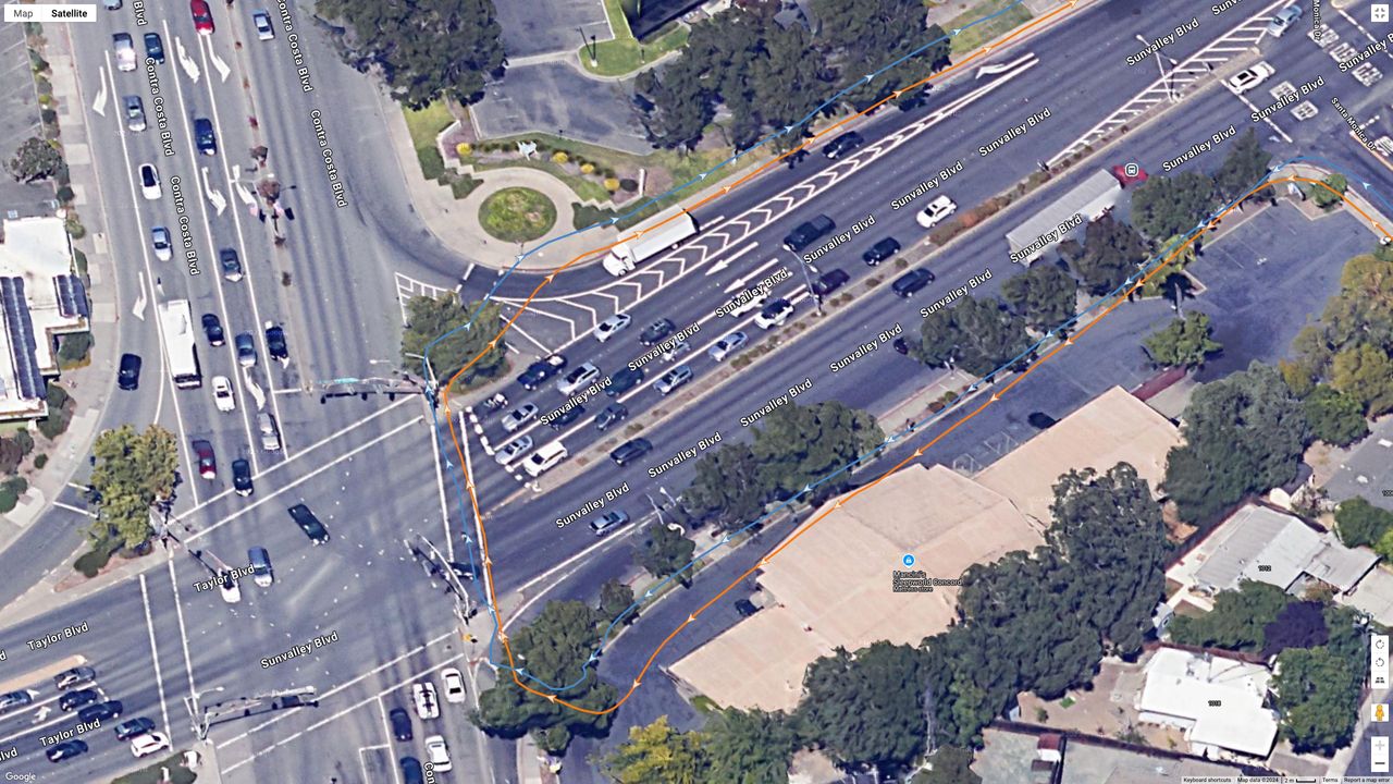

If you look more closely at the GPS map between the Vantage M3 (orange line) and Fenix 8 (blue) for my most recent 10K run above, there are a few instances where the Vantage M3 drifts slightly into the street or buildings, with the same unprompted zig-zagging and hard angles as the dual-frequency Suunto Race, as well as some issues with underpasses that the Fenix 8 didn't encounter.

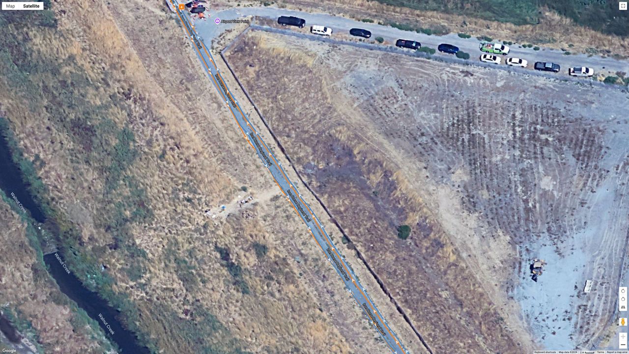

Thankfully, the Vantage M3 has fewer gaffes than Suunto and does perfectly well in normal conditions, sticking to the correct side of my local trail. And for my track run below, it didn't stick perfectly to the first lane, but that's something every watch I've tested struggles with; Polar's result is actually among the best I've seen among dual-band watches.

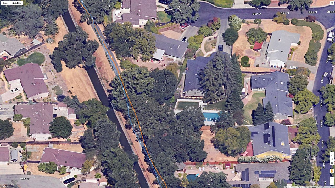

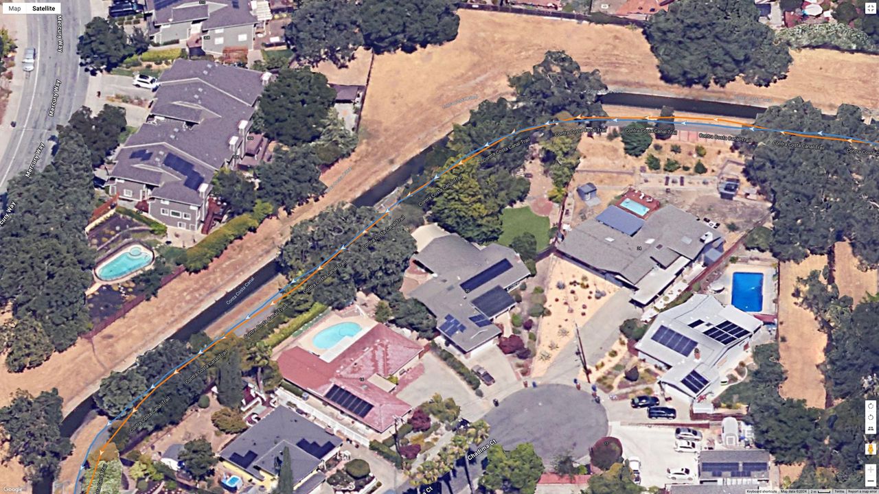

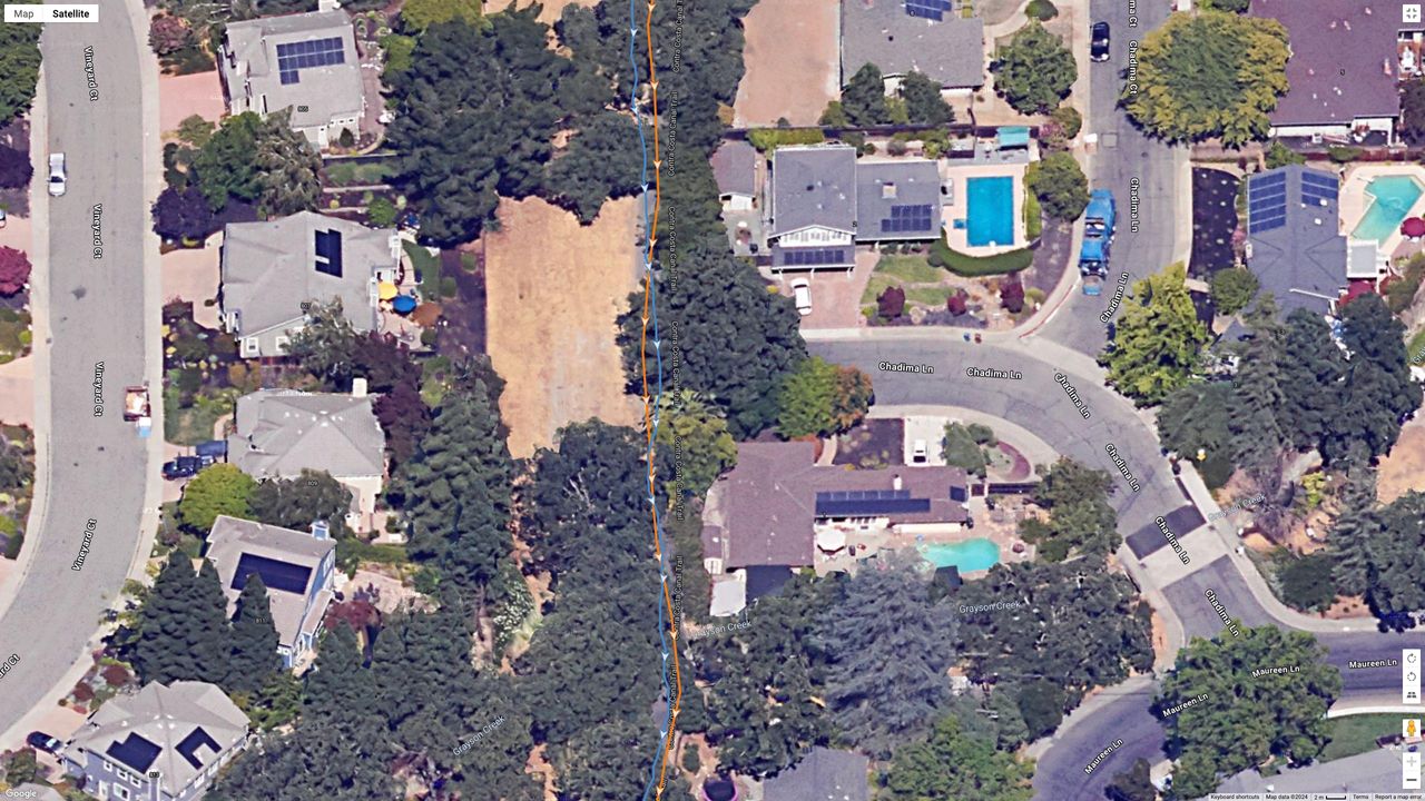

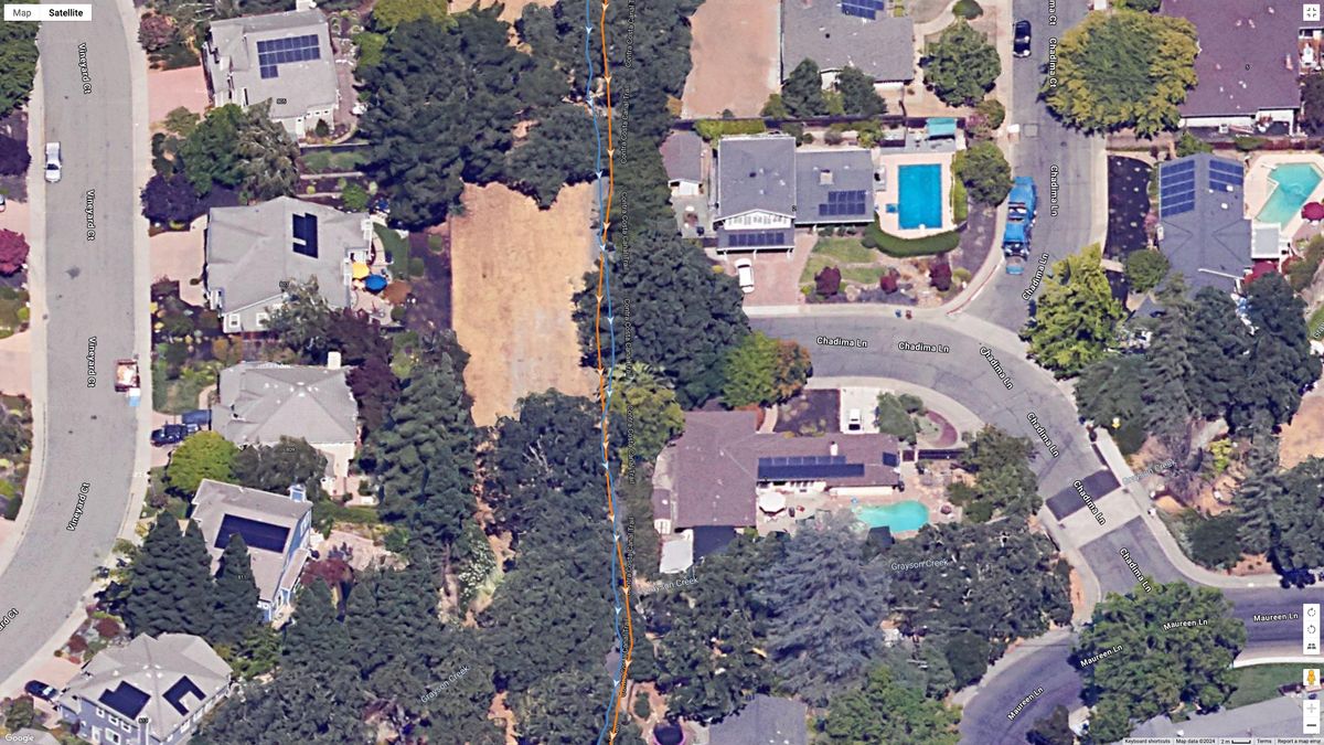

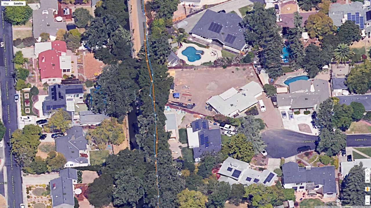

While I couldn't do a proper hike, my walk along another nearby trail was illuminating. In the screenshots below, you'll see how the Vantage M3 (now the blue line) does perfectly well on the unimpeded stretches, but under tree cover, you'll see a lot more wavering in short stretches where I was walking straight ahead (and Garmin's orange line is usually more consistent). My total distance was only two-hundredths apart, though, so most people won't mind.

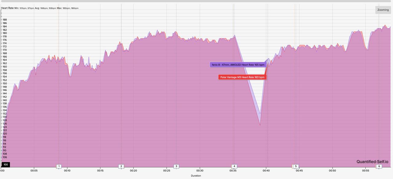

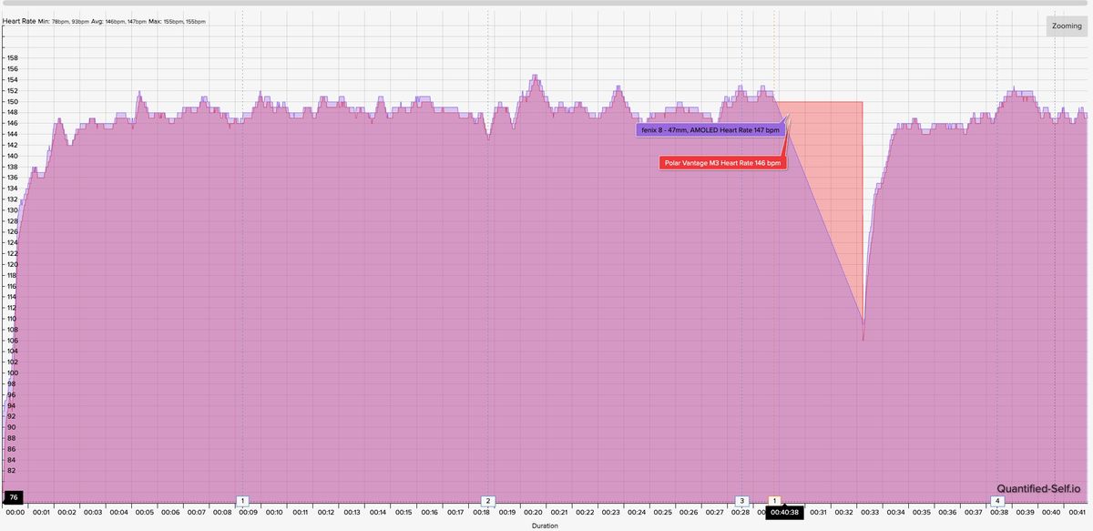

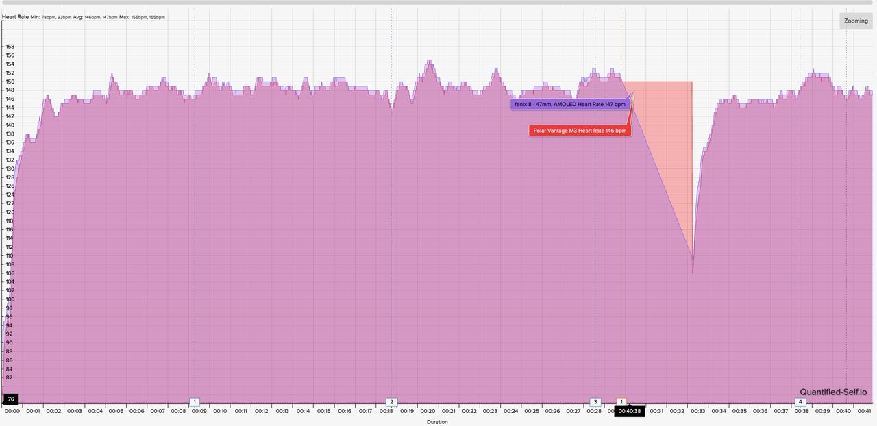

For every run except one two-mile jog, the Polar Vantage M3 was 1 bpm short of my optical arm band or my Polar ECG. In the two HR graphs below (hit the magnification button), you can see how the purple Garmin graph sits slightly above the pinker Polar one at most points, aside from when my effort dips and Polar is slower to drop.
View Original
View Original
There's normally a delay between wrist- and arm-based optical monitors or chest straps, but a solid fitness watch should still average out to the same result in the end. I'd like to see Polar figure out its algorithm to close the small gap, but 1 bpm isn't a major issue and it's still in the right ballpark.

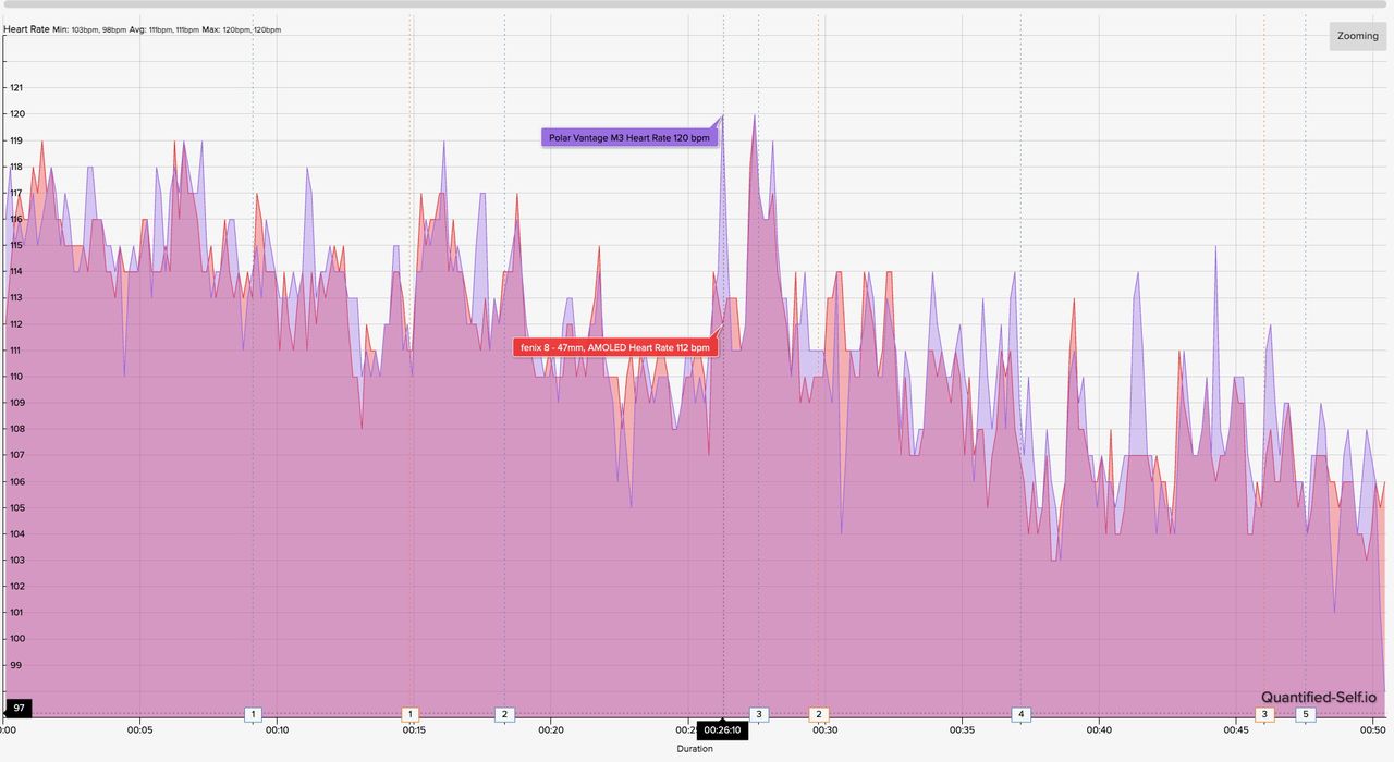

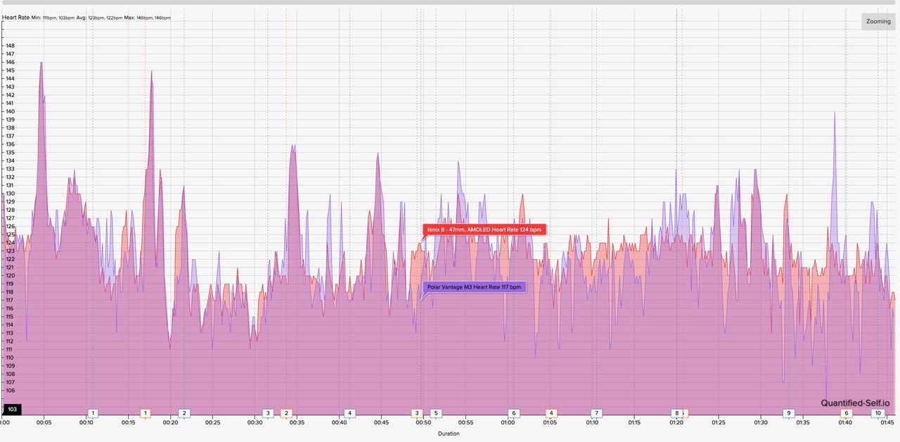

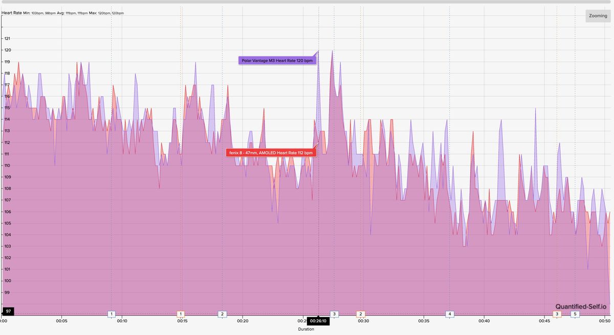

What's slightly weirder is looking at my two walking activity charts. Polar really struggled to stay close to my fluctuating heart rate for both activities, with a 5–10 bpm gap above or below my actual HR for sustained stretches.
View Original
View Original
They ended up averaging out to identical or close bpm averages for 6- and 4-mile walks; so again, perhaps you won't care about the difference. But that may have been luck more than everything else; I noticed this 5Krunner HR accuracy test did fine for most runs but had bizarrely inflated HR totals for a calm walk. So I'm hoping this is an area where the Polar algorithm can improve with time.
