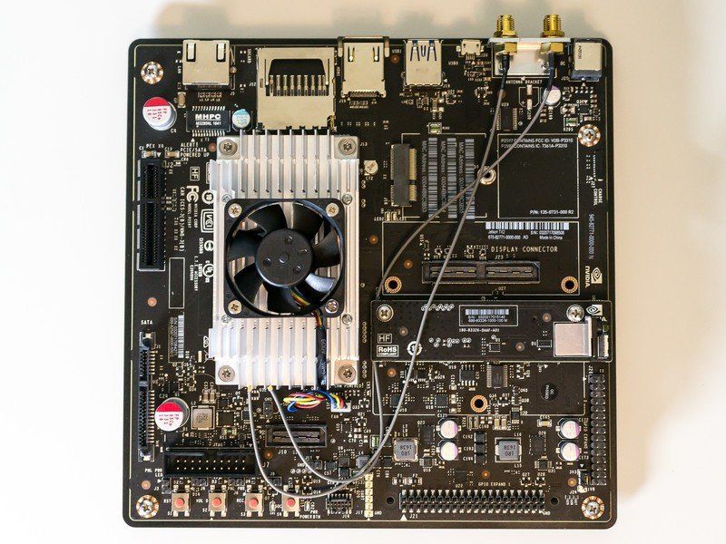

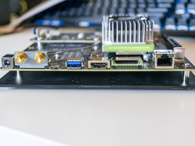

The Jetson TX2 is a development tool. The Jetson TX2 is also a field-ready module to power any AI-based equipment. It's a computer the size of a credit card with all the inputs and outputs a "regular" computer has. When you plug the TX2 module into its specially designed backboard (that's part of the development kit) it mostly turns into a typical small form factor PC complete with all the ports and plugs your desktop also has.
Developers can use this to build equipment around and actually use the Jetson itself to run demos and simulations. It's a capable little machine that can do all the calculations something much bigger can do while using a minuscule amount of power to do so. The tech specs are impressive.

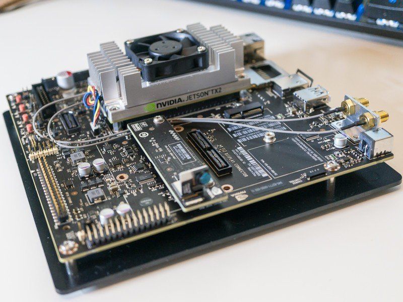

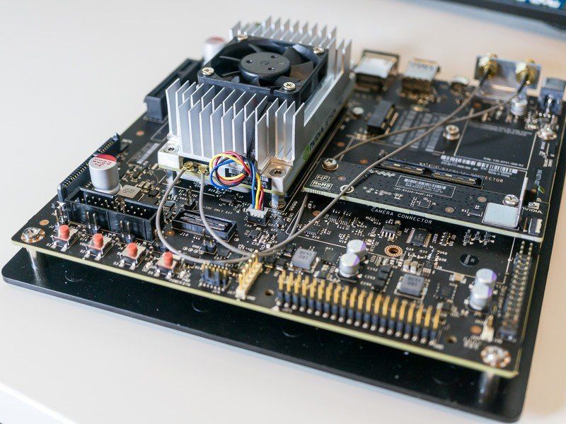

The credit card sized compute module can plug into a complete carrier board available as part of the Jetson TX2 development kit. The carrier board uses the 400 I/O pins on the Jetson module to provide standard desktop connections. A software developer can use a standard USB keyboard and mouse, a standard monitor and the Jetson TX2 to create a complete development environment.
Running on an Ubuntu 16.04 based Linux4Tegra operating system, all the tools you might need to develop and debug deep learning AI applications are included as part of NVIDIA's JetPack software. Developers can download the package from NVIDIA's Developer Zone as well as follow tutorials and community knowledge to see what the Jetson can do then begin work on their own ideas. Included software in the JetPack is pre-configured to run optimized on the TX2 processing system:
